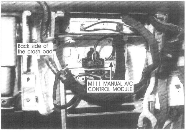

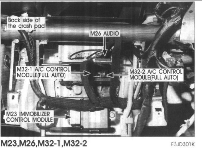

My lights are not changing when I turn on the Ac to the cold air. It only blows out fan air not cold. The lights are showing that it is on cold air not the fan which is running.
Monday, May 6th, 2019 AT 6:59 PM (Merged)
DAVE H
  • 13,384 POSTS
It sounds like the control unit for the air conditioner is not working. Here is a diagram to help you change the unit out.
Cheers
PDT1973
Thank you so much I was the module in my car I just wanted others to know. It cost me $150.00 for a used one I installed it myself. :)
