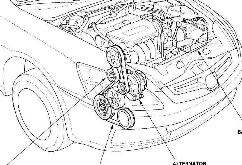

Serpentine belt burned off and the water pump pulley froze up
163,000 MILES • 2.4L • 4 CYL • AUTOMATIC
STARLETTE
I want to know what I have to do to get it fixed.
Feb 15, 2020 at 4:47 AM
Good afternoon,
The water pump needs to be replaced.

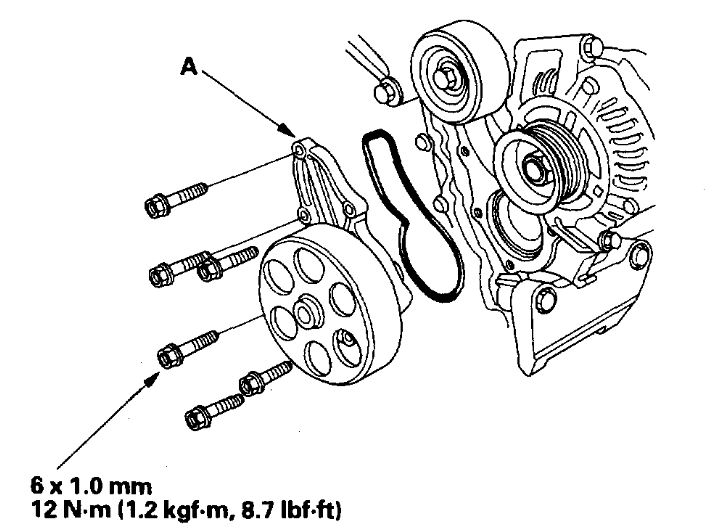

https://www.2carpros.com/articles/water-pump-replacement

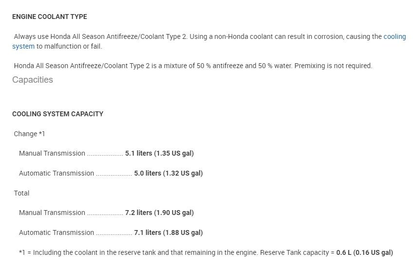

Water Pump Replacement
1. Remove the drive belt.
2. Drain the engine coolant.
3. Remove the drive belt auto-tensioner.
4. Remove the six bolts securing the water pump, then remove the water pump (A).
5. Inspect and clean the O-ring groove and mating surface with the water passage.
6. Install the water pump with new O-rings in the reverse order of removal.
7. Clean up any spilled engine coolant.
8. Install the drive belt auto-tensioner.
9. Refill the radiator with engine coolant, and bleed air from the cooling system with the heater valve open.
