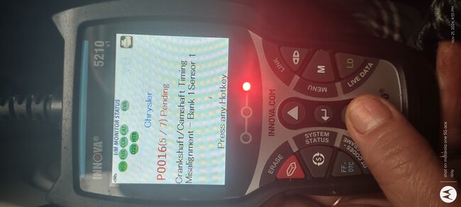

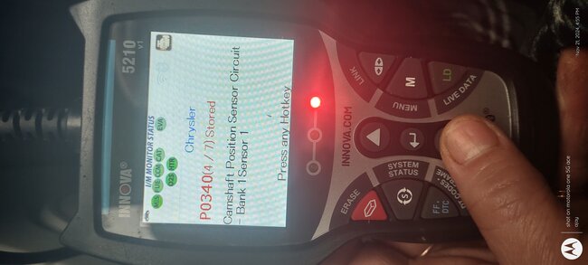

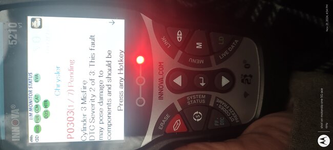

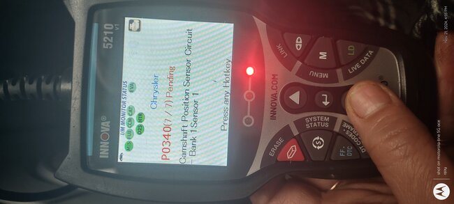

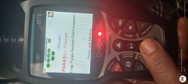

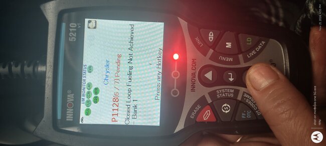

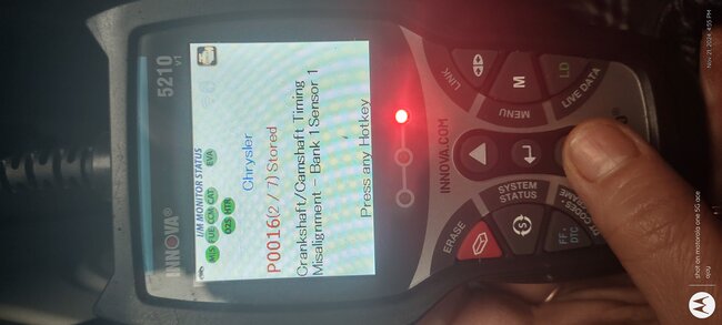

I hooked this up to it and these are the codes I got, but I don't know what any of it means. Please help.
Nov 21, 2024 at 2:13 PM
STEVE W.
  • 15,200 POSTS
Some of those point to a timing issue but there are others that point toward fuel. It's possible you got hit with two problems at once. The engine started misfiring due to a lean condition and the shocks through the crankshaft caused a timing belt failure that broke when the vehicle was being started. I would look at the cams first. If it is a failed belt, then I would suggest based on that and the mileage that either a lower mileage used or a remanufactured engine might be better than just replacing the belt.
