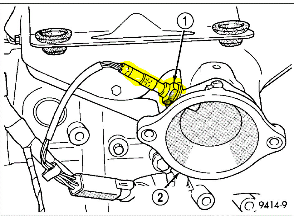

Code p0164, power loss, will not accelerate over 20 MPH and bogs
2006 CHRYSLER PT CRUISER
100,000 MILES • 4 CYL • AUTOMATIC
JASMINE COOK
Before assuming the worst, could my problem possibly just be a bad connection?
I just changed my spark plugs, and hoses. Maybe it messed with a sensor?
Car won't accelerate over 20 MPH, stalls, bogs, loses power when downshifting and RPMs won't go over 1 1/2..
Tried cleaning out CAT.
Again could it do with a bad connection in TIPM, considering I changed it a few months back, and noticed a possible loose connection.. there's also a relay with bolt holding it in, is this the possible cause? Only code is a cell sensor p0164.

The P0164 is related to a high voltage signal from a third oxygen sensor which this vehicle doesn't have. You didn't indicate turbo, so I am looking through the info for a 2.4L non-turbo.
Did the problem just start after the plugs were replaced? Also, if you remove the oxygen sensor on the exhaust manifold (see pic 1), does the vehicle run any better? If it doesn't, then chances are it isn't a plugged converter.
The code you provided really isn't relevant for this vehicle, so I'm not sure why it's showing. Let me know if this existed before the plugs. If it did, I need you to check fuel pressure. It could be low.

It wasn't nearly as bad before i changed the spark plugs..
*I hooked up a fancy code reader to it and this is what popped up.. P1604 x2, P0032 x2, U0101
I haven't tried taking off exhaust manifold yet, or testing fuel pressure but will try first thing in morning... just thought I'd update you with the codes..

Based on the codes, it does seem the PCM is bad. The P1604 indicates an internal fault within the PCM. The U0101 indicates no communication with the PCM. The P0032 is related to an oxygen sensor which doesn't seem as though that is the main concern at this time.
As far as getting a PCM from another vehicle, it can't just be plugged in and work. It will need to be programmed for your vehicle. Also, it will need to be one having the same part number. Programing will likely need to be done by a dealership having the proper software to do it.

You could try having yours reprogrammed, but if there is an internal fault, it won't help. Just for the heck of it, let's try a hard reset.
Disconnect both terminals on the battery. Next, take a zip-tie and join the two cables together and let it sit like that for about 30 minutes. That will drain any capacitors as well. Then reconnect it and see if there is any change.
