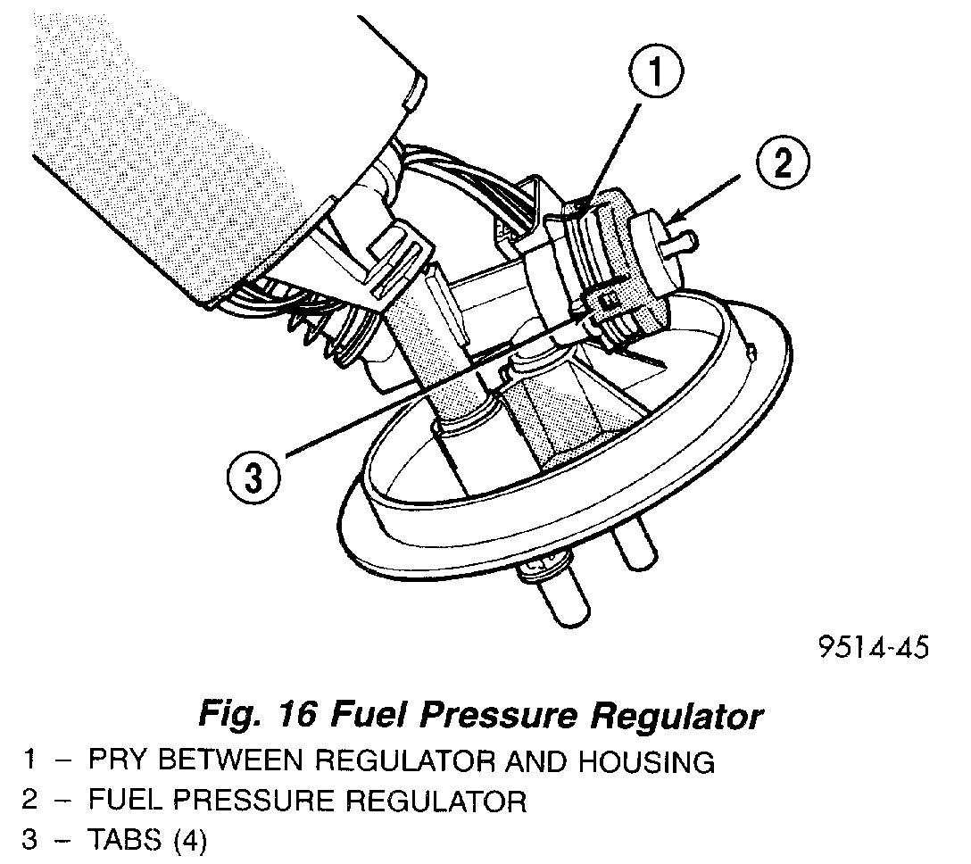

There are several things that it could be, but if it cranks normally we can take the starter out of the equation. If there is a black plume of smoke out of the tailpipe when it does start, then it could be a fuel injector bleeding down fuel into the engine when the engine is off. Another common cause is a fuel pump that does not hold pressure, which can be verified with a fuel pressure test. Sometimes you can cycle the key to the on position several times (usually 2 or 3) before you actually crank the engine, if it fires right up, a fuel pressure loss is verified! Most common cause for this is the fuel pressure regulator on the in tank fuel pump. If you are replacing this you might as well replace the whole pump if it is original to the vehicle. I've attached a picture of the pump with the regulator. here is also a repair guide that explains the fuel pressure:
test:https://www.2carpros.com/articles/how-to-check-fuel-system-pressure-and-regulator

Update: work will start on my van Monday, it was definitely the fuel pump. The mechanic said that the pump on my van should be at 52 lbs of pressure, but it was only at 32lbs. It's going to only cost me $350.00 total, that is labor and parts, said they could have it done as soon as Tuesday morning if there's no rust on bolts. Which they looked under the van and said there was hardly any rust at all.
