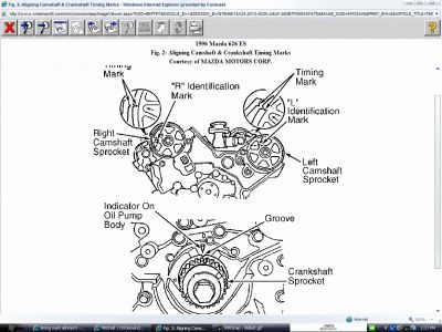

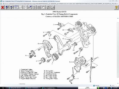

i need the timeing aliment mark set up for mazda 626 96 was replacing water pump and belt sliped when i moved the hamonic pully
Oct 9, 2007 at 5:27 AM
MERLIN2021
  • 17,250 POSTS
This is for 96 2.5? You didn't say...If you remove the cam gears be carful not to damage the CPS rotor behind it!
https://images.2carpros.com/forum/automotive_pictures/62217_96Belt_1.jpg
https://images.2carpros.com/forum/automotive_pictures/62217_Marks_1.jpg
https://images.2carpros.com/forum/automotive_pictures/62217_30961_mitchell_2_49.jpg
