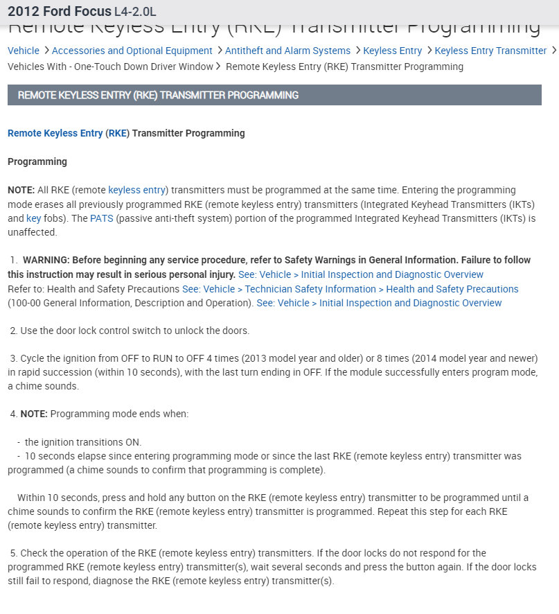

My key was recently stolen, and I bought a used ignition switch that included a key and immobilizer, how can I program the key without going to Ford?
Jan 21, 2022 at 1:32 AM
SQM
  • 6,383 POSTS

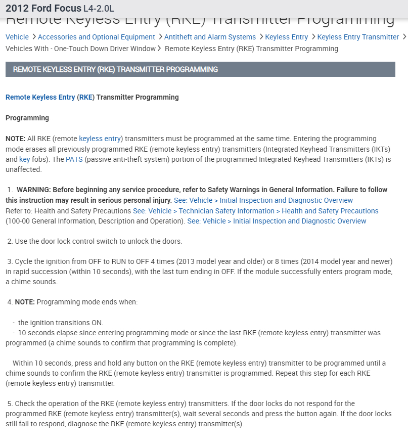

A new key or fob can be programmed, if you have an existing key/fob that works properly.
If you do not have any key or fob. Then the programming needs to be done by a dealer or a qualified locksmith. As it will need a special tool.
Here is a helpful guide:
https://www.2carpros.com/articles/how-to-re-program-a-key-remote-fob
I have also attached the programming steps below.
If this method fails, you will likely have to make the trip to the dealer.
