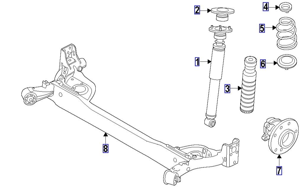

They looked and said it was wheel bearing and they said axle had to be replaced in back, but it doesn’t make sense.

Did they say what was bad about the axle? There are multiple things that are possible but on an 18 I would be suspicious that it needs replacement unless it was bent or cracked. Oh if you wanted to look for the new part it is part number 55501-9VB1B looks like it has already been updated a few times, so it might not be a bad idea to contact Nissan corporate and talk to them if the local dealer insists it be replaced but doesn't give you a good reason. From the looks there are only the two bushings in it to go bad.

Is there any instructions on replacing the whole thing? it looks a lot different then other style axles.

I would find out what they claim the problem is. The only part that isn't easily replaced is the axle beam itself. Everything else is a bolt on part like the hubs, brakes and suspension. If the issue is something like a bad strut or bad springs then they are replaceable as individual parts. The beam itself is replaceable but unless it's damaged in some way I cannot think of a reason to replace it so I would try to find out what is actually wrong. For instance say they want to replace it because it is bent on one end or in the middle. Do you have any strange tire wear on the tires from that end? That might give a clue to a problem.

As far as replacing it, the manual parts are not really hard but the factory data assumes you are replacing the entire rear axle as an assembly with new hubs, brakes and all of that attached. In your case I would try to reuse all of that if possible which is why you need to know what is wrong. Wouldn't help you to replace the axle beam if the problem is really something else.
1. Remove the reservoir cap from the reservoir tank.
2. Remove the rear wheels and tires.
3. Loosen the flare nuts on the brake lines,
4. Remove the rear drum brake assembly.
5. Separate the parking brake cable (RH/LH) from the rear suspension beam and position the rear drum brake back plate (RH/LH) aside with wire. Refer to Exploded View.
6. Separate the brake hose (RH/LH) and the brake tube (RH/LH) from the rear suspension beam. Refer to .Exploded View.
7. Disconnect the harness connector from the wheel sensor (RH/LH). Refer to Exploded View.
8. Position a suitable jack under rear suspension beam.
Place the jack in the center of the suspension beam.
Do not damage the suspension beam with jack.
9. Separate the shock absorber (RH/LH) from the rear suspension beam and remove the coil spring (RH/LH).
Make sure the rear suspension beam is stable when using the jack.
10. Remove the rear suspension beam bolts.
11. Slowly lower jack, remove rear suspension beam from vehicle.
Aug 14, 2020 at 5:23 PM
STEVE W.
  • 15,200 POSTS
How do you mean different axle? You said the back axle, that is the rear beam suspension for a two wheel drive Kicks which was the only one sold in the US. I don't see any of the Kicks sold elsewhere which have a rear differential either.
