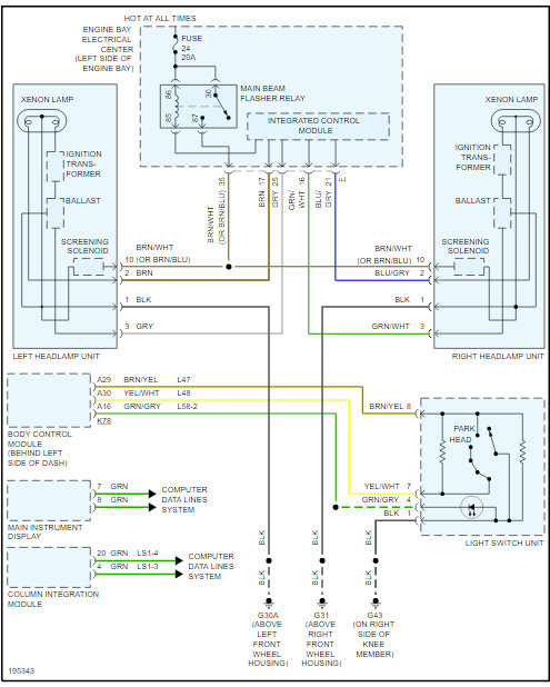

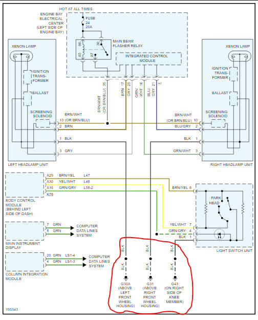

It sounds like you may be having a problem with a headlight ground.. Here is a tutorial for you to view about checking wiring:
You might want to check the ground connection for looseness/melted/frayed/corroded connection. I've attached a picture below of your vehicles wiring diagram with headlight grounds circled in red.Hope this helps and thanks for using 2CarPros.

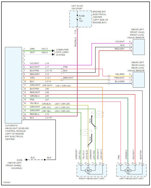

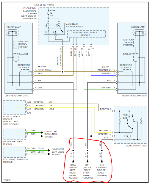

I've attached the headlight diagram again but I've also added another for the headlight leveling circuit.Having the DRL's disconnected might have caused the problem as well.Hope this helps and thanks again for using 2CarPros.
