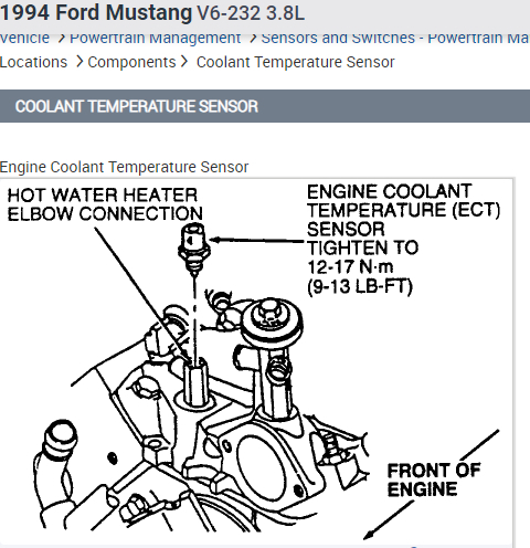

Make sure you do not have any type gunk built-up around where the sensor goes in. Just in case any restriction blocking coolant to reach the sensor.

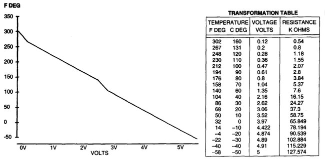

Seems likely that could do it.. after playing around with the multimeter on sensor with car running, sensor will just drop down to like 1.33-1.77 volts after hitting half indicating 104-170 degrees about then it with flat line and ever so slowly continue dropping closer to that .35-.60 volts required to trigger the fans. not sure what would block it there’s coolant under the sensor.
I’ll update if that does any thing.
Jul 18, 2021 at 10:42 PM
SQM
  • 6,383 POSTS
I have attached the temperature chart for your reference.
Keep me posted.

I noticed it has been a couple of days since you have been contacted. Has any progress been made? As far as 12v, you won't get that to the sensor. It receives a 5-volt reference. You shouldn't see more than that amount of voltage.
Now, the changing coolant temperature affects the voltage drop across the sensor terminals, providing electrical signals to the PCM. As the temperature increases, the resistance decreases. Once a predetermined voltage is received by the PCM, the cooling fans should turn on.
I read through the posts and recognize that when you heated the sensor, the fans turned on. What was used to heat it? Also, the idea that the fan turned on leads be to believe the system is working, but the sensor isn't working properly. If you heated it with something like a torch, you got it hotter than the coolant should. Also, I can't tell you how often online parts fail or just don't work properly.
Let us know if progress has been made. Also, you may want to try a different sensor.

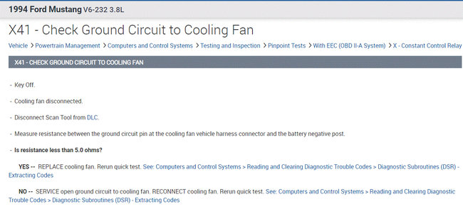

  • 110,240 POSTS
Do me a favor. Check the gound circuit. See the diagnostics below. It's a simple test.
Let me know what you find.
