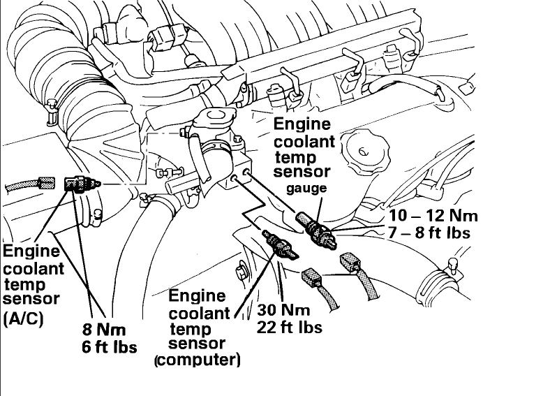

Hello, every day after I check all fluids of my car I turn the key to start the car and it takes about to twenty to thirty tries to start, and when it starts the car is all shaky. I have pint pointed the issue to the engine coils, one of then is not working which makes two of my cylinders not to work, but then the car warms up they are all working correctly, and the car runs very smooth.
what can this issue be related?
I have already changed that coil thinking that that was the issue, but the issue remains. cleaned the injectors and replaced the spark plugs, also changed the fuel pump and the issue remains.
Am I missing something?

Yes, this sounds like a classic engine coolant temperature that is not working right. I would test the resistance compared to a new sensor cold and see what the difference is.
Here is a guide on how to use a voltmeter:
This guide will give you an idea of what you are in for when changing it.
https://www.2carpros.com/articles/coolant-temperature-sensor-cts-replacement
Here is what it will be like on your car:

Test has been made and I can confirm that there's one bad sensor, I have 3 sensors there.
1*- Engine Coolant Temp Sensor (computer) is working fine.
2*- Engine Coolant Temp Sensor (A/C) Bad, Not working.
3*- Engine Coolant Temp Sensor (Gauge) is working fine.
Now my question is why this sensor that has nothing to do with my engine coils is not letting 1 of my coils to start up at cold?
PS: I can't find this sensor anywhere in my city (Valencia, Venezuela) can this sensor be replaced with one from another mitsubishi? if so can you please give me an example.

It can be taking from another car of the same make and around the same year should be fine. Usually if they plug in it will work. The plugs are shaped differently for different sensors.
