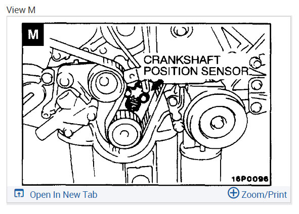

car died while driving, now it won't start. it is getting gas but no spark?

check fuses under hood fuse box and scan for codes.
Mar 11, 2015 at 12:50 AM
  • 55,711 POSTS

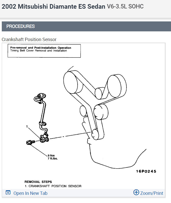

This is common when the crankshaft angle sensor goes out, here is how to replace it and its location as well. Check out the images (below). Let us know if you need anything else.
