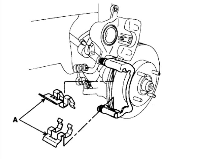

This is normally caused by your brake fluid getting low. This could be either due to the pads getting worn out and it needs more brake fluid to extend them so it trip the fluid level sensor or there could be an actual issues. Either way, we need to check the brakes and make sure there are no leaks.
Basically we just need to remove the front and rear wheel and inspect the brakes. Once we know what they measure thickness wise and if there are any leaks then we can go from there.

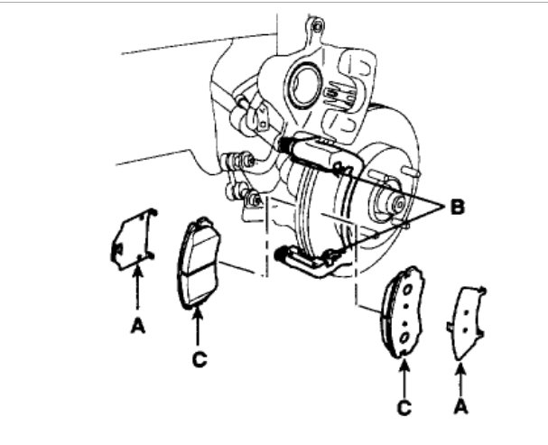

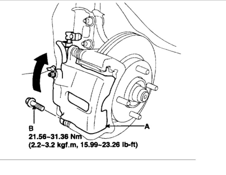

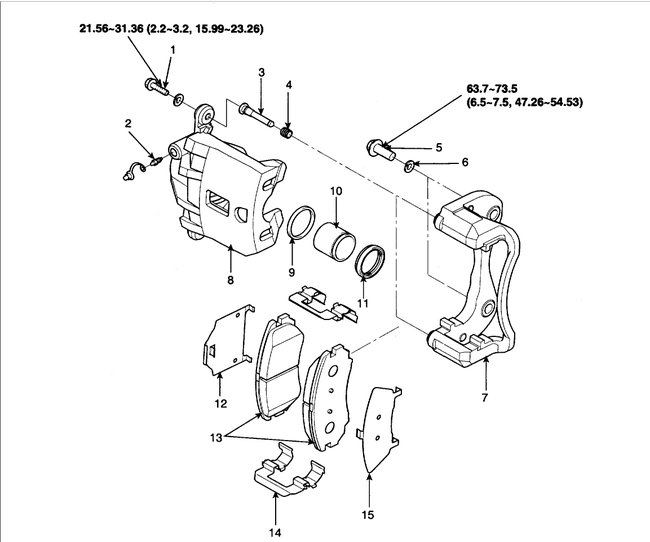

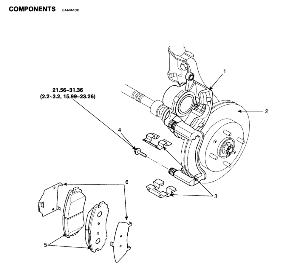

It sounds like for the brake light is the front pads are worn down and it lowers the brake fluid in the reservoir causing the brake warning light to come on.
Here is a video and guide that will show you what you are in for when doing the front brakes:
