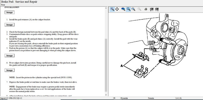

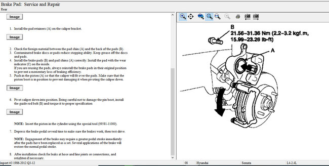

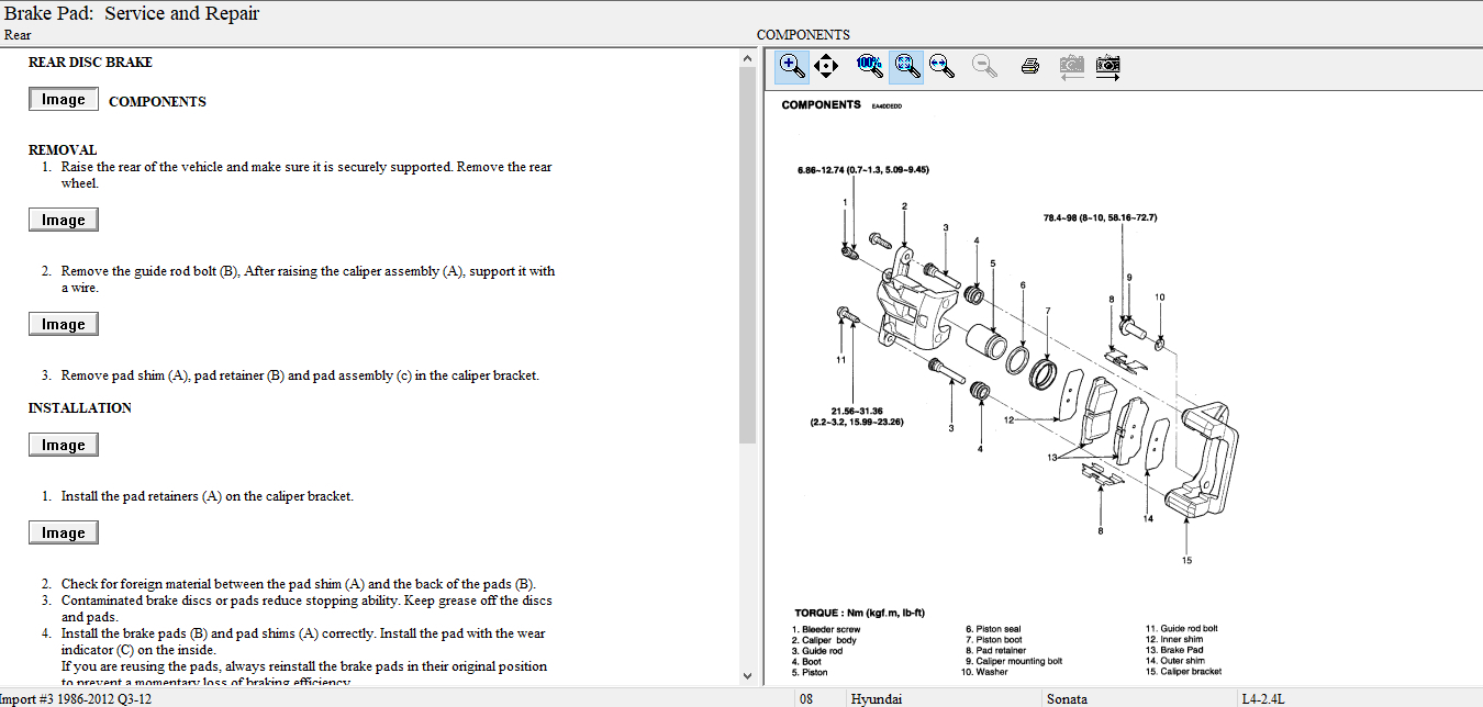

The brake warning light on my dash came on and i carried it to the shop and they check the tires and found that one of the tpms sensors was broken. The sensor was replaced but the light is still on they say me brakes are bad.
Aug 31, 2009 at 11:46 AM
SEVAG P
  • 405 POSTS
hello,

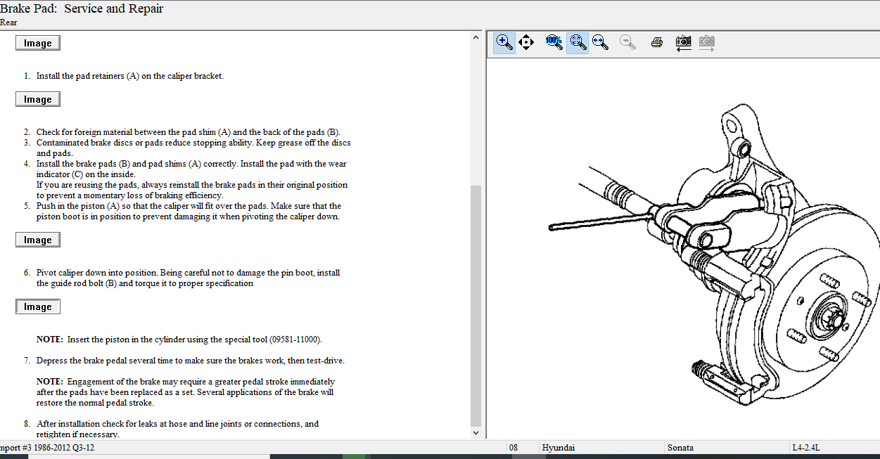

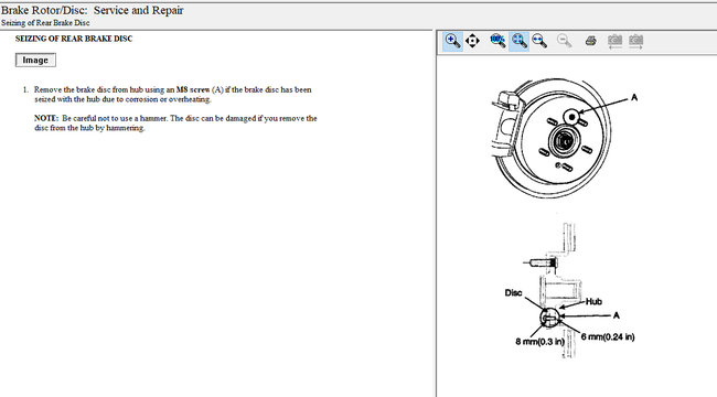

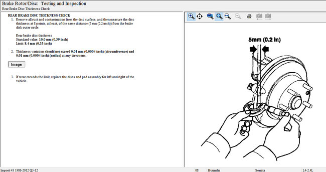

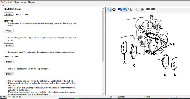

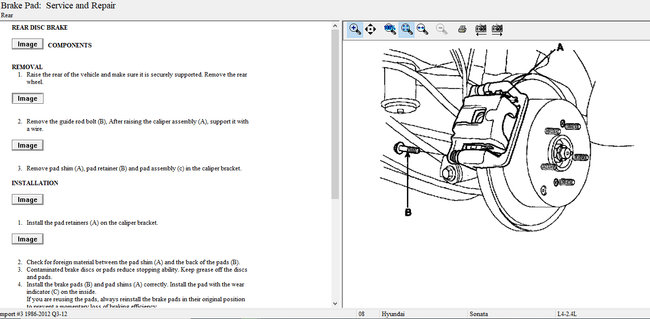

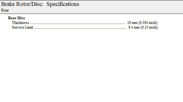

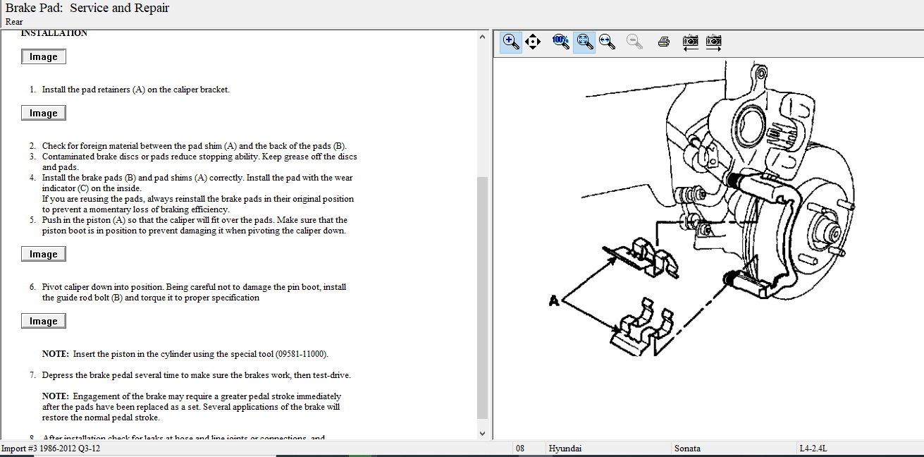

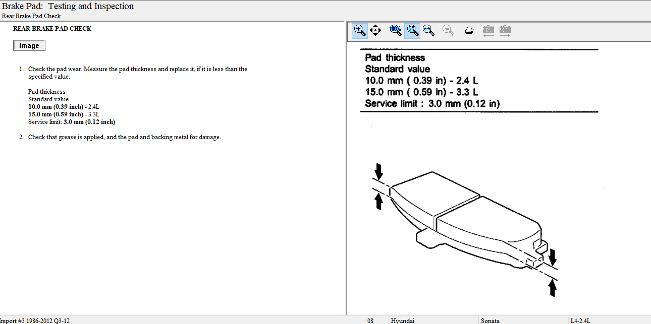

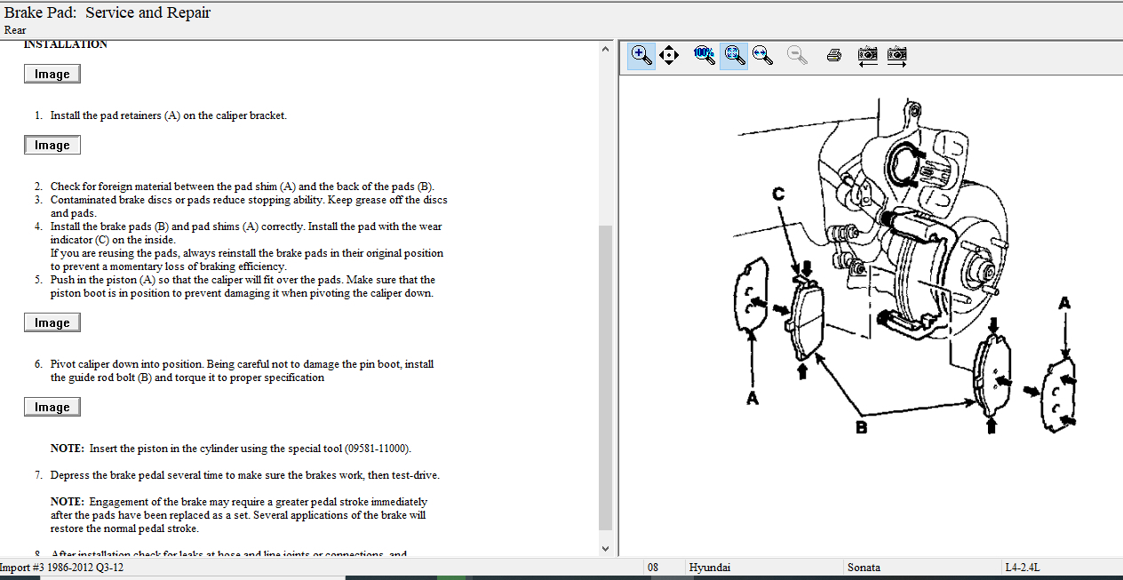

It sound like brake pads are at minimum value remove front and rear pads check the thickness of the pads you can detect it if the sensor is touching the disc surface that means pads must be replaced.
check our links below how to replace rear pads and rotors,
https://www.2carpros.com/articles/how-to-replace-rear-brake-pads-and-rotors
https://youtu.be/G5M_xKIxUb4

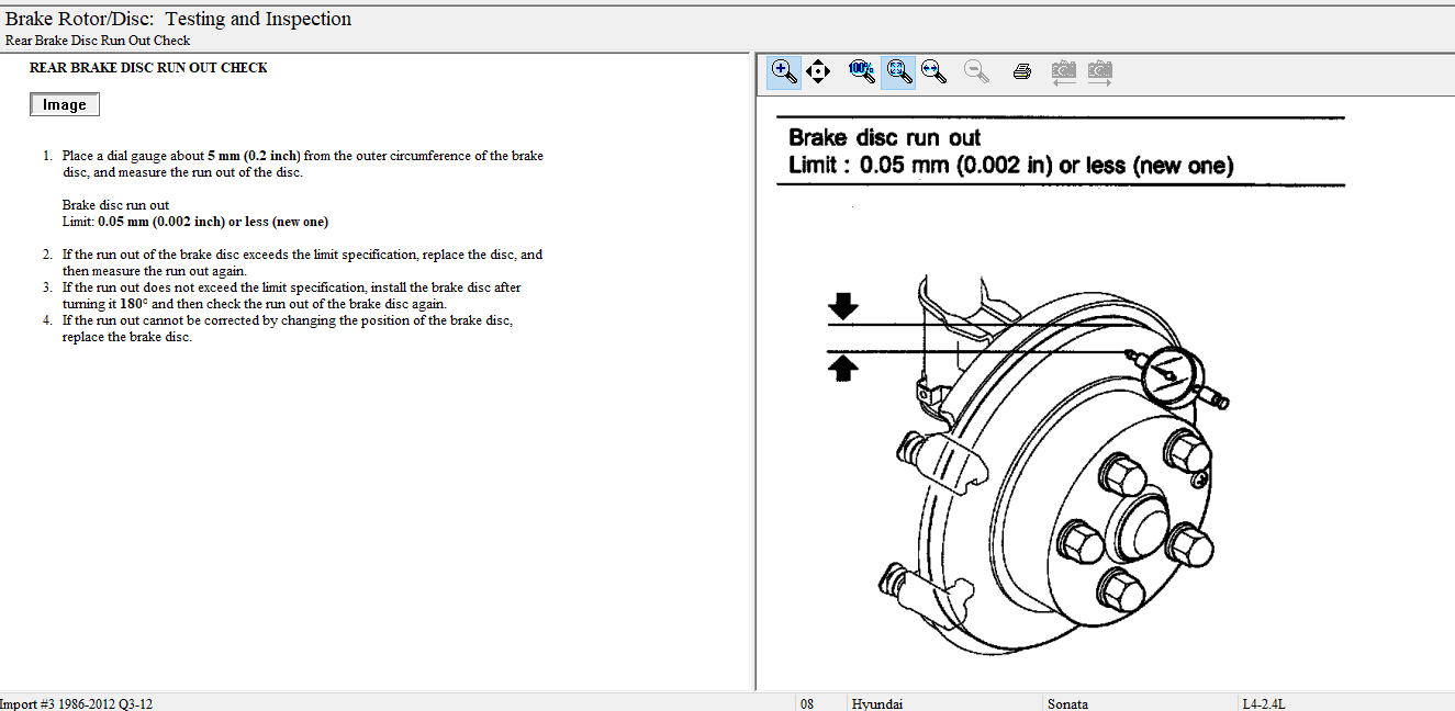

Check the diagrams below procedure how to replace rear pads and rotors, and check how to test them.
hope these helps.
