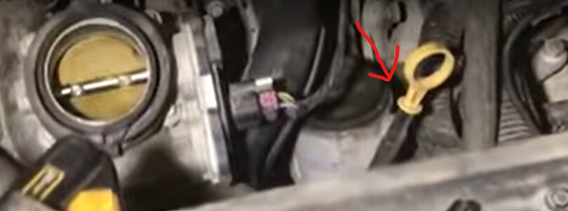

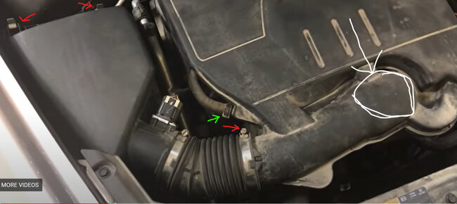

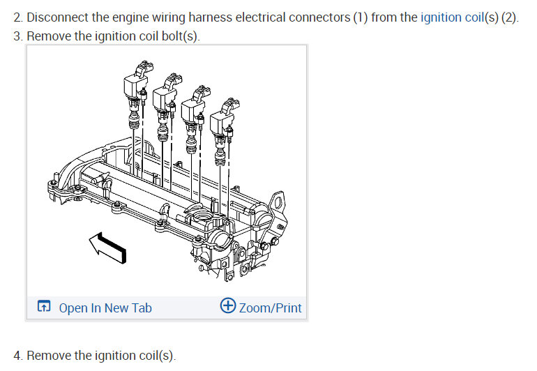

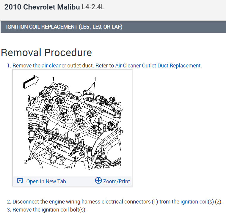

Putting the engine cover back on after working on these engines can be a real hassle. I have included a picture of the throttle body. It has a rubber gasket on it that is like a u-shape. This gasket will almost always roll in on itself and cause an air leak. If it did this, it will have a leak in the intake and extra air will be entering the engine. Since it is after the Mass Air Flow Sensor, this extra or unmeasured air enters the engine, and the engine's computer will try compensation for it by adding fuel. Normally you would have a check engine light but not always.
Since the hesitation seemed to get worse after the plugs, this could be causing part of the issue.

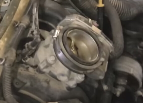

I would remove the filter box cover and loosen the clamp with the (red arrows). Then pull it off as an assembly and just set aside. Don't unplug the wire connected just place it on the fender area.
Then take a pair of pliers and pinch the clamp and slide down the hose. Then slide of hose to the engine cover (green arrow).
Then loosen the clamp underneath the engine cover and pull up to remove the cover. Loosen the clamp as far as you can so the seal isn't damaged when removing the cover. This clamp may be best accessed from the front.
Now put a little oil on your finger and put it around the opening on the engine cover and a little on the gasket on the throttle body. Then push it down and make sure it is seated properly. You are going to want to push on the bottom center of the engine cover where there is a circle (white arrow) while tightening the clamp. Then you can put the other hoses on.
I would use an 8mm socket 1/4 inch drive with a 1/4 inch extension and a quarter inch ratchet. You can use a screwdriver, but you will want to make sure it is tight so a socket with an extension and ratchet is best. Keep in mind though it is plastic.
Then reattach the rest of the intake in the reverse of removal.

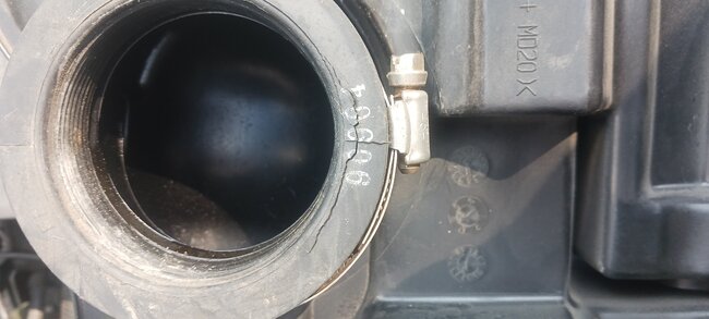

I just took the engine cover off, turned it over and saw that the rubber thing that's on the underside of the cover is cracked as you should be able to see in the picture. Also, I don't know if this is major but the clamp around it wasn't tight as you can also see on the right, right where the crack is. If I need a new one, exactly what is this called?
Jul 6, 2023 at 6:30 AM
BRENDON S
  • 653 POSTS
Hello ALLISON BROCKMAN,
Nope it is right against the passenger side fender. It is a rectangular box with a few metal clips on it - see the image attached below, I marked the clips with red arrows.
You are going to push on these outwards and they will release the cover to the air filter. A flathead screwdriver will help in popping them off. This whole assembly is the air filter housing.
This is attached to a hose that goes to the engine cover.
Once the clips are removed, the cover will be free. Then loosen the clamp at the end of the rubber hose marked with red arrow (see image). Then slide the hose off the engine cover.
Now you should have the rubber intake tube connected to the air filter housing cover and just take it and move it aside.
The wire that is attached is for the Mass Air Flow Sensor. Just leave that plugged in but be careful not to pull on the wire. You only need to move this, so it isn't in the way when you are trying to set the engine cover.

Yes, I figured all that out. I think you missed what I edited my message too.

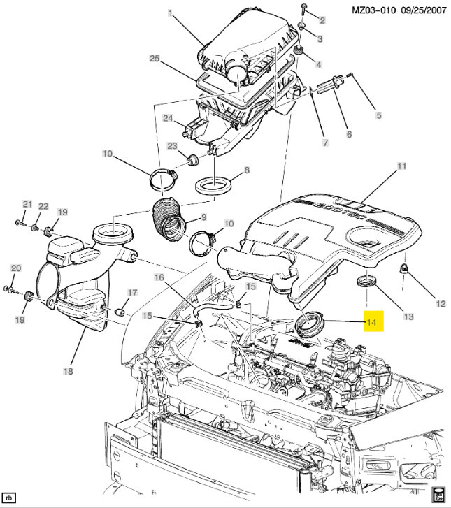

Nice find! Yes, I would replace that.
GM calls it an Air Cleaner Outlet Duct Clamp. I don't have a part number for you, but I do have a picture from the catalog.
If you go to the GM dealer and show them the picture and your VIN and ask for a price quote. They will give you a copy of the quote. You can either get the part from them or take the quote home and search online for it.
It's number 14 in the picture.

You are very welcome. Yes, I think it could cause the problems you are having. Since the air is entering the engine but not being measured, this brings in what is called "Unmetered-Air". The oxygen sensors will see the extra oxygen and add fuel to the engine, causing a hesitation. Also, poor acceleration, hard starting, rough idle, and more.
You could have a couple things going on. So, we need to get it sealed up and see how it does.

I found out that I would have to purchase the whole engine cover, not just that piece. New, that would be over $500. I've been looking around in junkyards, but no luck so far. I would like to know if that is the cause of the issue, is it bad for my engine for me to be driving it like that?

We just did the test with carb cleaner. My son sprayed and listened to the engine while I sat in the car and watched the RPMs, just to double check. He never heard a difference with the engine. He sprayed twice. The first time, I saw the RPMs go up a couple of times so slightly I wasn't even sure if it was worth mentioning, but obviously, I am. It was kind of like when you're sitting at a light and the RPMs go up and down very little, so I don't know if this is normal, but that's how I took it when I saw it. The second time he sprayed, there was no change.
I wanted to make sure that he was spraying in the right area because I didn't know whether you had to spray in the exact place where the crack is or not, so I took the engine cover off. Where he was actually spraying was in the front and on the right side (with cover on). The main crack is in the back. I don't know if that makes a difference. But if he does need to get it in the exact spot, we can't reach the back. What I did notice is that there was liquid in the front, inside that rubber piece, opposite from where the crack is. I first thought it was the liquid that he sprayed until I rubbed it with my finger, and it was brown.

Unfortunately, it is not normal for the RPM to fluctuate. You may have a misfire, or the engine might be trying to correct something like a lean condition. You do have a massive crack in something that is supposed to seal the air coming into your engine. It may not be the main cause but certainly isn't helping anything. Even the smallest air leak can cause a problem.
However, because it is expensive and I completely understand, let's just keep it in mind and look at some other things. We will keep that on the back burner for now.
Thank you for doing the tests though, regardless of the outcome. I appreciate it.
Now the brown stuff is more than likely oil. Oil in the intake can be cause by excessive crankcase pressure. This pressure is created by something called blow-by gasses, which just happens as the engine runs. The amount depends on how hard the engine is working or load, rpm and things like age and mileage.
There is a system called Positive Crankcase Ventilation or PCV. This system uses vacuum that the engine produces as the engine operates and sucks these gases out, into the intake and then burns them as part of the normal combustion process. Sometimes this system will have an issue and cause it not to work correctly. This in turn increases crankcase pressure, the bottom of the motor basically. This will push gaskets out of the engine causing oil leaks but can also push it into the intake and cause it to be burned. This condition will cause a misfire and a lot of other issues.
Since you seem to be losing oil and you found some in the intake, I think checking this system is a good next step.
If could look around the engine with a bright light and not any wet oil on the motor that would be great.
We need to figure out if it is burning oil. If so, we need to find out why.
Please look around and take some photos if you can for me.
The PCV system is usually cheap to fix but if not taken care of can cause a lot of costly problems.

When it comes to what the RPMs did, it happened right after I started the car and I believe every car I've had did the same thing. The RPMs would go up and down a couple of times ever so slightly and then stay steady.
The amount of oil that was on the rubber was not much at all. It was only in one spot and maybe the size of a nickel. That's why I thought maybe it was from the carb cleaner. The rest of the rubber was totally dry.
Now, am I just looking for any wet spots on the engine? I'll wait a little after my son gets home from work to let the engine cool down some.
Aug 28, 2023 at 6:18 AM
ALLISON BROCKMAN
  • 19 POSTS
There was hardly any more stuttering after I finally found another seal for the air intake. It decreased by about 95%. I recently realized it's been happening again, and the only difference is that I'm using the A/C. I would like to test it without the A/C on, but it's been so hot I don't dare. If it lands up going back to normal without the A/C on, any ideas what it could be?

To me it sounds like one of the spark plugs is cracked or you have an ignition coil that is going bad. When you did the tune up did you replace the ignition coils? These go out often and should be replaced. Also, remove the spark plugs and check for cracks. Check out the images (below). Please upload pictures or videos in your response of any problems so we can see what to help you with.
