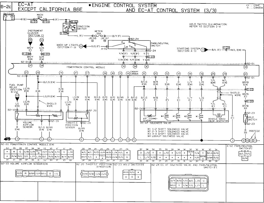

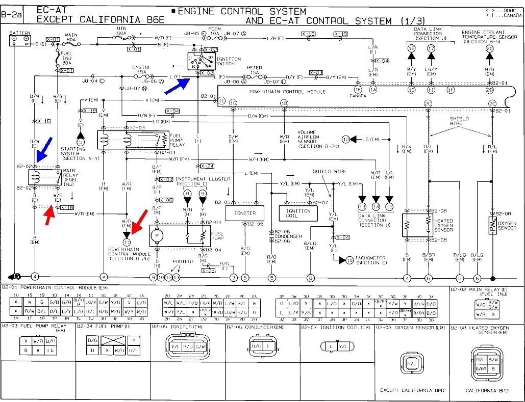

The confusion comes from when you expect to see certain voltages. These three diagrams cover the Engine Computer and controls. Unlike most other brands, you will find 12 volts at the injectors with simply turning the ignition switch to "run". The blue arrows show where 12 volts comes from the ignition switch and turns on the main relay. On other brands, that doesn't occur until the engine is rotating, (cranking or running). That's done to insure the injectors are turned off if a fuel line is ruptured in a crash so raw gas doesn't get dumped on the ground.
Once the main relay is turned on, it switches 12 volts onto the circuit with my red arrows, ending at bullet # 11.
Moving to the second diagram, # 11 continues to the red arrows and includes appearing on the wires that are the same color at all the injectors. That appears to be a white / red tracer, (stripe). That's the wire you should see 12 volts on all the time. Where the confusion comes in is the four individual yellow wires. Those are the ground, or in this case, the control wires. They're only using two switching circuits. Each circuit fires two injectors together at the same time. The Engine Computer grounds those wires when it wants to fire those injectors. With 12 volts on the white / red wire, and 0 volts on the yellow wire, the difference is 12 volts and the injector pops open its valve so fuel can spray out. At the precise time, the computer removes the ground on the yellow wire to turn the injectors off. This is when you'll find 12 volts on both wires. It's coming in on the white / red wire, passes through the coil of wire inside the injector, and will be seen on the yellow wire, as long as the connector is plugged in. If you were to unplug the injector, you would no longer see the 12 volts on the yellow wire.

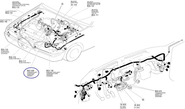

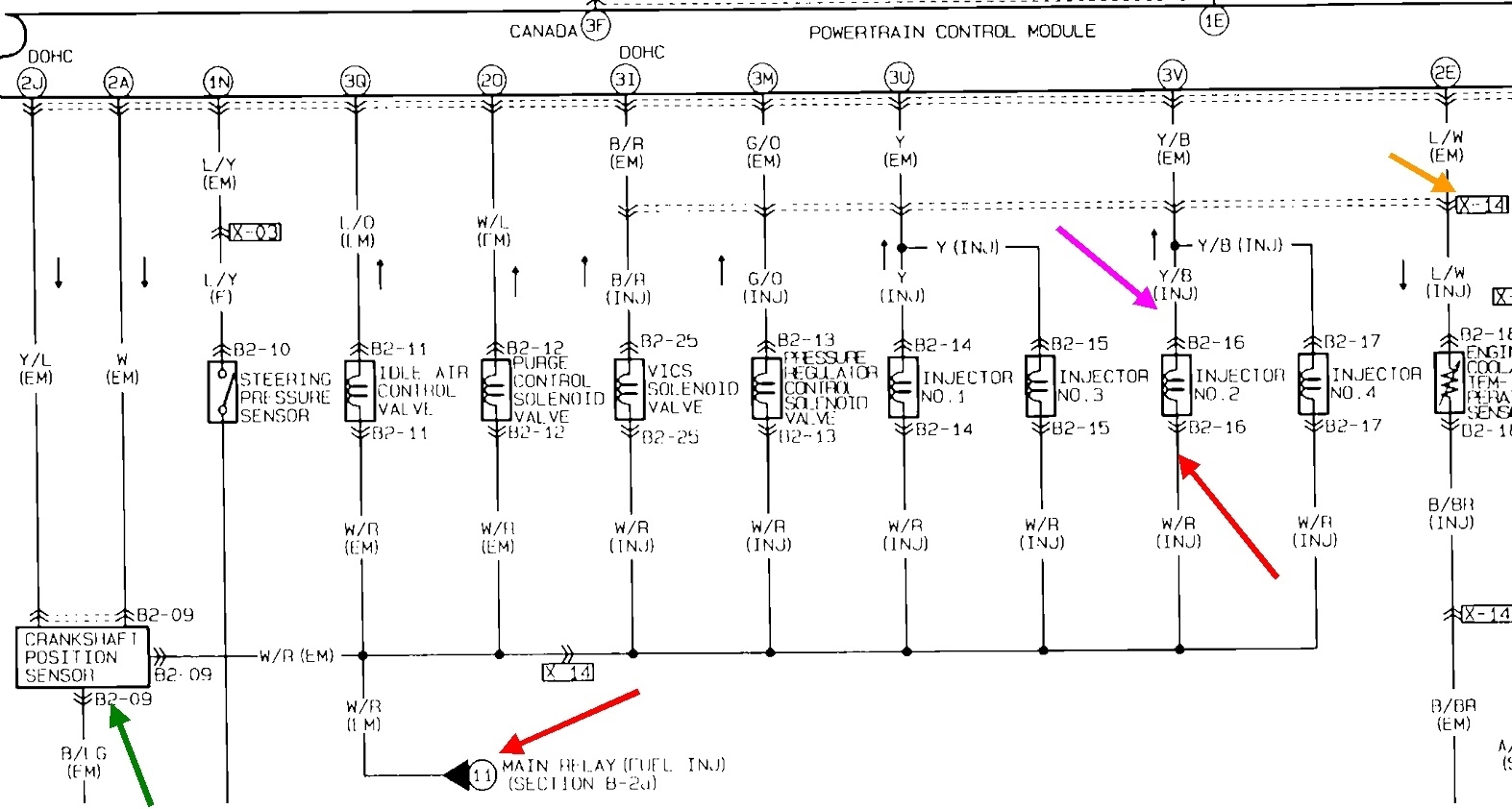

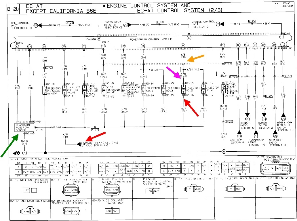

I just noticed the connector I think you unplugged is X-14. I expanded the pertinent part of the second diagram in the fourth one to try to make it easier to read, and I added the orange arrow pointing to X-14. The double dashed line indicates all the other terminals are in the same connector. That's the four injector wires and two wires for solenoids. Based on where those connectors are located in the circuit, you'll still have 12 volts on the feed wire, (red arrows), and on the second terminals for each injector, (purple arrow), as you described. It comes through the coils of wire inside each injector, then shows up on the second terminal. That 12 volts on the second wire will also be there when the plug is connected because the computer doesn't ground them momentarily to fire them until the engine is cranking or running.

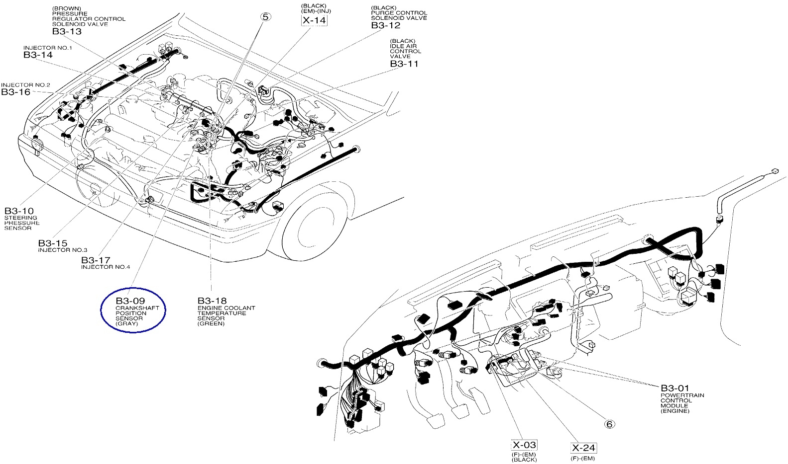

The camshaft position sensor is the one in the distributor. I circled the crankshaft position sensor in the fifth drawing. It's shown in the same place for the single-cam engine and the double-cam engine.
