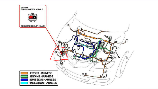

When you reinstalled the new engine, was the EHPAS (electro hydraulic power assist steering) module reconnected? If it was, do me a favor. Disconnect it and see if there is any difference in the assist.
I attached a pic to help you locate it.

Hi Joe, thank you.
I did reconnect the module and I just unplugged it to see if there was any difference, but it's the same. I was just going through to double check connections again. I've stood on my head and pushed the brake pedal with the fuses in my hand and waited 15 minutes, lol. I have tried everything to reset and hard reset, but no prevail.

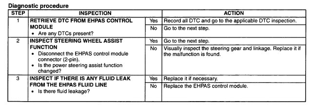

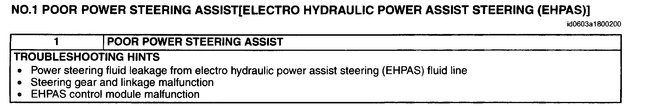

Sorry to ask this, but I need you to have the computer scanned for diagnostic codes. When I check simply under poor assist, here is what it gives me. See the two pics attached.
_____________________
2007 Mazda 3 L4-2.0L
No.1 Poor Power Steering Assist Electro Hydraulic Power Assist Steering (EHPAS)
Vehicle Steering and Suspension Steering Testing and Inspection Symptom Related Diagnostic Procedures No.1 Poor Power Steering Assist Electro Hydraulic Power Assist Steering (EHPAS)
NO.1 POOR POWER STEERING ASSIST ELECTRO HYDRAULIC POWER ASSIST STEERING (EHPAS)
NO.1 POOR POWER STEERING ASSIST [ELECTRO HYDRAULIC POWER ASSIST STEERING (EHPAS)]
No.1 Poor Power Steering Assist [Electro Hydraulic Power Assist Steering (EHPAS)]
Pic 1
Diagnostic procedure
Step 1-Step 3
pic 2
__________________________________________

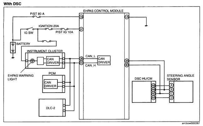

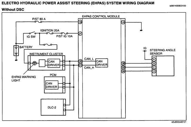

However, there are several codes that correlate with this system. What I can tell you is that the EHPAS is part of the can system in the vehicle, so anything could have happened. If you look at pics 3 and 4, it shows the wiring schematics and how it's tied into the CAN system. In this case, either you need to have the EHPAS module scanned or better yet, the CAN bus system scanned. Here is a video showing how that is done:
https://youtu.be/InIlnsjOVFA
Do you have access to a scan tool that can interface with the module or scan the CAN bus system?
