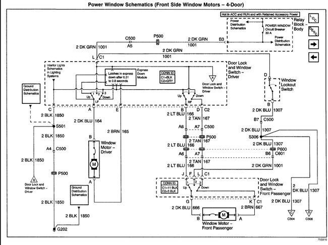

2002 CHEVROLET BLAZER
150,000 MILES
DEEDUBP
Driver side window switch, the wiring harness coming into the back seems to have no power. No other windows will work, even from their doors. I had already replaced the switch before realizing there was no power coming in. Locks, mirrors and everything else works. Is there a windows only fuse?

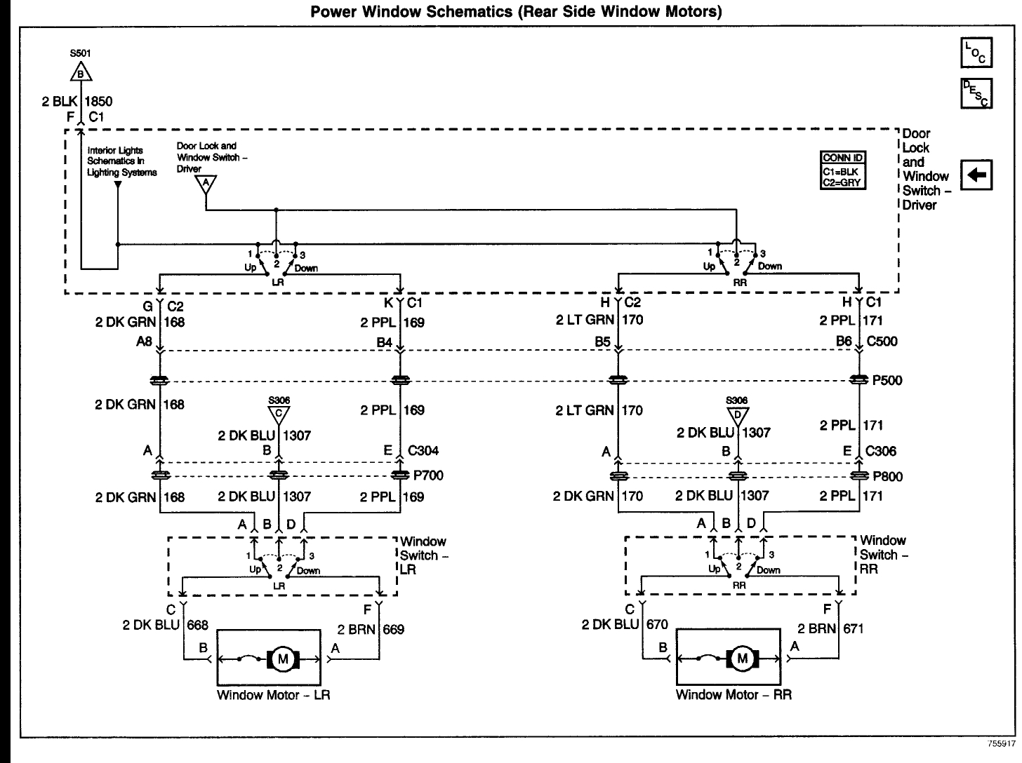

The common reason for this is caused by a broken wire in the boot between the door and the front body pillar. The door motion causes the wires to flex and break. The windows are all on a 30 amp PWR Win breaker in the fuse box under the hood. I have hardly ever seen one fail but it is possible. The broken wires I have seen a lot of.
The attached show the circuits. Primary power for all four windows is the dark green wire.
