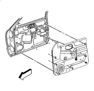

How do I get the door panel off to change the window regulator? Are there special tools? I am mechanically inclined, an electrician and I think I can do this repair. Thanks Bob Doss
Jul 4, 2009 at 1:05 AM
BMRFIXIT
  • 19,053 POSTS

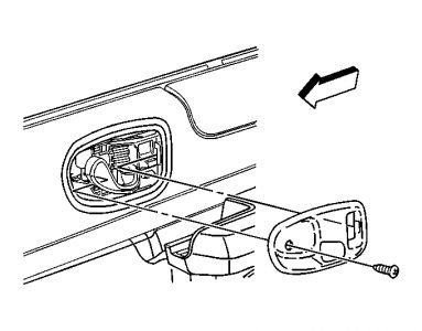

Tools Required J 38778 Trim Pad and Garnish Clip Remover Removal Procedure Remove the inside door handle bezel.
https://images.2carpros.com/forum/automotive_pictures/99387_Graphic2_198.jpg
Remove the power accessory switch mounting panel, if equipped with power accessories. Remove the trim panel armrest screws. Use the J 38778 in order to release the door trim panel retainers. Remove the door trim panel from the door.
https://images.2carpros.com/forum/automotive_pictures/99387_Graphic1_416.jpg

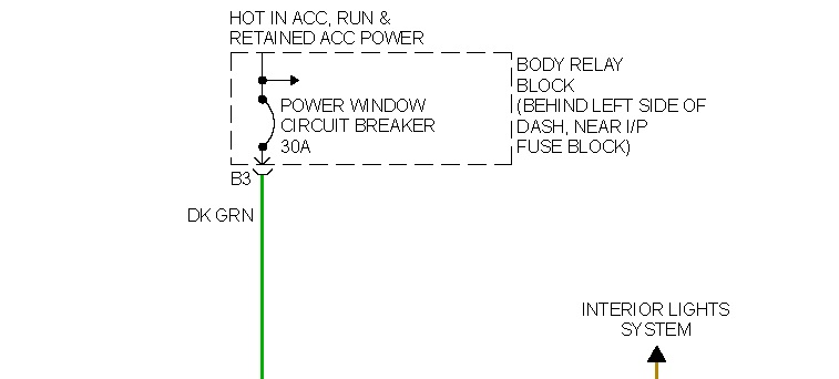

I HAVE A 99 CHEVY BLAZER. THE WINDOW MOTOR ON THE DRIVERS SIDE HAS GONE BAD. NOW NONE OF THE FOUR POWERS WINDOWS WILL ROLL DOWN. IVE REPLACED THE MASTER SWITCH ON THE DRIVERS SIDE AND NOTHING. IF YOU TRY TO GO TO EACH INDIVIDUAL DOOR AND TRY IT THEY STILL WONT WORK. ANY IDEAS??
Aug 12, 2020 at 10:41 AM (Merged)
CARADIODOC
  • 34,381 POSTS
Pull the boot back and check for broken or frayed wires between the driver's door hinges.
JDL
  • 16,098 POSTS
Is there a lock-out at the master switch? If the lock-out is set, the other window switches may not work? Also use a voltage tester at the power window circuit breaker, should be hot/voltage with key on.
When you try to operate window, is circuit breaker hot to the touch? If it trips, none of the windows will work.
BURNFAN06
ive had mechanics where i work look at it. the master switch on the drivers side has door locks and mirrors on it. those work fine. there is no power going to the window part of the switch.
JDL
  • 16,098 POSTS
You need to check the wiring circuits yourself. Caradiodoc is correct, sometimes those wires do break. Hinge side of door.
