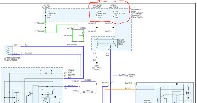

Recently purchased this vehicle and am not too familiar with it yet. The driver's side front and passengers side rear power windows recently just decided to quit working. Upon inspecting closer the other two doors, I discovered they are taped closed. Haven't removed door panels to see what's up with them. just need info on getting the ones that were working operable again. They are both half open and i need them closed! Suggestions?
Sep 10, 2020 at 12:38 PM
  • 110,241 POSTS

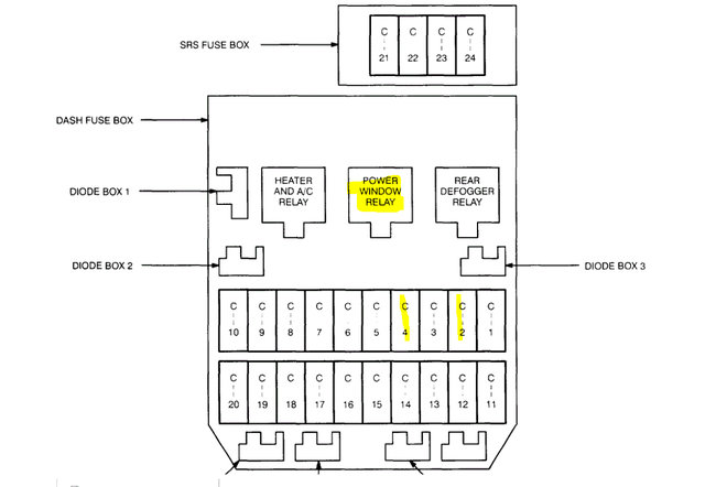

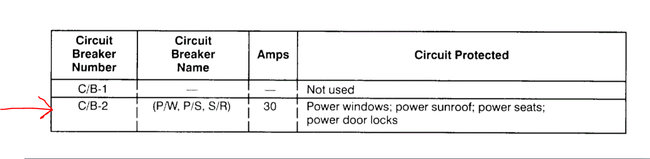

First, check the fuses that are located in the vehicle (left side) under the dash. I attached a pic below. Note that cb2 is a circuit breaker. You will need to conform power to it and out.
I attached a pic of the fuse box to help locate the power supply. Also, if the fuses are good, switch the PW relay with a different one in the box having the same part number to see if that helps.
If there isn't another relay with the same part number. here is a link showing how to test one:
Let me know what you find or if you have other questions. Also, note if the power door locks are working, then the circuit breaker is likely good.
