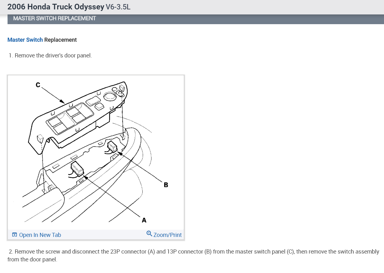

My driver drove my van to help pick up some stuff and it rains heavily on his way back home. A/C unit not working so he has to power the two front doors windows down a bit and in the process, water drips on both passenger and driver power window control switches. The second day the master switch only works for the driver side alone.
I hear a click sound whenever the front passenger's door is controlled from the master switch and for the back doors, but none of the door switches works to power the windows down.
When the sun became hot the following day, they were working fine, although falling at times. Two days later, they are not working anymore. Presently it's only the driver door control switch that is working.
Please, what could be wrong with the power windows switches? Could it be that the rainwater has affected the switch or what?
Your help will be greatly appreciated. Kindly note that nothing of such has happened to the van previously.
Oct 29, 2019 at 8:52 AM
  • 55,432 POSTS

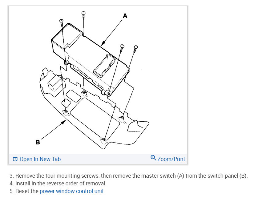

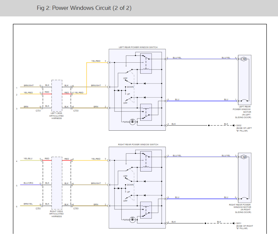

It does sound like the main switch is out because there is a processor that does not like to get wet inside the switch. here is how you replace it. Check out the diagrams (below)? Please let us know what happens.
Oct 30, 2019 at 10:12 AM

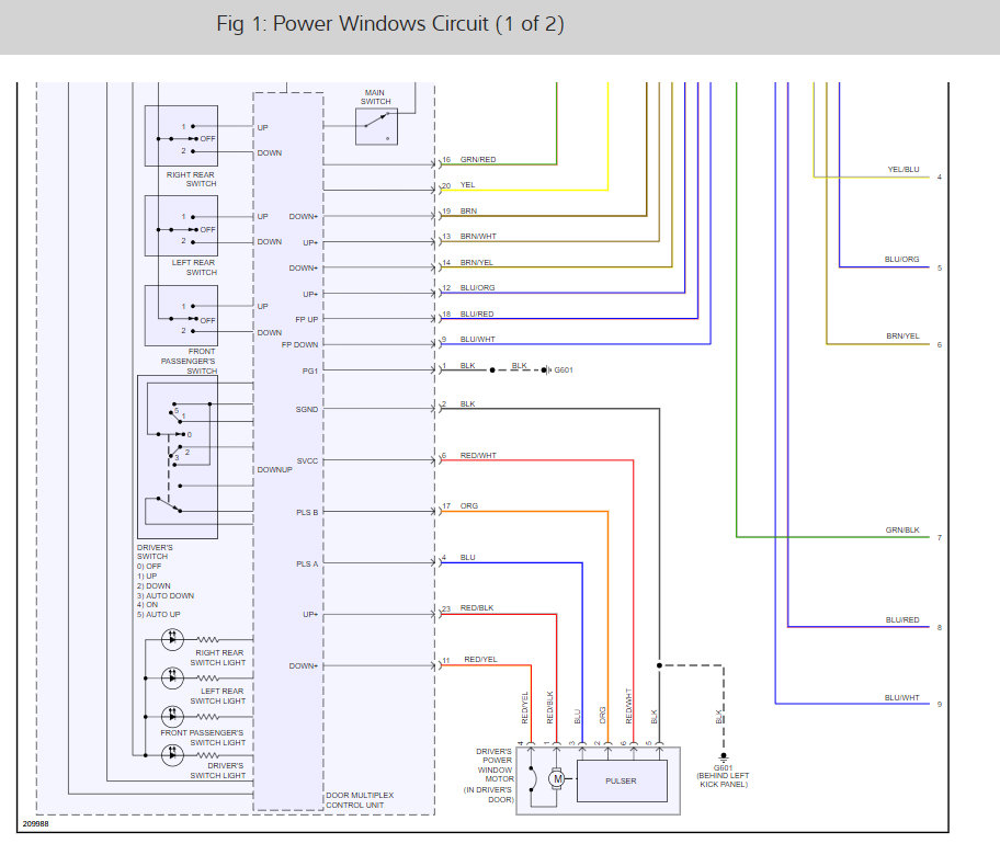

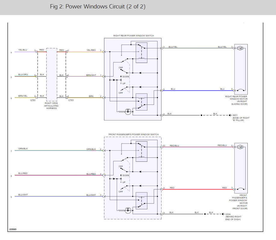

You can test the power and ground with the window control output by using this guide and the window wiring diagrams below so you can see how the system works:
