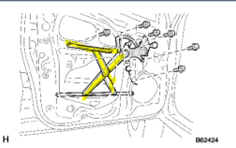

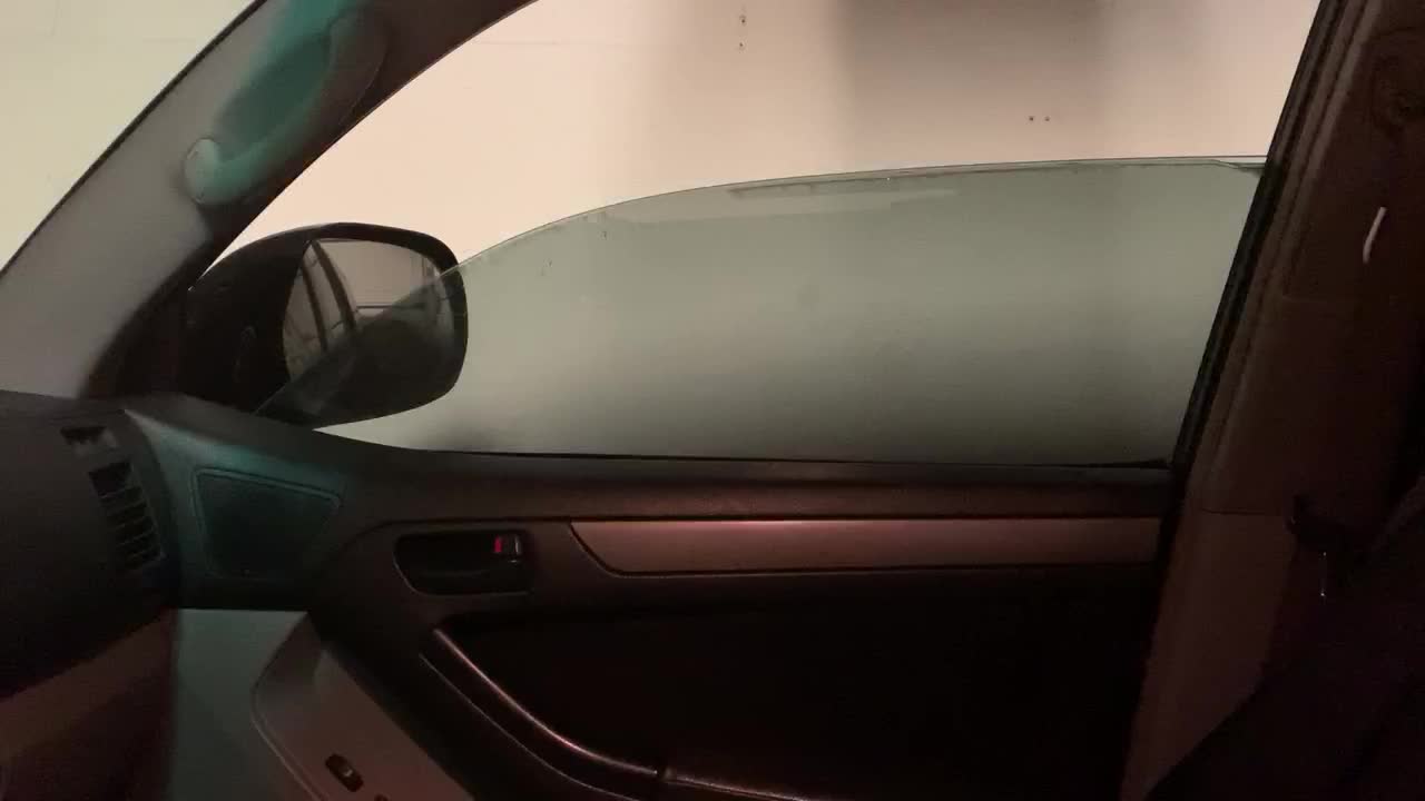

Hello. The front passenger window in my vehicle is stuck half way up. I've tried re-initiating it without success. It moves a little, but won't roll up or down.Please help!
Nov 29, 2019 at 7:28 AM
  • 110,244 POSTS
When you try to move the window, are there any noises? Can you hear the motor running or something grinding? Do the other windows work? If you try helping it up, will it move?
Sorry for so many questions. There are a lot of different possibilities. However, since it is trying to move, if there are no sounds associated, most likely the motor is bad.
Nov 29, 2019 at 1:07 PM
EMBRACEINTEGRITY
  • 11 POSTS

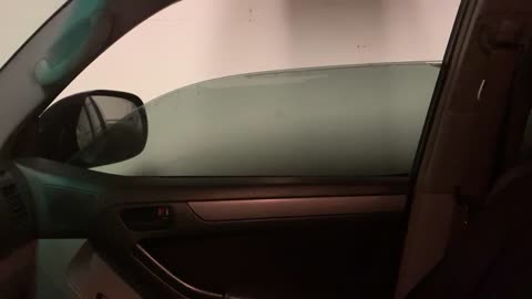

Thanks for your reply! I’m uploading a short clip. It’s like, the back of the window wants to move, but the front doesn’t.
Nov 29, 2019 at 1:35 PM
EMBRACEINTEGRITY
  • 11 POSTS
Here it is:
Nov 29, 2019 at 1:38 PM
  • 110,244 POSTS

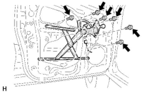

I just watched the video. I suspect the window regulator is bad. If you watch. the one edge of the window moves and the front portion doesn't. The regulator is either broken or something has come apart.
Take a look at the attached pic. It shows the regulator. I highlighted the component I'm referring to. If you want, I can provide directions for removal and replacement. It's a bit tedious to do, but we can give it a try if you want.
Nov 29, 2019 at 2:06 PM
EMBRACEINTEGRITY
  • 11 POSTS
Thanks so much, Joe! That definitely makes sense. I actually took the door panel off to see if I could identify the issue at a glance, but stopped short of pulling the speakers out, etc. That said, I’m up for the challenge. LOL!
Thanks again!
Jessica
Nov 29, 2019 at 2:19 PM
  • 110,244 POSTS
You are very welcome. Listen, I have directions for removal and replacement, but it is part of an entire door overhaul. So, it starts with removal of the door panel and so on. I will stop at the end of the regulator removal. Before you purchase the regulator, remove the panel so you can see in where the door is attached to the regulator. There are two bolts that hold it to the regulator track. Make sure one hasn't come loose and is causing the window to jam.

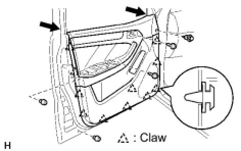

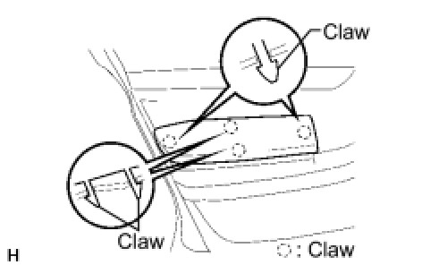

1. REMOVE FRONT DOOR LOWER FRAME BRACKET GARNISH LH
pic 1
(a)Using a screwdriver, remove the lower frame bracket garnish.
HINT: Tape the screwdriver tip before use.

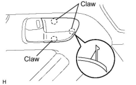

2. REMOVE FRONT DOOR INSIDE HANDLE BEZEL LH
pic 2
(a)Using a screwdriver, disengage the 3 claws, and remove the inside handle bezel.

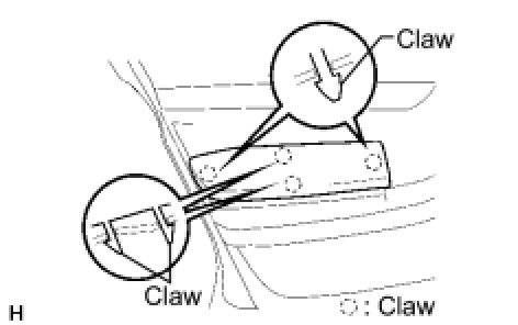

3. REMOVE FRONT ARMREST ASSEMBLY LH
pic 3
(a)Disengage the claws, and remove the armrest from the trim board.

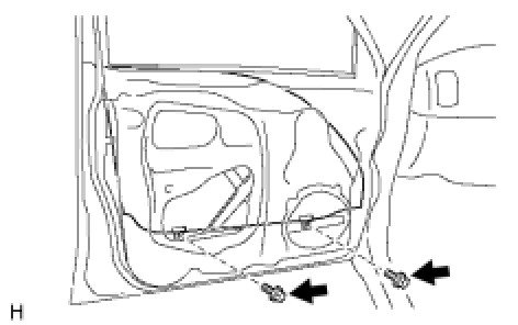

4. REMOVE FRONT DOOR TRIM BOARD SUB-ASSEMBLY LH
pic 4
(a)Remove the 2 cushion rubbers.
(b)Remove the 2 screws and clips.
(c)Using a clip remover, remove the 11 clips.
(d)Remove the trim board upward.
HINT: In order to prevent the door from being damaged, cover the parts indicated by arrow marks in the illustration with tape.

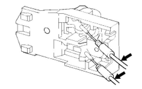

(e)Disconnect the 2 cables from the inside handle as shown in the illustration.

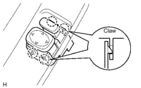

pic 6
(h)Using a screwdriver, disengage the 4 claws.
(i)Remove the power mirror switch, as shown in the illustration.

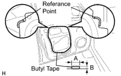

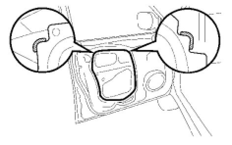

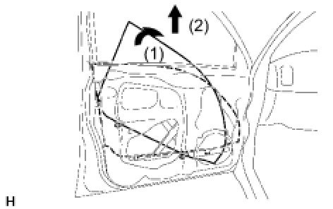

5. REMOVE FRONT DOOR SERVICE HOLE COVER LH
pic 7
(a)Remove the front door service hole cover LH.
NOTE: Remove the remaining tape on the door side.

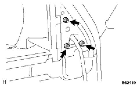

(a)Disconnect the outer rear view mirror connector.
(b)Remove the 3 nuts and outer rear view mirror.
NOTE: When the nuts are removed, the outer rear view mirror might drop and be deformed.

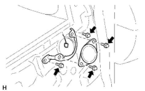

7. REMOVE FRONT NO. 1 SPEAKER ASSEMBLY See: Speaker > Removal and Replacement > Removal
8. REMOVE FRONT NO. 2 SPEAKER ASSEMBLY
pic 9
(a)Disconnect the speaker connector.
(b)Remove the 2 bolts and No. 2 speaker.
(c)Remove the 2 bolts and speaker mounting No. 1 bracket.

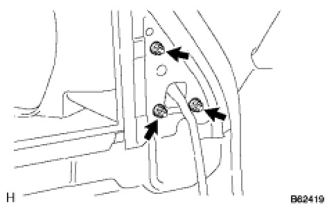

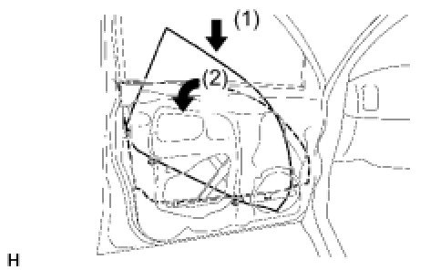

11. REMOVE FRONT DOOR GLASS SUB-ASSEMBLY LH
HINT: Insert a shop rag inside the door panel to prevent the glass from being scratched.
pic 10
(a)Open the door glass until the bolts appear in the service holes.
(b)Remove the 2 bolts and holding the door glass.
pic 11
(c)Remove the door glass, as shown in the illustration.
NOTICE:
- Do not damage the door glass.
- When the bolts are removed, the door glass might drop and be deformed.
(d)Remove the door glass run.

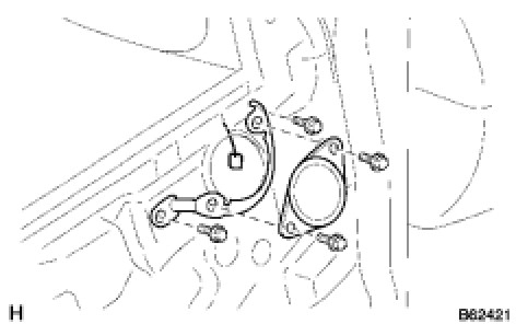

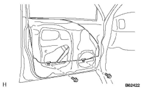

12. REMOVE FRONT DOOR WINDOW REGULATOR SUB-ASSEMBLY LH
pic 12
(a)Disconnect the window regulator connector.
(b)Remove the 6 bolts and window regulator.
NOTE: When the bolts are removed, the window regulator might drop and be deformed.
HINT: Remove the window regulator through the service hole.
13. REMOVE POWER WINDOW REGULATOR MOTOR ASSEMBLY LH
(a)Place matchmarks on the window regulator motor gear and regulator gear.
(b)Using a "torx" driver (T25), remove the 3 screws and window regulator motor
________________________________________ Note that the number starts on 7. I bypassed removal of the door, wiring, exterior handle, and so on.
7. INSTALL POWER WINDOW REGULATOR MOTOR ASSEMBLY LH
(a)Align the matchmarks on the regulator motor gear and regulator gear.
(b)Using a "torx" driver (T25), install the door regulator motor with the 3 screws.
Torque: 5.4 Nm (55 kgf-cm, 48 in-lbf)

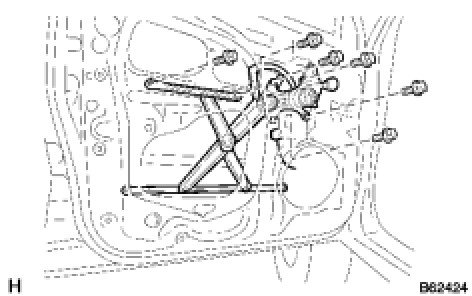

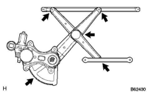

8. INSTALL FRONT DOOR WINDOW REGULATOR SUB-ASSEMBLY LH
pic 13
(a)Apply MP grease to the sliding and rotating parts of the window regulator.
NOTE: Do not apply grease to the spring of the window regulator.
pic 14
(b)Install the window regulator with the 6 bolts.
Torque: 8.0 Nm (82 kgf-cm, 71 in-lbf)
(c)Connect the window regulator connector.
NOTE: Be careful not drop and deform the door window regulator.

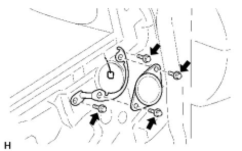

10. INSTALL FRONT NO. 2 SPEAKER ASSEMBLY
pic 17
(a)Install the No. 1 speaker bracket with the 2 bolts.
(b)Connect the speaker connector.
(c)Install the No. 2 speaker with the 2 bolts.

12. INSTALL FRONT DOOR SERVICE HOLE COVER LH
pic 19
(a)Apply butyl tape to the door, as shown in the illustration.
Adhesive:
Part No. 08850-00065, Butyl Tape Set or equivalent
(b)Install the service hole cover.

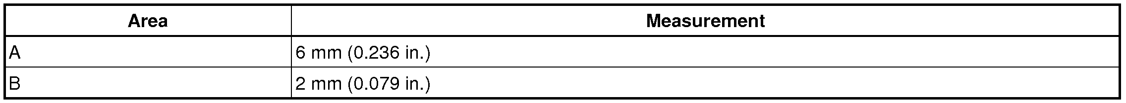

Standard dimension:
pic 20
HINT:
- When installing the service hole cover, pull out the links and connectors through the service hole cover.
- There should be no wrinkles or folds after attaching the service hole cover.
- After attaching the service hole cover, check the sealing condition.
