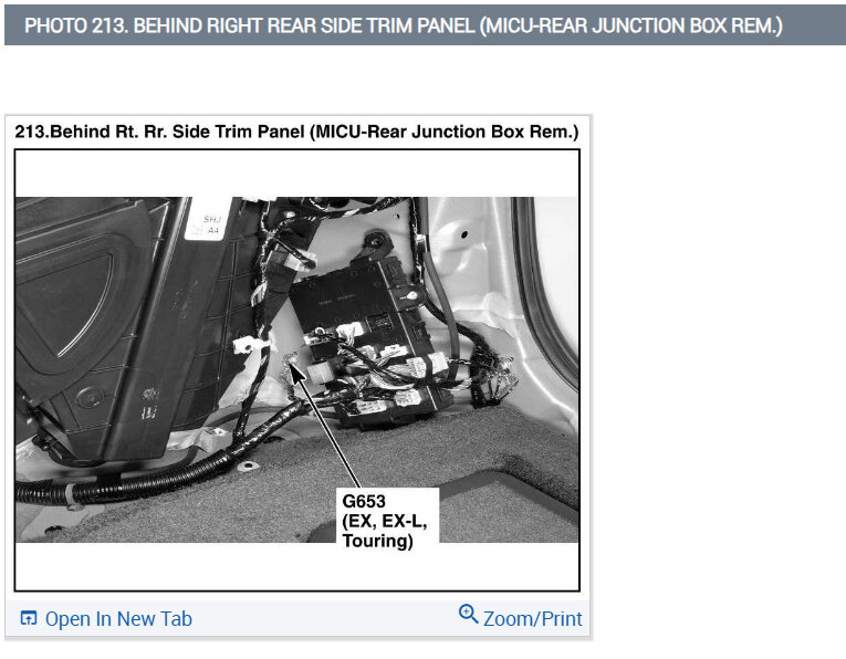

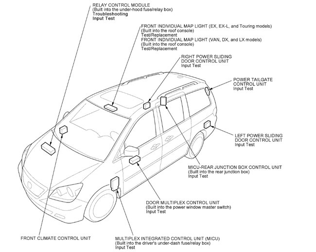

our van has been going a little crazy lately due to roof leaking on passenger side i have a passenger side window that will not roll back up with master switch i have a driver rear that won't roll down with master switch my headlights have started only coming when key is on the brightness on cluster resets every time i start vehicle the dome lights don't work anymore door locks only work when they want to just noticed tonight that fuel gauge was very slow to respond i suspect i have a canbus problem from some of the research I've done trying to figure out a starting point on this big mess also have a list of codes. B1056, 1057,1058, 1060, 1061, 1062, 1063, and 1160 Please help!

It sounds like the MICU got wet or is shorted out here is how to fix it:
Here is the location of the MICU and how to change it out. Check out the images (below). Please let us know how it goes.
