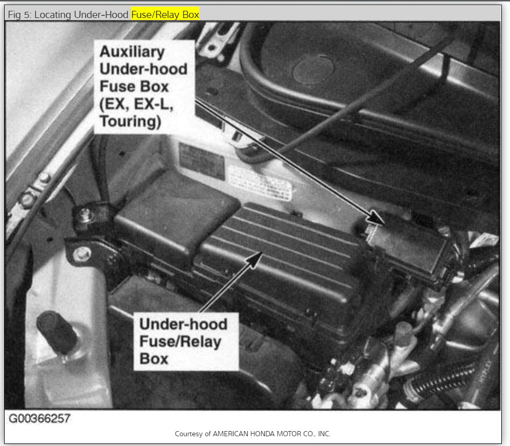

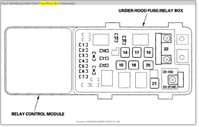

Yesterday I noticed that the van had absolutely no power. No lights and would not crank at all when I tried starting. I replaced the battery and still nothing. I first noticed this when I tried unlocking the van with the remote and it would not unlock. I show 12.5 volts coming out and 12.5 volts from the main fuse box. I am guessing a relay or fuse? It is hard to check since all fuses look to be good.

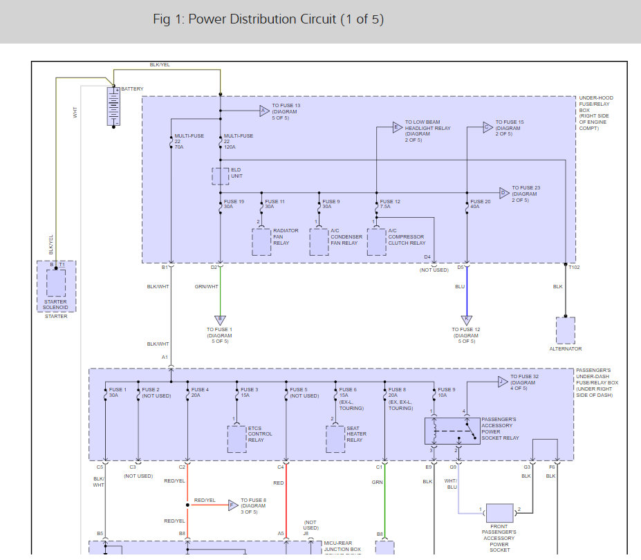

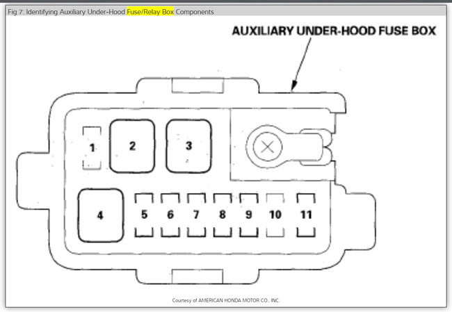

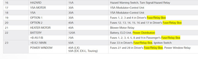

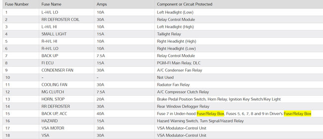

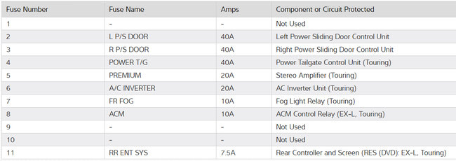

It sounds like the maxi fuse # 22, 70 amp needs to be checked for power. Here is a guide to help you get started:
Check out the diagrams (below). Please run some tests and get back to us.

Thanks for the guides and information, the fuse was blown! This site is great it worked. I am back on the road. :)
