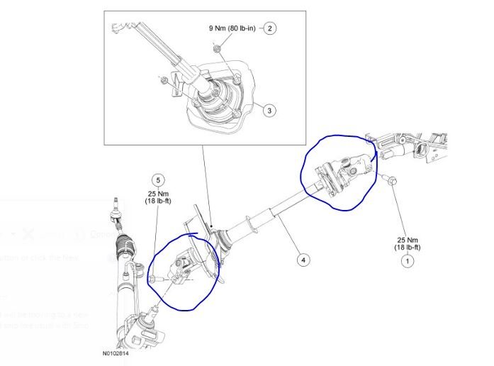

Last week we had so much rain it brought with it tons if mud and dirt. after i cleaned it all out noticed steering a bit binding, even when parked turning it will cause a whooshing sound. no popping noise or any other symptoms. still smooth steering just a bit bindy, looked under and i saw a shiny part of the power steering shaft, assuming there is a bearing that popped out, is there such thing in these? I will send a picture soon.

Sounds like the u joints in the steering shaft may be binding up. See if they have a grease fitting. If they do, grease them. Otherwise, they would need to be replaced.

I greased the top one but didn't know there is another one down below. also greased on top of the bottom blue circle where shaft meets rack and pinion, do these go bad? A bearing there? Greased all that and no change.

Yes, they do go bad.

There are needle bearings inside the joint that seize up instead of rolling freely.

Steering Column Shaft
Removal
1. With the vehicle in NEUTRAL, position it on a hoist. REFER to Section 100-02, Jacking and Lifting See: Vehicle Lifting > Procedures > Jacking and Lifting, Lifting Points.

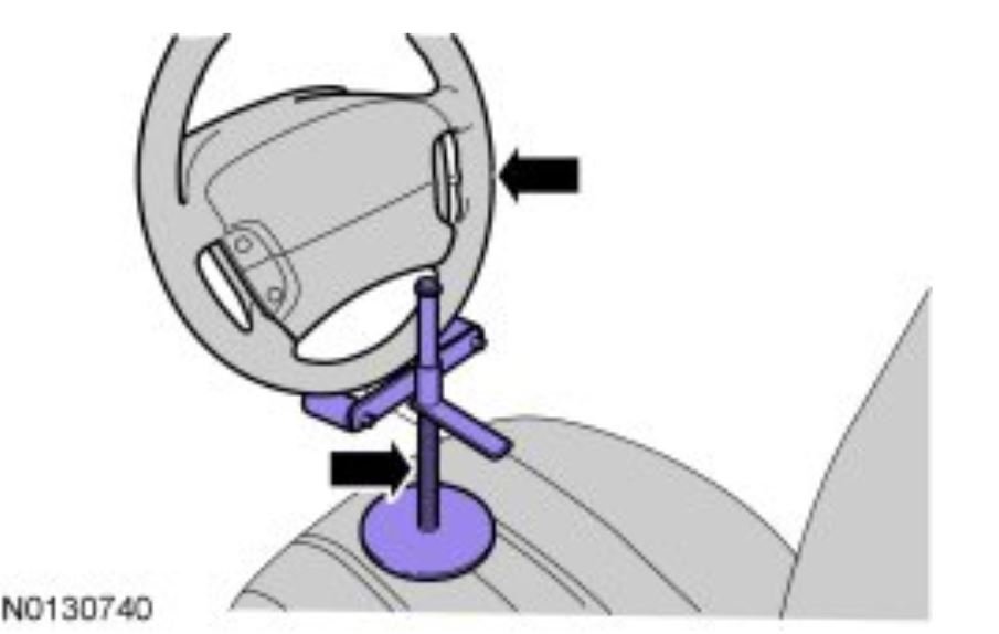

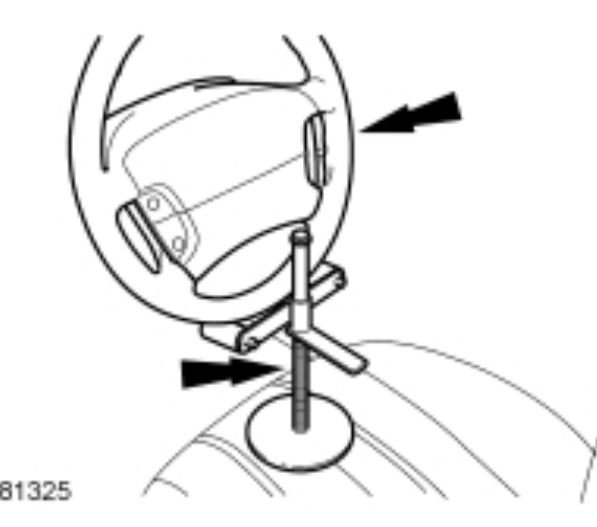

2. Using a suitable holding device, hold the steering wheel in the straight-ahead position.
3. NOTICE: Do not allow the steering column to rotate while the steering column shaft is disconnected or damage to the clockspring may result. If there is evidence that the steering column shaft has rotated, remove and recenter the clockspring.
Remove and discard the steering column shaft-to-steering gear bolt and disconnect the steering column shaft from the steering gear.
4. Remove the 2 steering column cover trim panel screws and the steering column cover trim panel.
5. Remove the 4 steering column cover screws and the steering column cover.
6. Remove the 3 steering column shaft boot nuts.
7. Remove and discard the steering column shaft-to-steering column bolt and disconnect the steering column shaft from the steering column.
8. Remove the steering column shaft and steering column shaft boot.

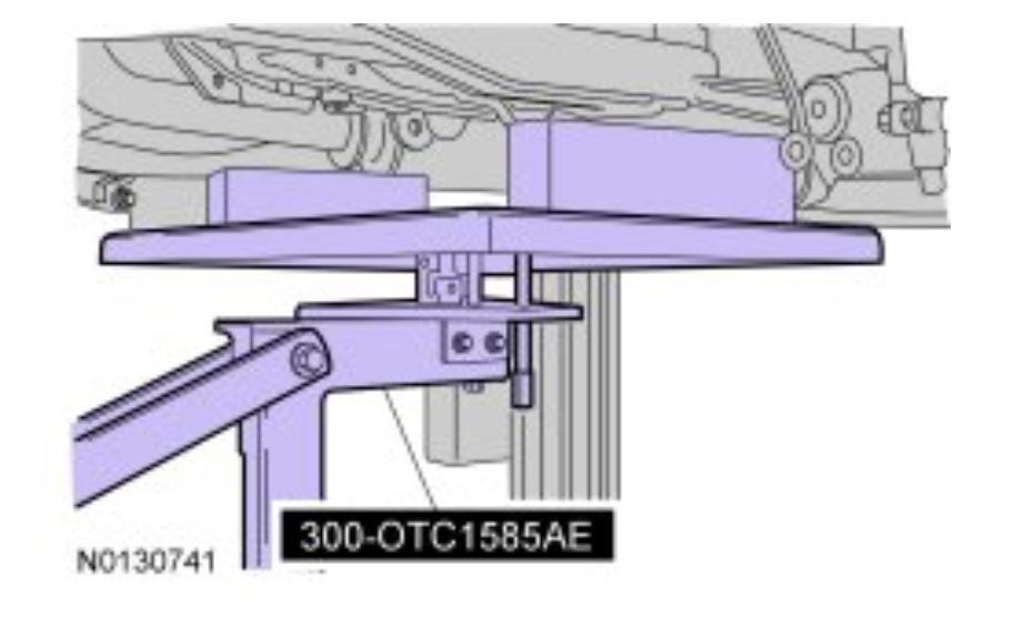

14. Position 300-OTC1585AE under the subframe.
15. Remove the 2 subframe rearward bolts, the 4 support bracket bolts and the 2 subframe support brackets.
