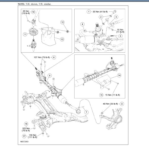

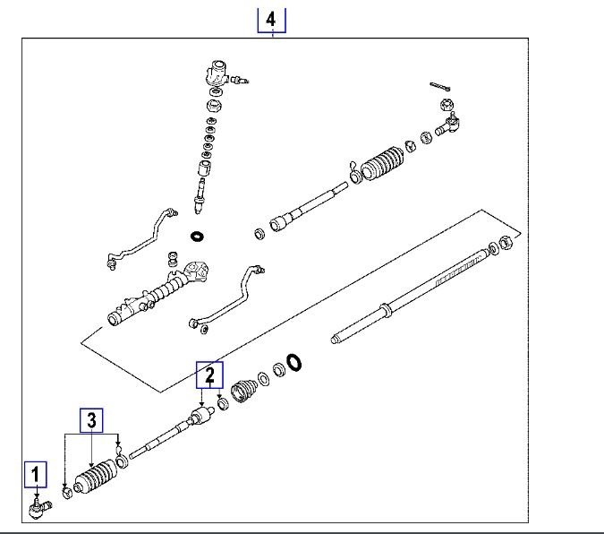

The hydraulic power steering rack on my car listed above 1.6tdci has failed. The fitted rack is listed as having 3.3 turns lock to lock. The replacement racks I am finding are 2.75 turns. Given that all other physical dimensions are the same, will the 2.75 rack fit in place of the 3.3 rack?
Jul 15, 2020 at 4:03 AM
Good morning,
Yes, If the dimensions are the same, and they are, then it will work. Make sure you flush the system of all the old fluid.
https://www.2carpros.com/articles/power-steering-fluid-flush
I was trying to find the rack but nothing came up for over 4 turns.

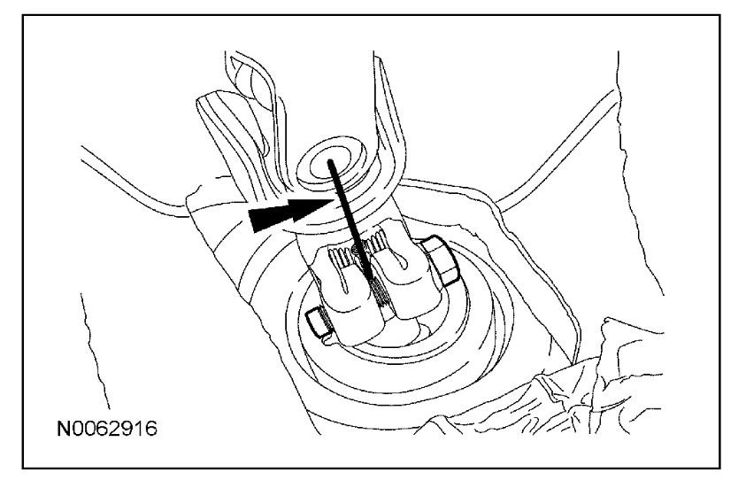

4. CAUTION: Make sure to correctly index-mark the steering gear-to-steering column shaft position or unequal right-to-left turns may occur, causing tire contact with the body and/or clock-spring damage.
Index-mark the steering column shaft-to-steering gear position for reference during installation.
5. CAUTION: Do not allow the steering column to rotate while the steering column shaft is disconnected from the steering gear or damage to the clock-spring may occur. If there is evidence that the steering column has rotated, the clock-spring must be removed and re-centered. For additional information, refer to Air Bag Systems.
Remove the bolt and disconnect the steering column shaft from the steering gear.

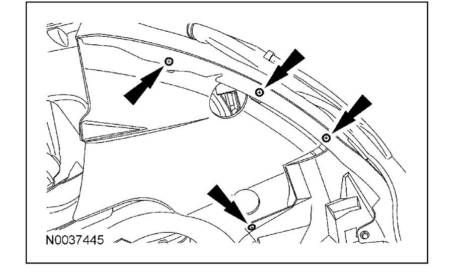

Remove 4 screws from each side and position the RH and LH fender splash shield aside.
8. NOTE: RH side shown, LH side similar.
Remove the 6 pin-type retainers (4 shown) from the LH and RH splash shield.

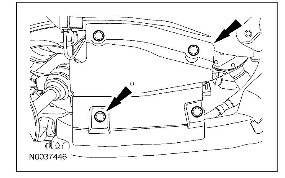

9. If equipped, remove the bolts and the under-body splash shield.

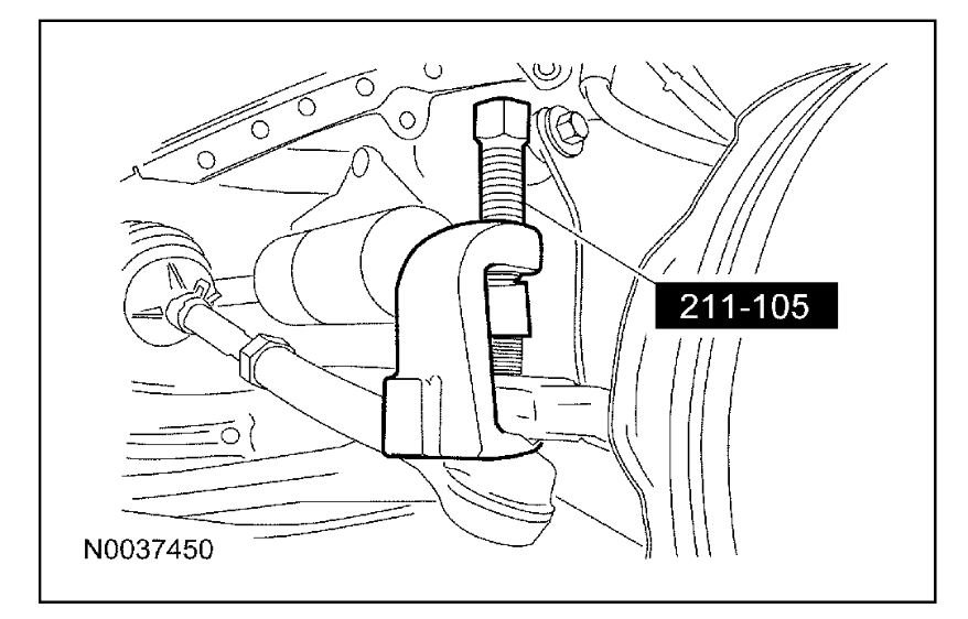

11. CAUTION: Do not use a hammer to separate the outer tie-rod end from the wheel knuckle or damage to the wheel knuckle may result.
Using the special tool, separate the outer tie-rod ends from the knuckle.

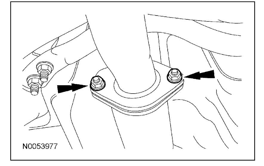

Remove and discard the 2 catalytic converter-to-exhaust flexible pipe nuts and separate the exhaust flexible pipe.

16. Remove the pressure line-to-steering gear banjo bolt.
Discard the bolt and 2 seals.
17. Support the rear of the subframe with a suitable jack and remove the 4 rear subframe bolts and 2 rear subframe nuts.
18. Lower the rear of the front subframe 76.2 mm (3 in) with the support of the jack.
19. Release the clamp and disconnect the steering gear-to-fluid cooler return hose.
20. Remove the 3 steering gear bolts.
21. Remove the steering gear from the LH side of the vehicle.
