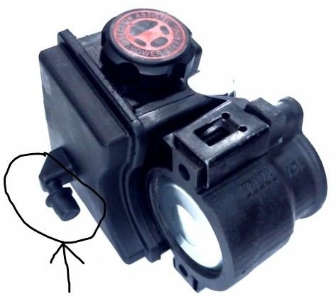

Not a common issue, however the easiest way to repair it would be to flush it out. Water will settle to the bottom but in this case that isn't a good thing as that means it can get trapped in the steering rack. There are a few ways to do this but it depends on what you have available. The fastest way would be to remove as much fluid as possible from the power steering pump, then remove the return line from reservoir and block the fitting that is shown in the attached image. Then put the open end into a bucket. Now fill the reservoir with new fluid and have someone start the engine. Keep pouring in new fluid while the old is pumped out. After you have flushed it with a quart or two. Shut the engine off, reconnect the line and top up the fluid, now start the engine and steer left and right, this will force fluid through under higher pressure and should make any remaining water go into the fluid. Now remove the line and flush again. In total you can expect to use 5-6 quarts of fluid to flush it clean.

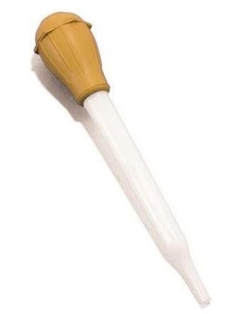

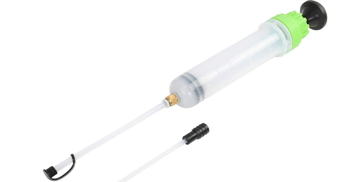

Next is a variation on this but without removing the line.You use something to remove as much fluid as possible, a fluid extractor or even a common turkey baster will work. Then fill with new. Start the engine and steer back and forth while setting still. Shut the engine off and remove the fluid again, then repeat the removal and refill with clean fluid until you see no evidence of water and the fluid is clean.
