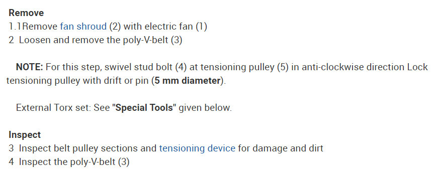

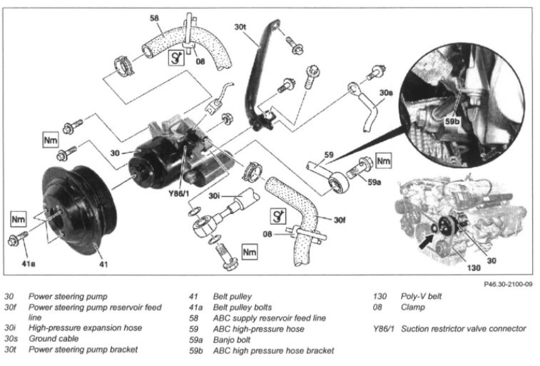

How do you remove the pulley from the OEM assembly?
Dec 20, 2020 at 1:09 AM
DANNY L
  • 5,648 POSTS
Hello, I'm Danny.

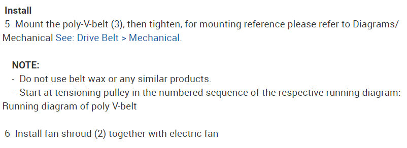

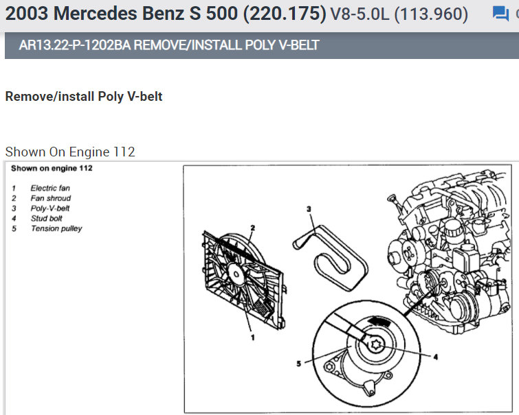

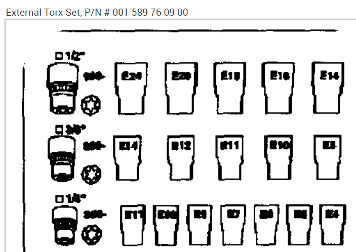

The power steering pulley is attached to the pump with 3 bolts. You will need to remove the serpentine belt to remove the pulley. Prior to removing the belt I would first loosen the pulley bolts to make removal easier. Here is a tutorial showing how to remove and replace a serpentine belt:
I've attached picture steps below on how to replace the serpentine belt on your car as well as a picture of the power steering pump pulley. Hope this helps and thanks for using 2CarPros.
