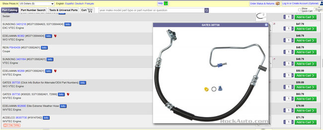

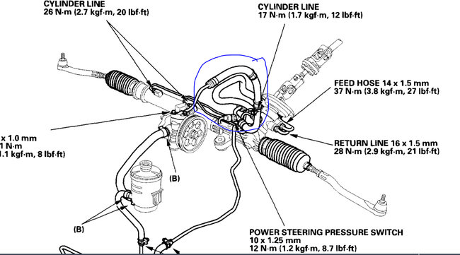

Is there a secret or a trick to winding this thing in? I've tried bottom to top and top to bottom and even taking off driverside tire and going in from the side.
Dec 1, 2020 at 6:29 PM
Good morning,
I would remove the line from the rack from under the car. Then come back up top and release the hose from the pump itself. Then you can remove it from the car.
https://www.2carpros.com/articles/power-steering-fluid-flush

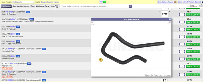

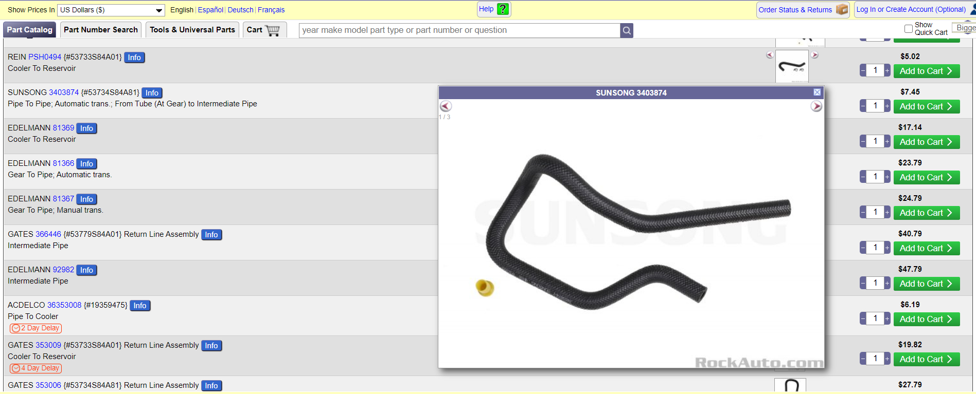

The return line is more difficult and it runs around under the car to the front for cooling of the fluid, There are clamps that need to be released to allow the line to move and be removed from the car itself.
I attached the parts below for you as well.
