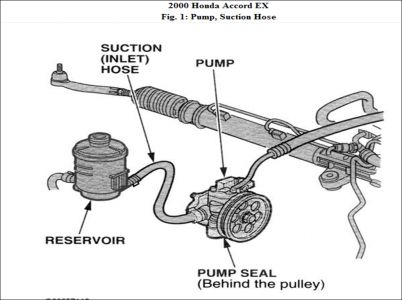

Hello - Hello Again, I went through about 200 Technical Service bulletins on your car and there is one on the power steering and leaking. I have attached it for your review. POWER STEERING FLUID FOAMS AT RESERVOIR TECHNICAL SERVICE BULLETIN Reference Number(s): HSN 0201-03, Date of Issue: February 2001 HONDA: All models with power steering CATEGORY: Honda Service News APPLIES TO: All models with power steering Related Ref Number(s): HSN 0201-03 ARTICLE BEGINNING SERVICE INFORMATION On all Hondas with power steering, a pin hole leak between the reservoir and the suction (inlet) side of the pump can cause the power steering fluid in the reservoir to foam and overflow. When air is sucked into the system, it mixes with the fluid and causes it to foam. This foaming can also cause the pump to growl. Pin hole leaks are hard to diagnose because they let air in but they don't leak fluid out. So, if you suspect a pin hole leak, try this: 1. Start the engine, and let it warm up to operating temperature. 2. Adapt a hand pump to fit into the reservoir opening. (If you're using a Mighty-Vac pump, it comes with adapters to do this.) 3. With the engine idling, connect the hand pump to the reservoir, and pressurize the reservoir to a maximum of 8 psi. 4. Look for a leak in the suction (inlet) hose or at the pump seal. Repair the power steering system as needed.
https://images.2carpros.com/forum/automotive_pictures/248015_Fig_1_1.jpg

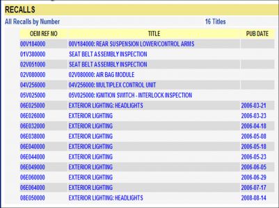

I would still suggest to do as I said and then watch for leaks or fluid from the cap then do the above. Also, it looks like you may have some recalls on your vehicle. The dealer may fix these for free. Please contact the dealer service department, give them the VIN number of your car and have them check on these to see if they apply to you. I would definitely check all of these out but the ones that concern me are the air bag, seat belt and suspension.
https://images.2carpros.com/forum/automotive_pictures/248015_Recalls_10.jpg
