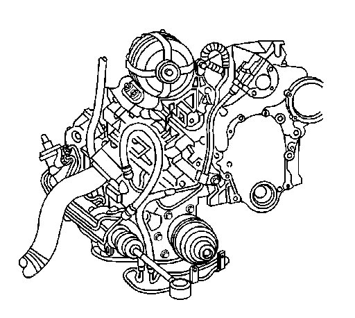

2005 Chevrolet Impala V6-3.4L VIN E
Power Steering Return Hose Replacement
Vehicle Steering and Suspension Steering Power Steering Power Steering Line/Hose Service and Repair Procedures Power Steering Return Hose Replacement

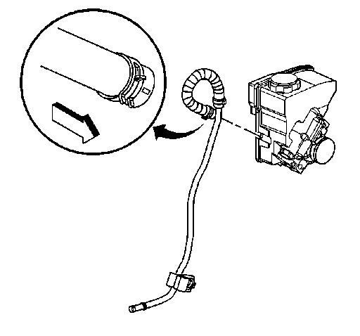

POWER STEERING RETURN HOSE REPLACEMENT
Power Steering Return Hose Replacement (3.4L)
Removal Procedure
1. Place a drain pan under the vehicle in order to catch any draining power steering fluid.
pic 1
2. Remove the power steering return hose from the power steering pump.
3. Remove the power steering return hose from the power steering lines retaining bracket on the engine.
4. Remove the power steering return hose from the power steering cooler pipe.
5. Remove the power steering return hose from the vehicle.

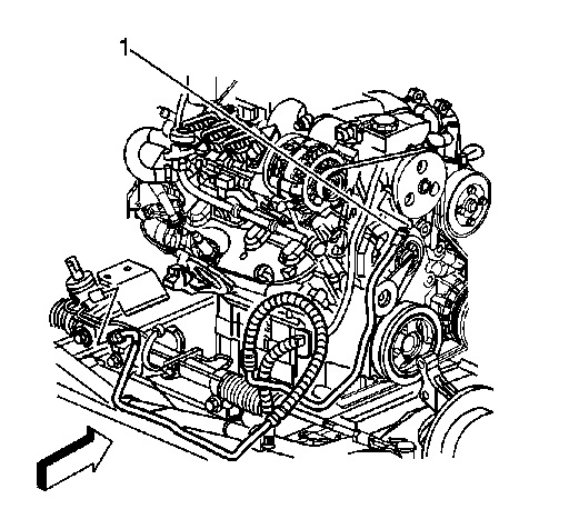

Installation Procedure
1. Install the power steering return hose.
2. Install the power steering return hose to the power steering cooler pipe.
pic 2
3. Install the power steering return hose to the power steering lines retaining bracket on the engine.
4. Install the power steering return hose to the power steering pump.
5. Fill the power steering system.
6. Bleed the power steering system.
7. Inspect the power steering system for leaks.
8. Remove the drain pan from under the vehicle.

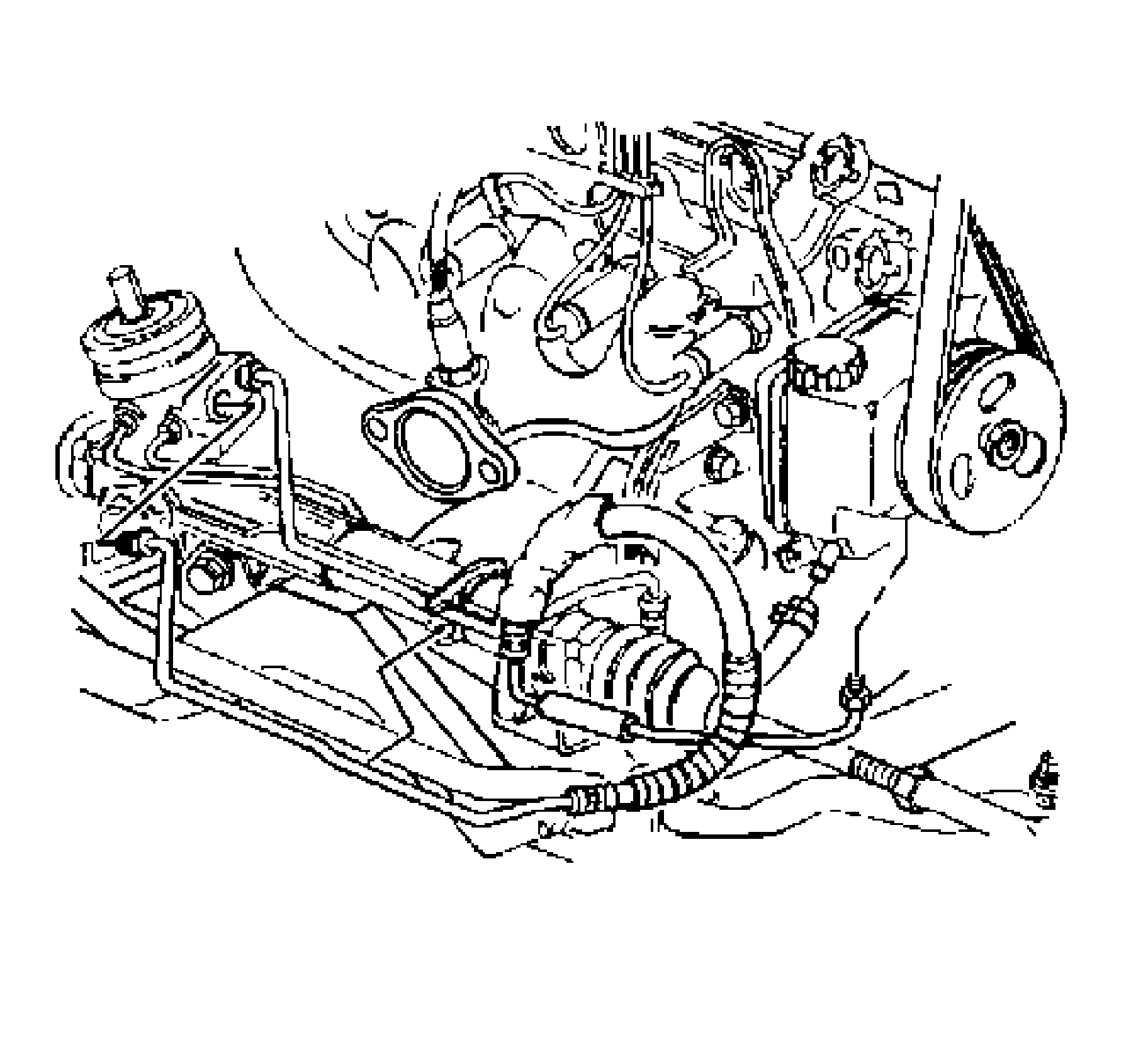

High pressure
Power Steering Pressure Pipe/Hose Replacement
Vehicle Steering and Suspension Steering Power Steering Power Steering Line/Hose Service and Repair Procedures Power Steering Pressure Pipe/Hose Replacement

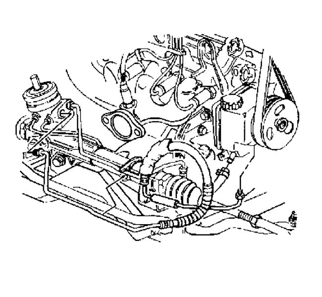

POWER STEERING PRESSURE PIPE/HOSE REPLACEMENT
Power Steering Pressure Pipe/Hose Replacement (3.4L)
Removal Procedure
1. Place a drain pan under the vehicle.
pic 3
2. Remove the power steering pressure line from the power steering pump.

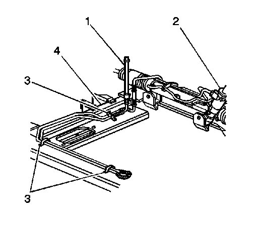

3. Remove the power steering pressure line from the power steering lines retaining bracket on the engine.
pic 4
4. The power steering pressure line is the lower line at the power steering gear. Remove the power steering line from the power steering gear. Access the line from the engine compartment, between the rocker arm cover and the front of the dash mat.

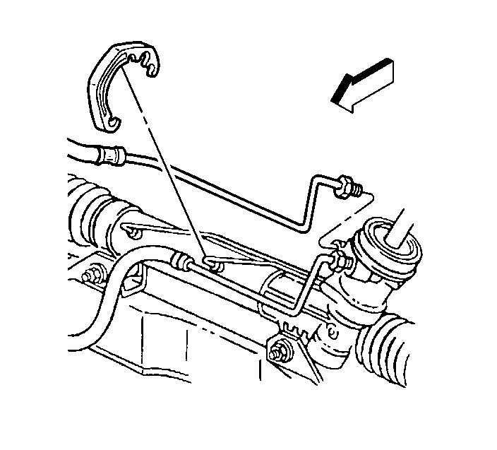

5. Raise and suitably support the vehicle. Refer to Vehicle Lifting.
pic 5
6. Remove the power steering pressure line (1) from the clamps on the power steering gear.
7. Remove the power steering pressure line (1) from the vehicle.

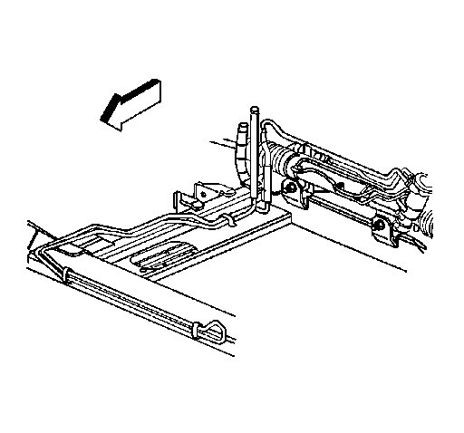

pic 6
1. Install the power steering pressure line (1) to the vehicle.
2. Install the power steering pressure line (1) to the clamps on the power steering gear.

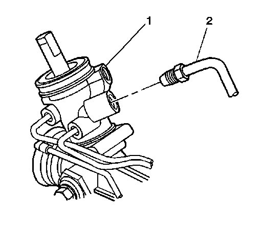

2005 Chevrolet Impala V6-3.8L SC VIN 1
Power Steering Pressure Pipe/Hose Replacement (3.8L)
Removal Procedure
2. Remove the accessory drive belt.
3. Raise and support the vehicle. Refer to Vehicle Lifting.
4. Remove the tire and wheel assembly.
pic 1
5. The power steering pressure hose is the lower hose at the power steering gear. Remove the power steering pressure hose from the power steering gear.
6. Remove the power steering pressure hose from the power steering pump.
7. Remove the power steering pressure hose from the clamps on the power steering gear.
8. Remove the power steering pressure hose from the vehicle.
Power Steering Return Hose Replacement (3.8L)
Removal Procedure
1. Raise and support the vehicle. Refer to Vehicle Lifting.
2. Remove the tire and wheel assembly.
pic 3
3. Remove the power steering return hose (2) from the power steering gear (1).
4. Remove the return hose (2) from the clips on the power steering gear.
pic 4
5. Remove the return hose (1) from the power steering pump.
6. Remove the return hose (1) from the hose retainers (3) on the cradle (4).
7. Disconnect the clips and the electrical harnesses from the return hose (1).
8. Remove the return hose (1) from the vehicle.
