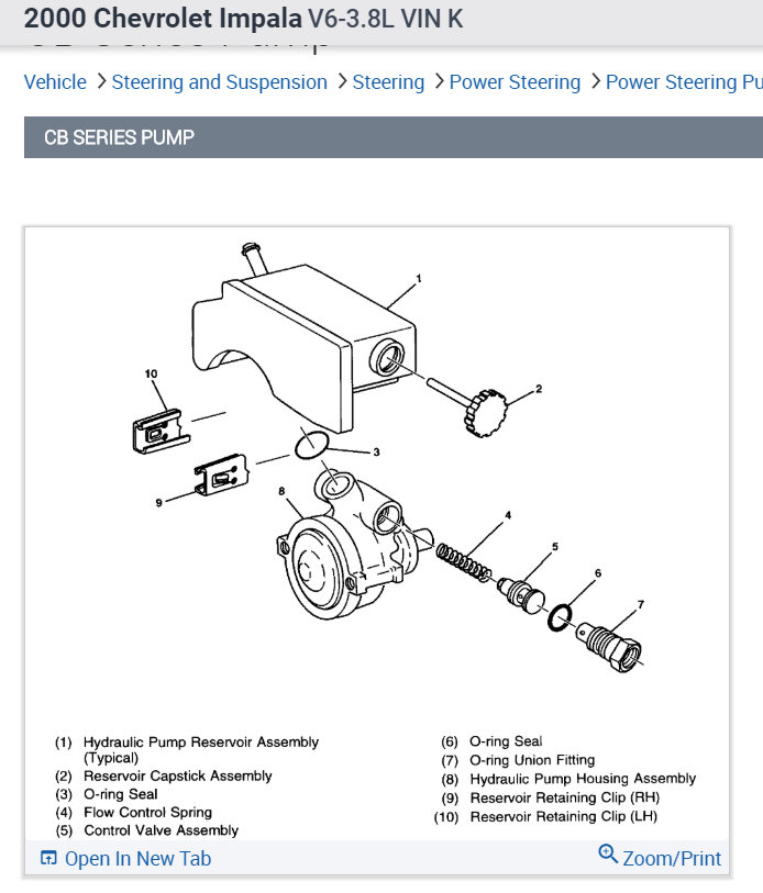

I'm trying to locate the power steering reservoir on my 2000 Impala. Sounds easy enough but on the 3800 motor the reservoir seems to be hidden. I simply want to check the power steering fluid level.
May 12, 2008 at 5:21 PM
RHALL77
  • 3,361 POSTS

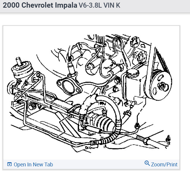

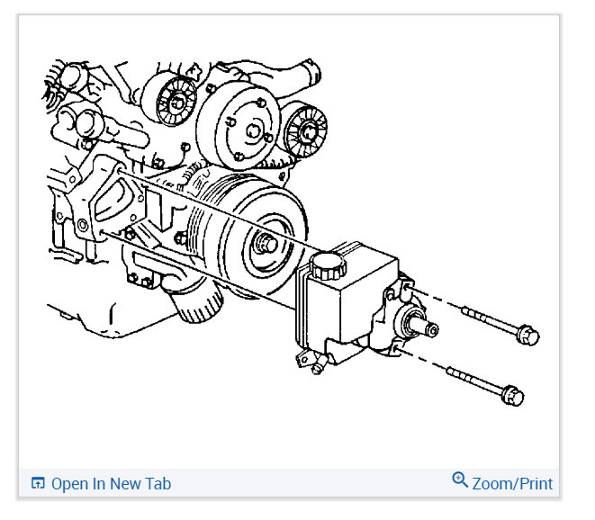

The reservoir and fill cap with the dipstick is on the pump itself. Here are diagrams to help you see what I an talking about below. Check out the diagrams (Below). Please let us know if you need anything else to get the problem fixed.
May 13, 2008 at 12:45 AM
SJTIII
Thanks for the post! I found it. It's below the alternator and under 2 black hoses. Hard to see especially when all is covered in dirt/grime.
