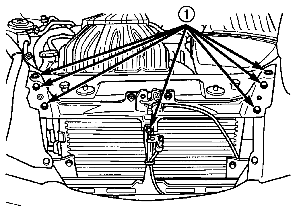

Power steering fluid leaks out of the end cap on the hose. do I need to replace the hose and is it something I can do by myself?
Jan 24, 2019 at 1:40 AM
  • 110,240 POSTS
If you have a little mechanical ability and are able to work in tight spaces, then you should be fine. Since this is a turbo, it is a little more difficult, but you should be okay.
If I recall, the turbo needs removed, but since it is only a hose that is being replaced, you should be able to work around it. However, there are two hoses. Once is a high pressure hose which supplies fluid to the rack and pinion and the other is a return line which is low pressure.
Before you get started, here is a link that shows how in general a power steering pump needs replaced. I realize your problem is a hose, but this will provide a general understanding of removal and replacement of the hoses.
Here are the directions specific for replacing the pump in your vehicle. You will need to follow all the directions except removing the pump itself. To access the hoses, things need to be moved. Most of these directions relate to accessing the components. Additionally, they identify the high and low lines and explain how to replace them. When you reach the end of the directions, I will explain how to bleed the system separately.
All pictures correlate with these directions.
REMOVAL AND INSTALLATION
See Picture 1

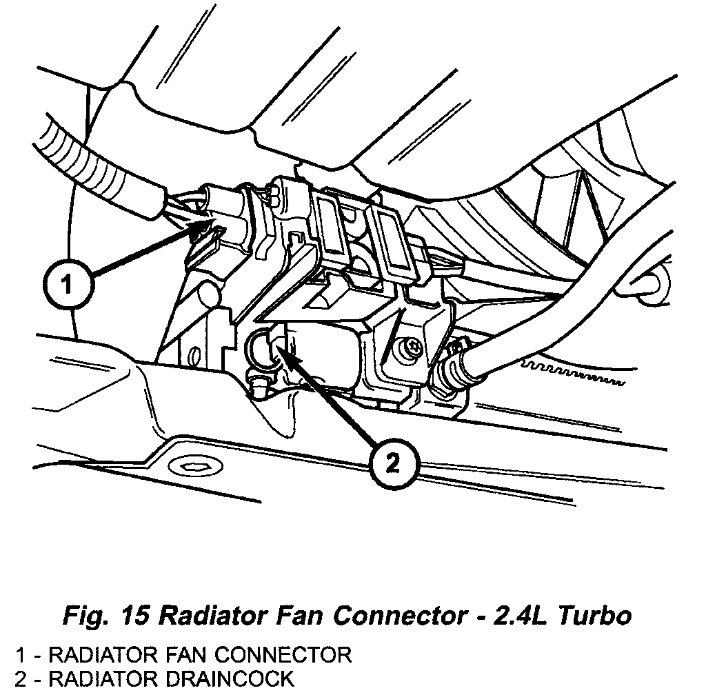

(3)Drain engine coolant. See: Radiator Drain Plug

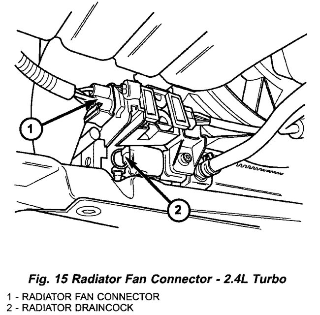

(5)Disconnect radiator fan wiring connector (Fig. 15).

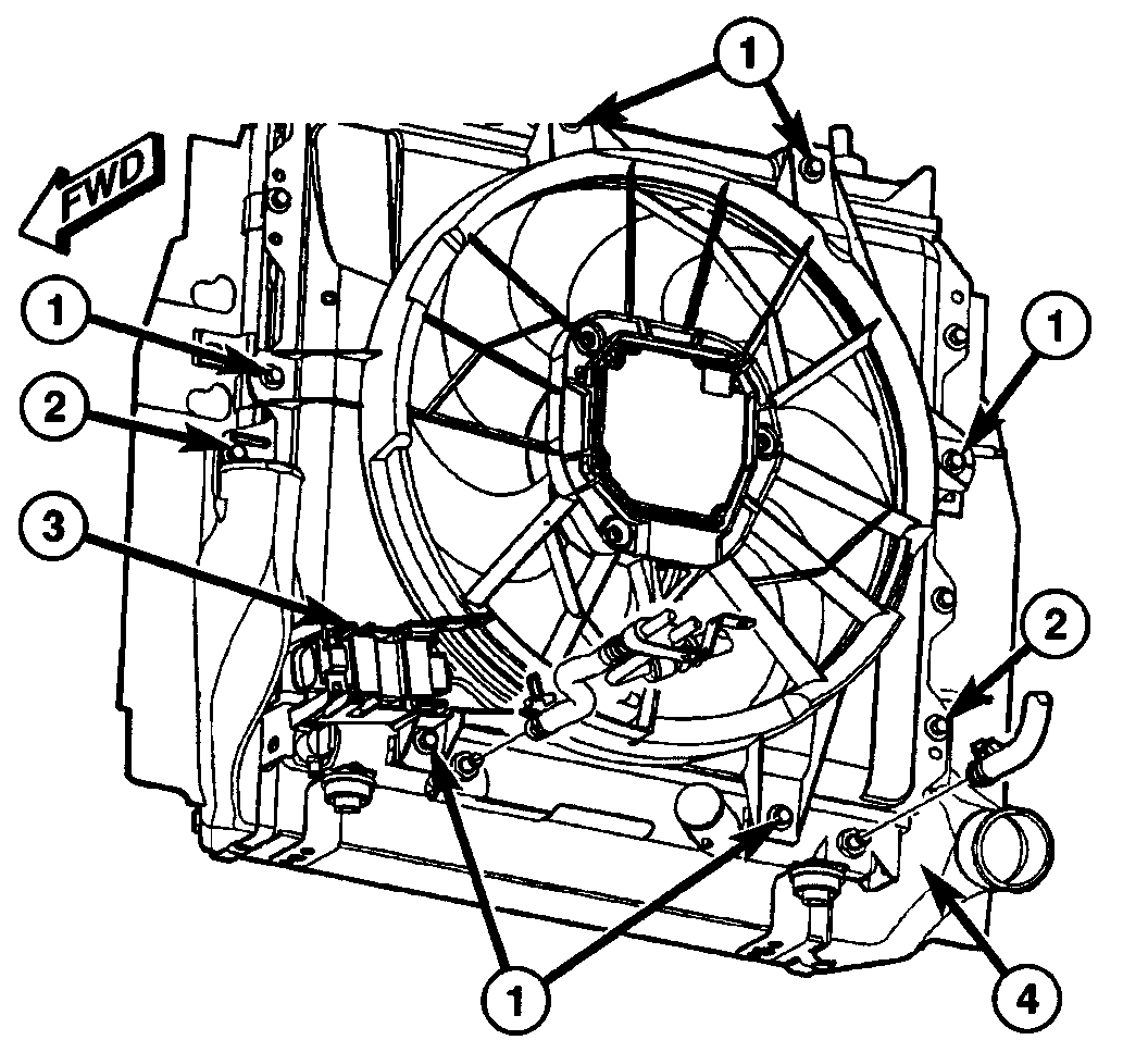

(6)Remove two lower fan mounting screws (Fig. 16).

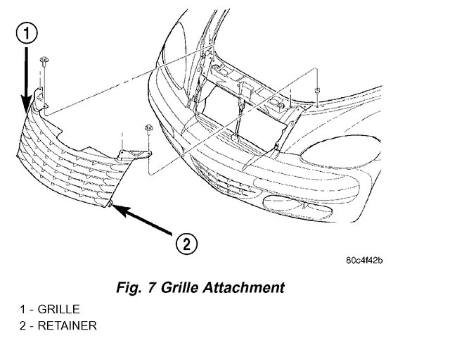

(10)Remove grille from front of vehicle (Fig. 8).
(11)Remove hood-opening weather-strip from across radiator closure panel.

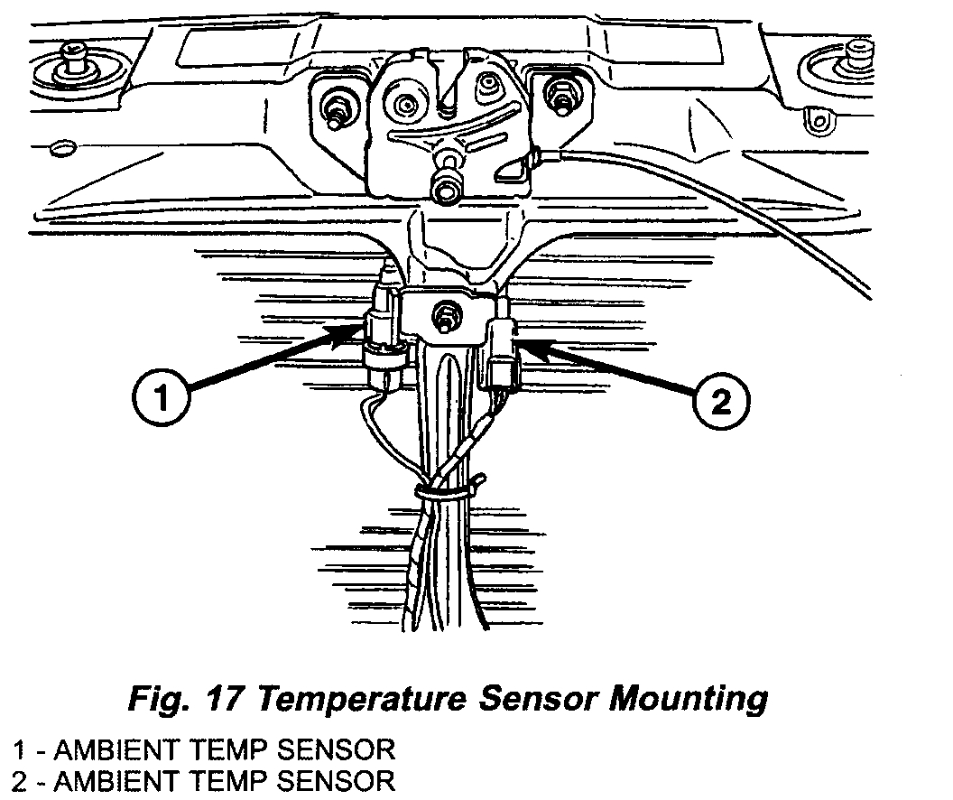

(12)Remove ambient temperature sensors from radiator closure panel (Fig. 17).

Fig. 10 Radiator Closure Panel
(13)Remove fasteners securing upper radiator closure panel in place (Fig. 10), then remove the panel and lay it out of way.

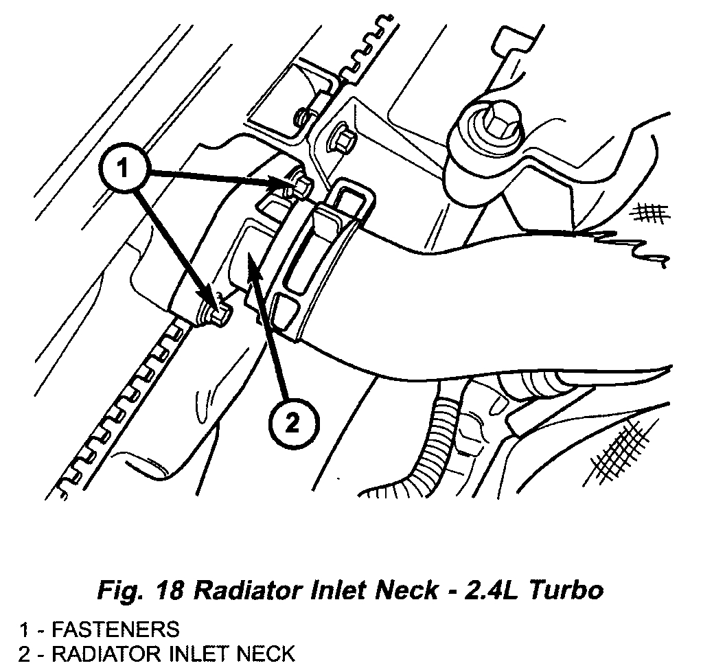

(14)Remove 2 screws fastening upper radiator hose inlet neck to radiator, then separate inlet neck from radiator (Fig. 18).

(16)Remove remaining four screws fastening radiator fan to cooling module (Fig. 16). Remove fan.

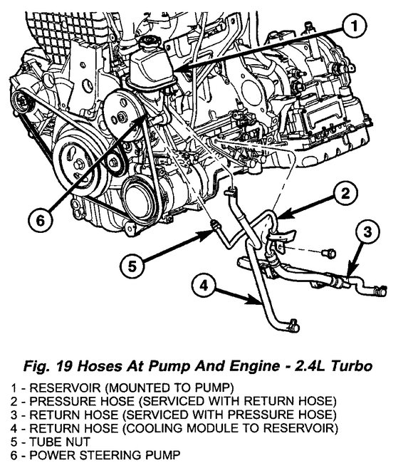

(17)Remove clamp securing fluid return hose to pump reservoir (Fig. 19), then remove hose from reservoir fitting. Cap off hose end and reservoir fitting.
(18)Back out tube nut securing fluid pressure hose to power steering pump and remove hose from pump (Fig. 19). Cap off hose end and pump pressure port.

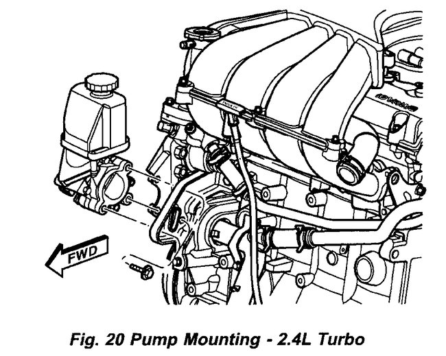

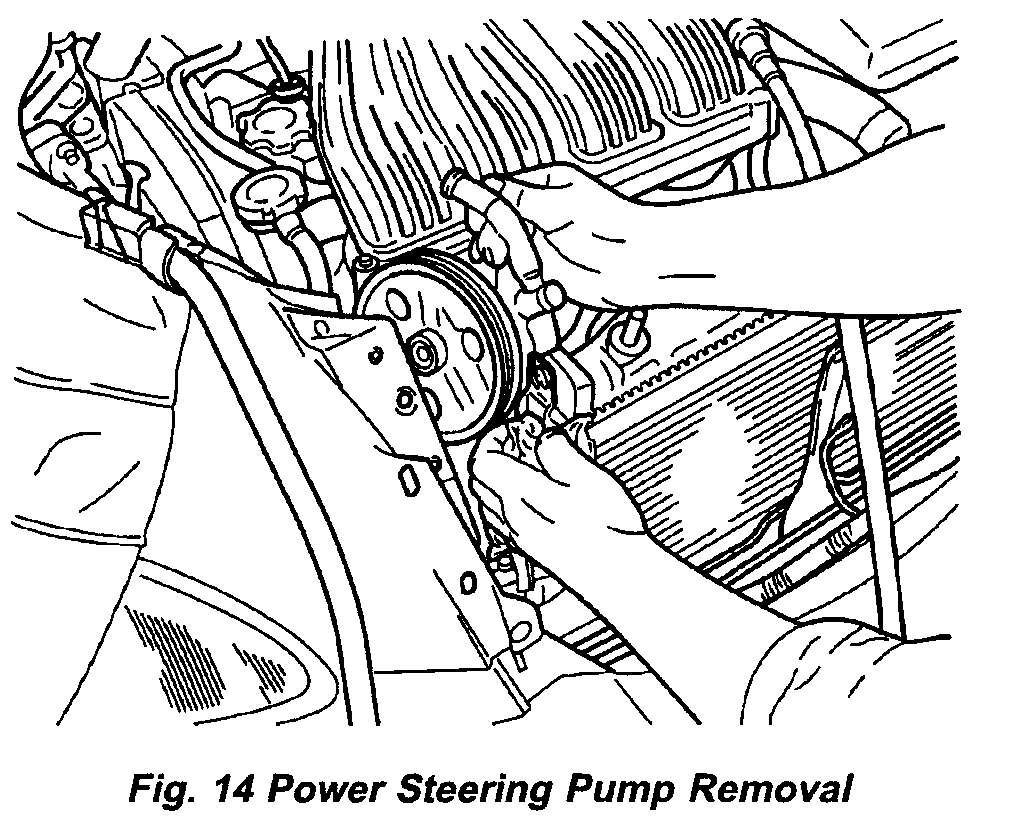

(19)Remove three mounting bolts securing power steering pump in place (Fig. 20).

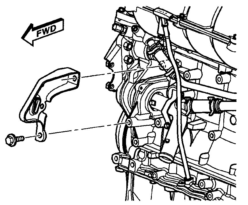

(20)Remove 2 bolts securing stamped steel support bracket to engine block (Fig. 21). Remove bracket.

(3)Place pump in mounting position with stamped steel support bracket behind it. Install three pump mounting bolts through bracket and pump, into threaded engine cover (Fig. 20). DO NOT TIGHTEN BOLTS AT THIS TIME.
(4)Install two bolts fastening support bracket to engine block (Fig. 21). Tighten two bolts to 54 N.m (40 ft. lbs.) torque.
(5)Tighten three pump mounting bolts previously installed (Fig. 20) to 28 N.m (250 in. lbs.) torque.
(6)Thread pressure hose tube nut into pump pressure fitting (Fig. 19). Tighten tube nut to 32 N.m (24 ft. lbs. torque.
(7)Install fluid return hose onto power steering fluid reservoir return fitting (Fig. 19). Expand hose clamp and slide it over hose and pump return fitting. Secure clamp once it is past bead formed into fluid reservoir fitting.

(12)Install ambient temperature sensors on radiator closure panel (Fig. 17).

(14)Install grille on front of vehicle (Fig. 8).

(19)Connect radiator fan wiring connector (Fig. 15).
