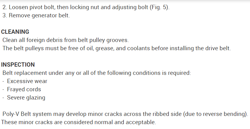

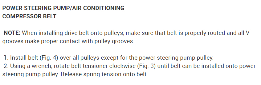

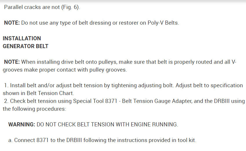

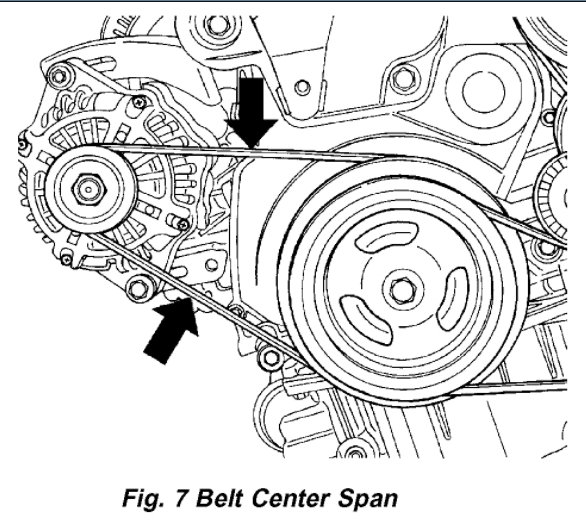

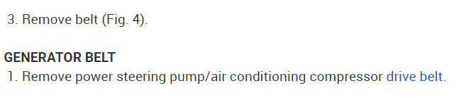

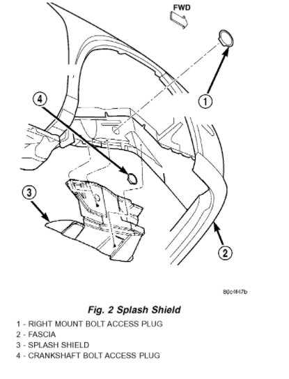

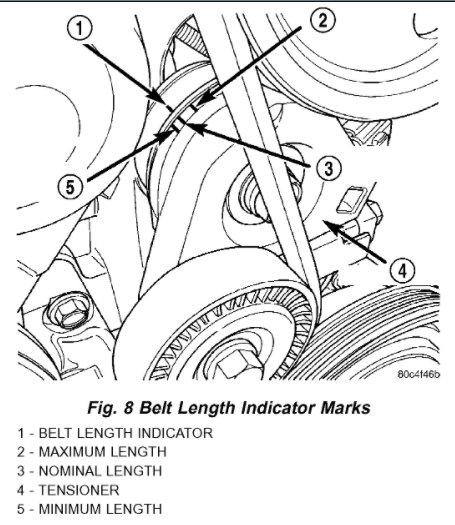

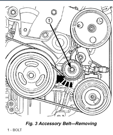

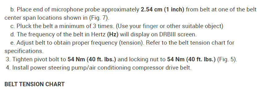

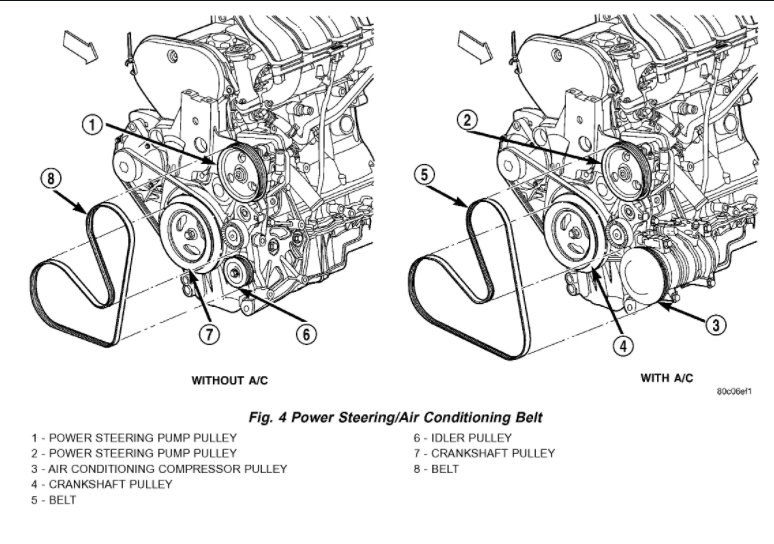

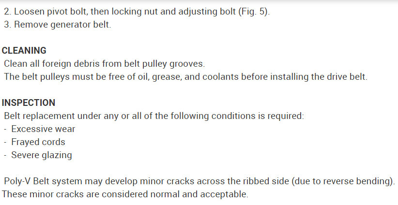

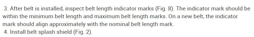

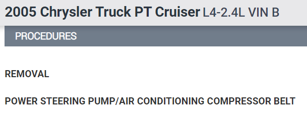

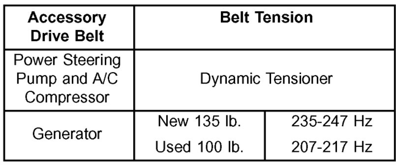

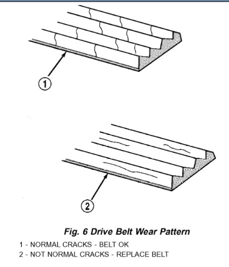

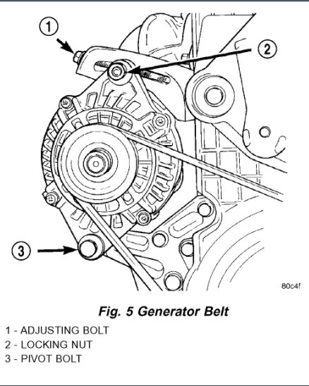

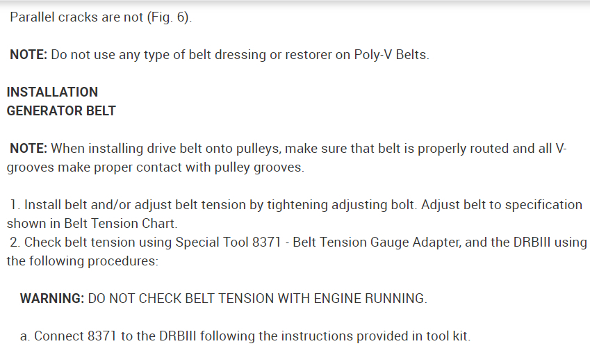

How do I gain access to the belts? And Where can I find a belt routing diagram?
Tuesday, May 20th, 2008 AT 1:58 PM
DANNY L
MECHANIC
5,648 POSTS
Hello, I'm Danny.
Here is a tutorial for you to view on how to replace a serpentine belt:
I've attached picture steps below on how to replace the serpentine belt on your vehicle. Hope this helps and thanks for using 2CarPros.
