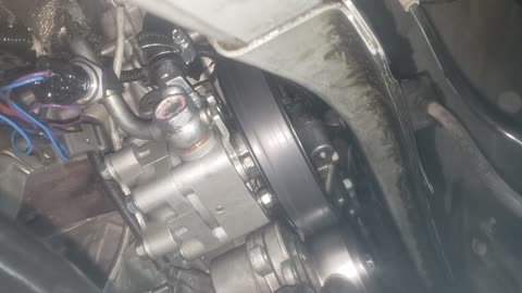

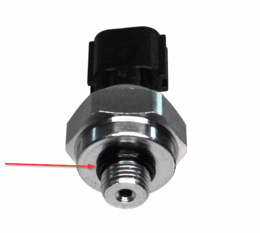

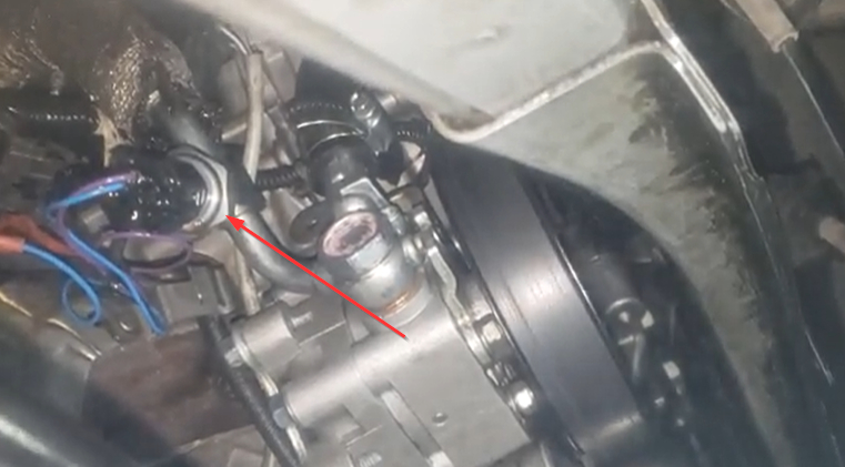

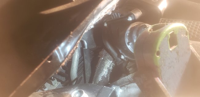

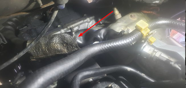

Okay. well, i did that and honestly this pipe has a loose fitting rubber hose around it from start to end that's and i can't see anything coming from.
Sep 22, 2021 at 2:38 AM
VERONICA WIMMS
  • 144 POSTS

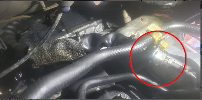

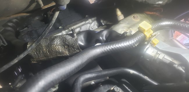

Sorry that cut off. it's covered by a cloth like covering making seeing a leak impossible. however i see fluid wetness at the end of this cloth above the switch leading me to believe it's that line somewhere behind the rubber and cloth and not from the switch after all. what are your thoughts? Below are some pics.
Sep 22, 2021 at 2:45 AM

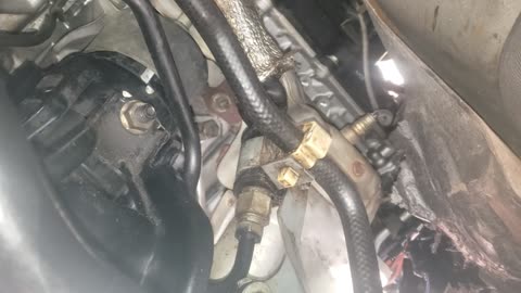

Just to confirm we are talking about the same hose. You are seeing the one I am pointing to with moisture on it? If so, it looks like it is twisted as it should not be collapsed like that.
If you are seeing oil on it, then it needs to be replaced.
Sep 23, 2021 at 2:12 AM
VERONICA WIMMS
  • 144 POSTS
Yes, it's the same one. there's what feels like a metal line inside of it but you say it's not supposed to be collapsed like that though. well, good thing i have ordered it then. should have it by the 30th. so I will let you know from there. thank you so much for all your advice so far.

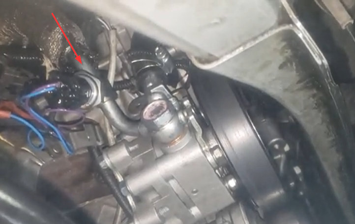

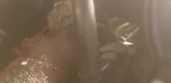

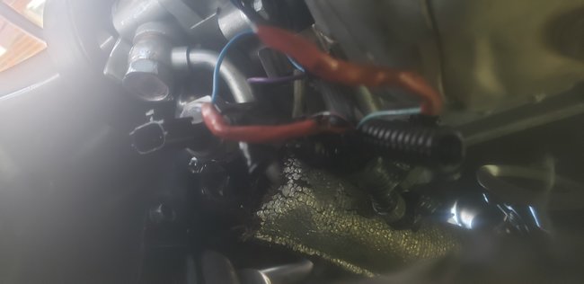

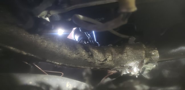

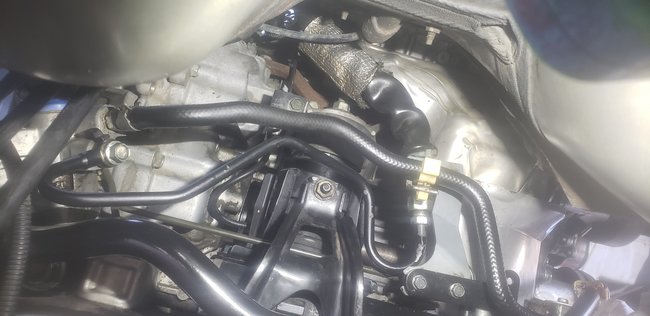

Okay. so, i got the line disconnected at both ends but up at the top behind I'm guessing is the manifold its connected to it somehow by 1 or more bolts. i have included pics that a size 11 socket fits on but there's not enough room for a ratchet and a wrench can't get to. any suggestions? blew up the 2nd pic to see the bolt the 1st is showing the approximate location.
Sep 29, 2021 at 10:36 PM
VERONICA WIMMS
  • 144 POSTS
Do i need to remove this or do you have any instructions? my Haynes repair manual doesn't even talk about this line other than just disconnecting the end to the pump.
Sep 29, 2021 at 10:38 PM
Yep. That bolt is going to secure the line so that it doesn't move around as it is most likely the pressure line.

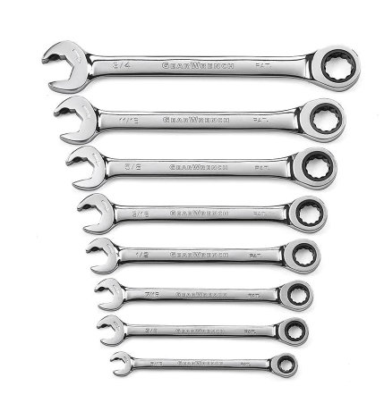

The only suggestion I can make is to use an electric or air powered ratchet. That way you don't need to have any excess room. Short of that, you will need a gear ratcheting box end wrench with very fine teeth so that you can use the small amount of room you do have to get it to remove it.
I put pictures for both below.
Sep 30, 2021 at 8:44 AM

I was planning on buying 1 of the ratchets but i tried 1of the wrenches and can't get it on there isn't that the back of the exhaust manifold where that bolts at.
Sep 30, 2021 at 10:27 PM

And would a cordless 1 work verses the air kind?
Sep 30, 2021 at 10:28 PM
Cordless is fine. You will need to use swivel sockets and extensions to get the proper angle if it won't fit directly onto the nut.

So i can tell this bolt seems to only go through the foil looking outer covering of the line by the top. can't i just cut that off?

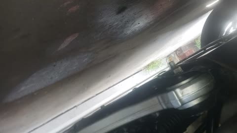

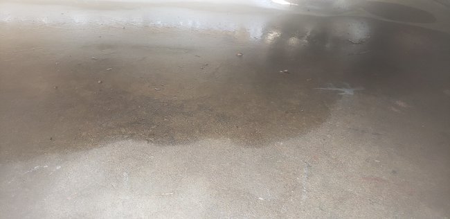

Okay, well I don't know if i said it before but on the high-pressure hose connection on the driver's side i dropped 1 of the new washers into the frame and so i used an old 1 in its place and drove it. few days noticed a small leak under that side so i took it to a shop had them look at it they said it was fine probably just old fluid burning off. a few days later there's a puddle on the passenger side. I've been working on so after having it looked at by another place, they say it's the rack leaking zo my? Now is this could the small ds leak be from the used washer and the ps b from the pump not being on completely right the ds never leaked before the line change or do you agree with the second shop it's my rack needing replaced?
Oct 27, 2021 at 4:14 AM
I highly doubt that a used washer is causing the issue. That doesn't mean that this line or connection is not leaking but I have reused these washers and not had any issue. So, if you have someone else saying that the rack is leaking then I would suggest having them put it on the lift and then show you where they are seeing the leak. This way you can tell for sure what the issue is.
