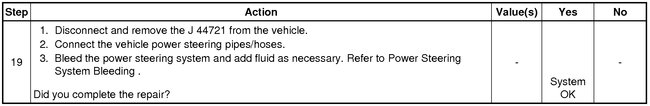

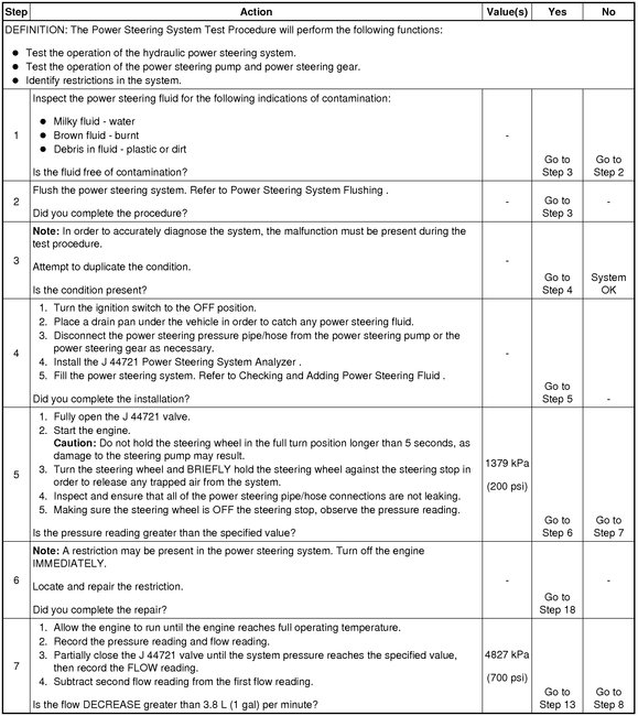

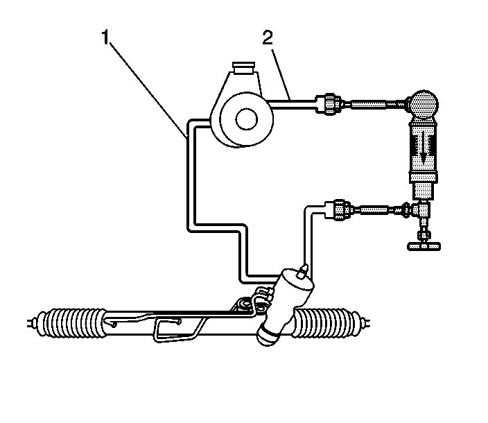

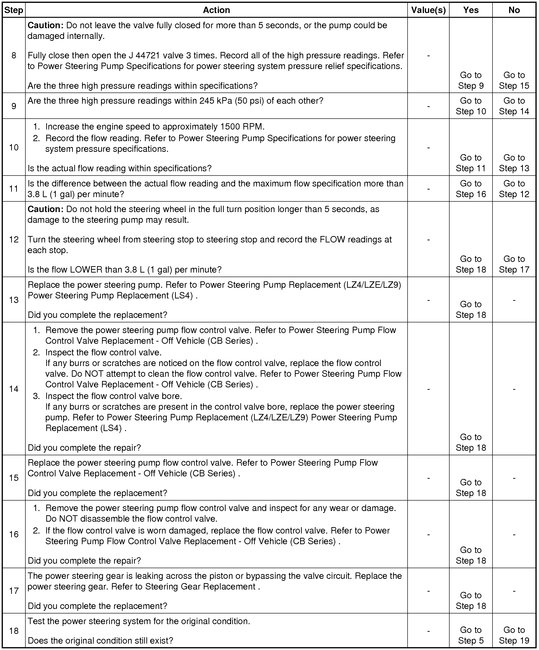

Here are the diagnostics. Let me know if it is something you feel comfortable doing. The attached pics are the actual diagnostics.
_________________________________________________________
2009 Chevrolet Impala V6-3.5L
Power Steering System Test
Vehicle Steering and Suspension Steering Testing and Inspection Symptom Related Diagnostic Procedures Power Steering System Test
POWER STEERING SYSTEM TEST
pic 1
pic 2
1 - Power Steering Return Hose
2 - Power Steering Pressure Hose
Test Description
The numbers below refer to the step numbers on the diagnostic table.
5. This step tests the system for restrictions.
7. This step tests the following components for the following conditions:
* The pump for internal leaks
* The power steering pipes for kinks
8. This step tests the ability of the pump to regulate flow at maximum pressure.
10. This step tests the ability of the pump to regulate flow under normal operating conditions.
12. This step tests the internal components of the pump and the gear.
