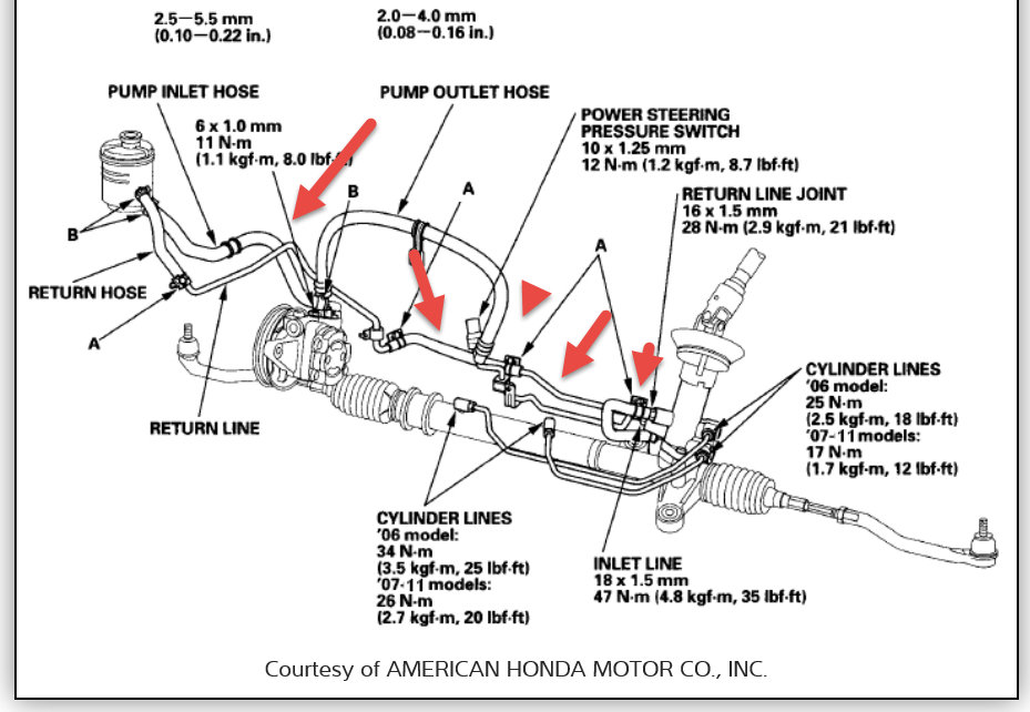

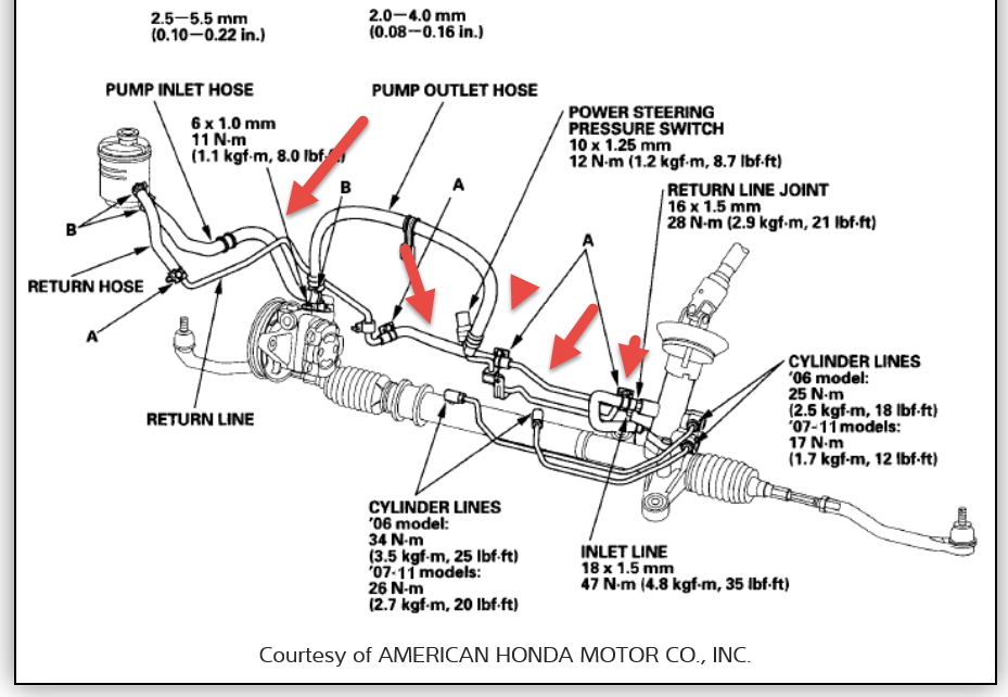

Every time i turn my steering wheel my fluid starts pouring out on the passenger side of engine compartment (right side, U.S). i have looked for diagrams with no luck. i have also posted on the specific civic forum and received no help. maybe it is an obvious problem, but i am having trouble finding the high pressure hose and all related to the system.
any help or images would be greatly appreciated.
Jul 17, 2017 at 3:50 AM
HMAC300
  • 48,601 POSTS
See picture this is for a car that is not hybrid. Also, if you have EPS or electric power steering this is not for you your car. Check clamps as well as for holes in hoses etc.
