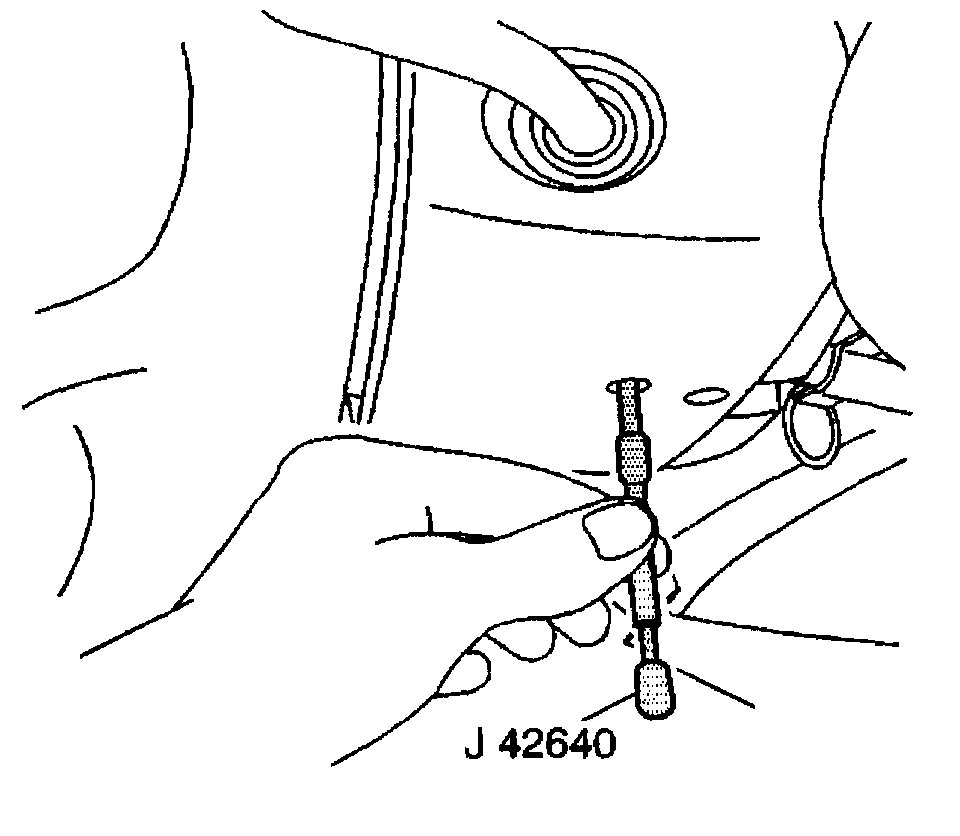

1. Lock the steering column through the access hole in the steering column lower trim cover using the J 42640.

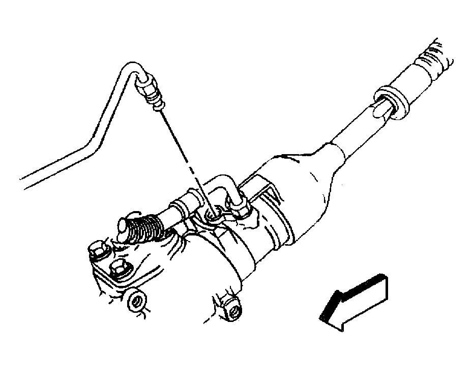

2. Remove the air cleaner assembly. Refer to Air Cleaner Outlet Resonator Replacement in Powertrain Management.

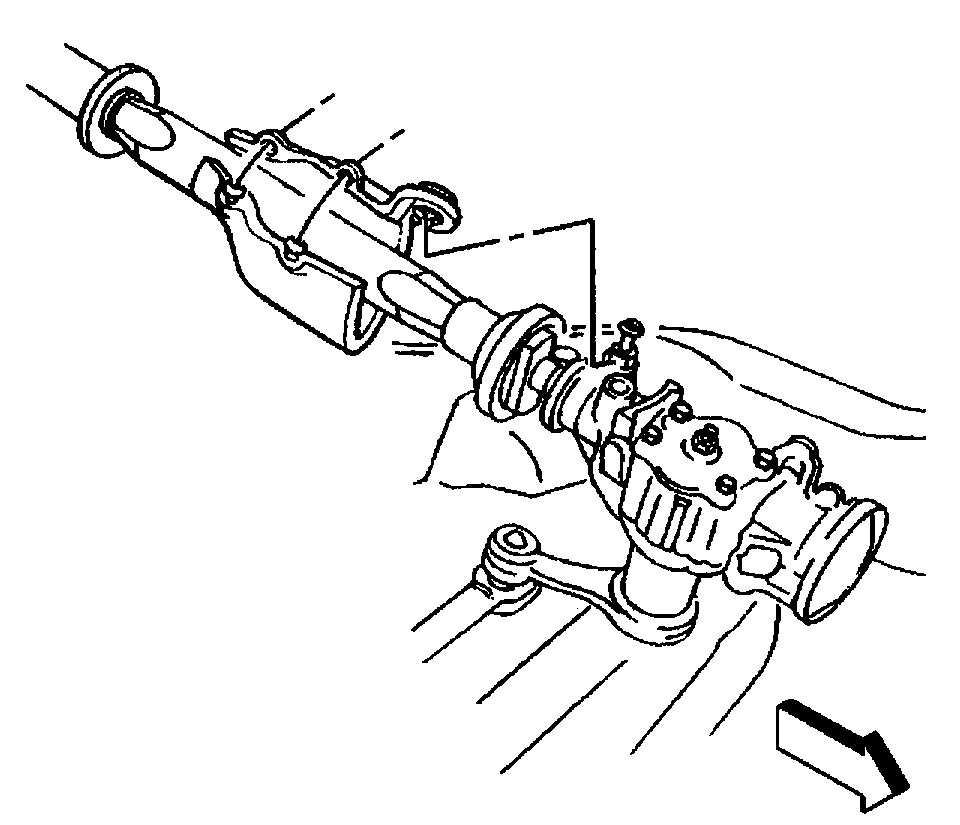

3. Remove the intermediate shaft shield from the steering gear.

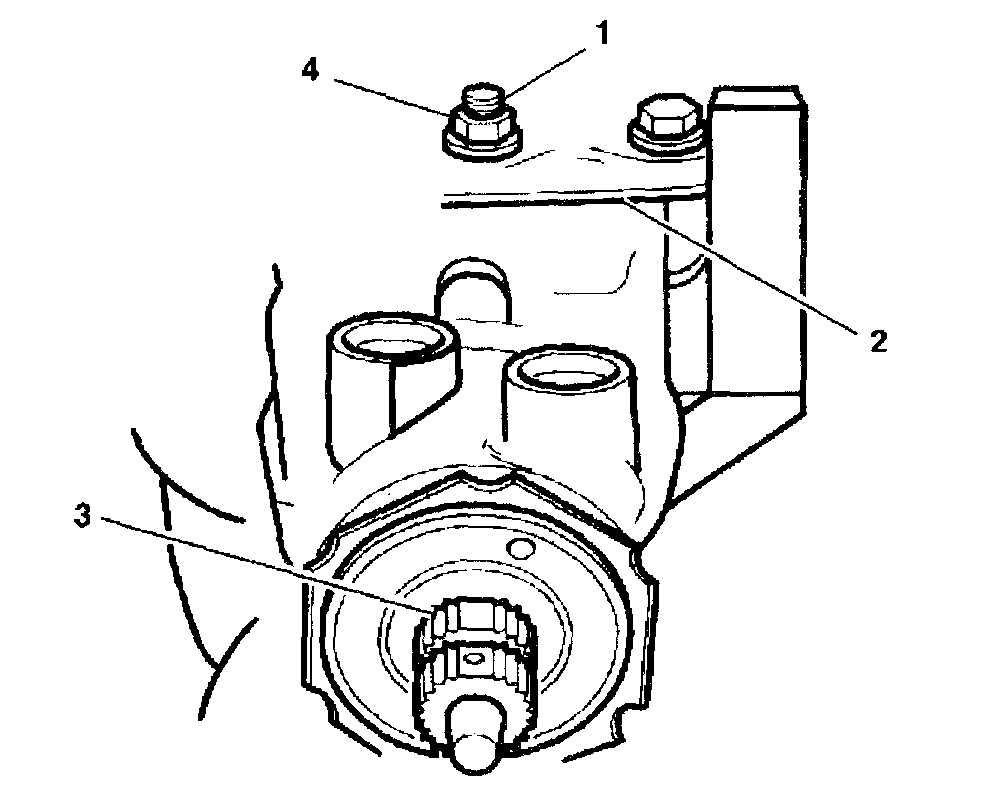

5. Remove the pressure and the return hoses from the power steering gear.
Cap or tape the ends of the hoses and the gear fittings in order to prevent dirt from entering the system.
pic 4

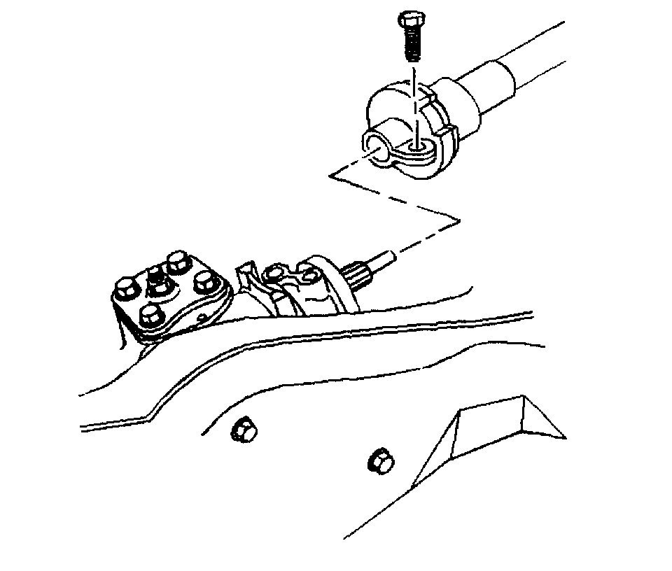

6. Remove the lower intermediate shaft coupling bolt.
7. Draw alignment marks on the lower intermediate shaft coupling and the steering shaft.
8. Remove the lower intermediate shaft coupling from the steering shaft.

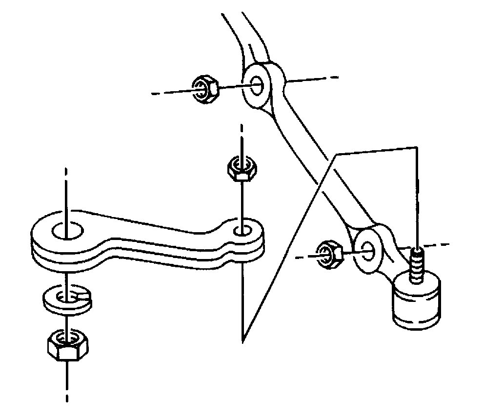

9. Remove the pitman arm. Refer to Pitman Arm Replacement.
pic 5

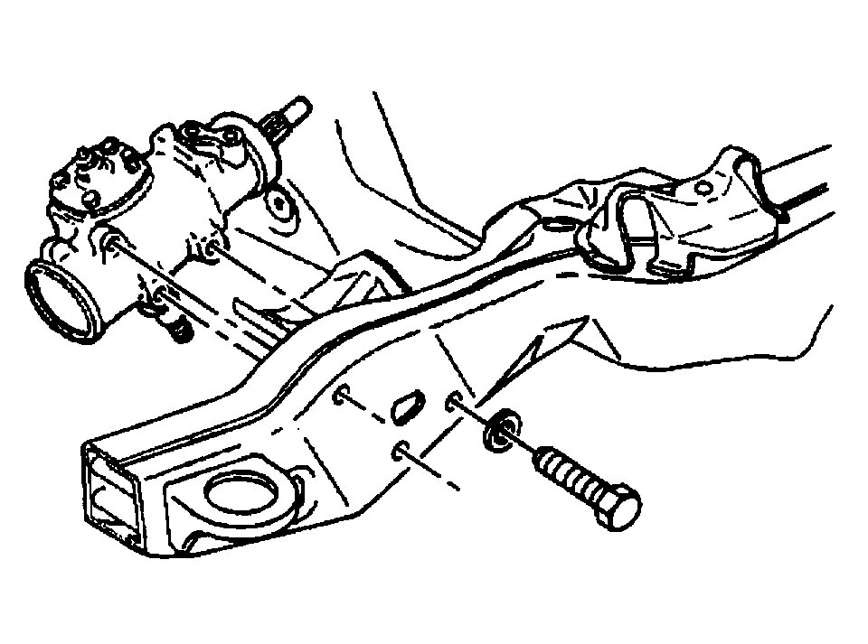

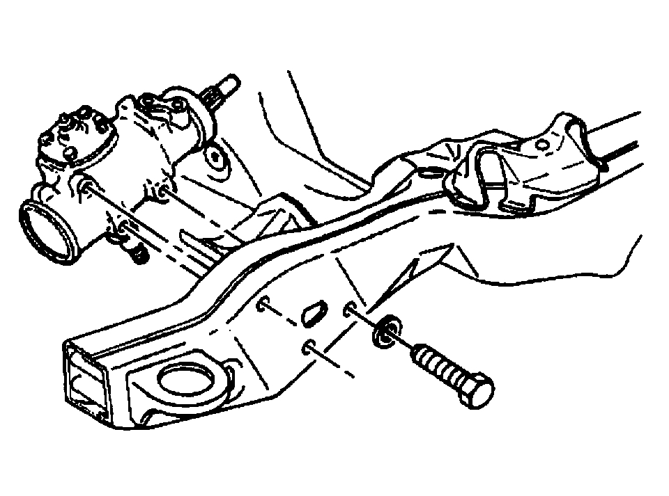

10. Remove the steering gear mounting bolts and the washers from the frame.
11. Remove the steering gear.

2. Install the power steering gear to the frame washers and the mounting bolts.
Tighten
Tighten the power steering gear to frame mounting bolts to 75 Nm (55 ft. lbs.).

pic 7
4. Install the lower intermediate shaft to the power steering gear.
Ensure that the alignment marks line up.
5. Install the lower intermediate shaft coupling bolt.
Tighten
Tighten the lower intermediate shaft coupling bolt to 35 Nm (26 ft. lbs.).

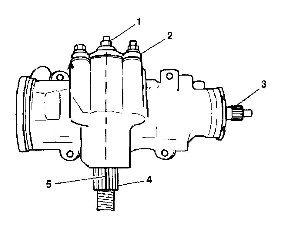

pic 11
1. Adjust the worm shaft and valve, refer to: Worm Thrust Bearing Preload Adjustment - Off Vehicle.
2. Rotate the stub shaft (3) back and forth to drain the power steering fluid.
3. Loosen the adjuster lock nut (4).
4. Turn the pitman shaft adjuster screw (1) counterclockwise until the screw is fully extended.
5. Turn the pitman shaft adjuster screw (1) clockwise 1 full turn.
6. Rotate the stub shaft (3) from stop to stop using a 12-point socket while counting the number of turns.
7. Starting at either stop, turn the stub shaft (3) back half of the total number of turns. This is the center of the gear.

8. Make sure that the gear is centered by checking the following items:
- The flat on the stub shaft (3) faces upward.
- The flat on the stub shaft (3) is parallel with the side cover (2).
9. Align the master spline (5) on the pitman shaft (4) with the adjuster screw (1).

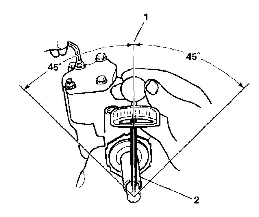

10. Place a torque wrench on the stub shaft (2) with the handle in the vertical position.
11. Rotate the stub shaft (2) 45 degrees from each side of the center of the stub shaft. The stub shaft (2) must rotate smoothly.
12. Record the worm bearing preload measured on or near the center (1). The recorded bearing preload must be 0.7 - 1.7 Nm (6 - 15 inch lbs.) with the worm and the ball nut installed. If the torque is outside of this range, readjust or repair the steering gear assembly as required.

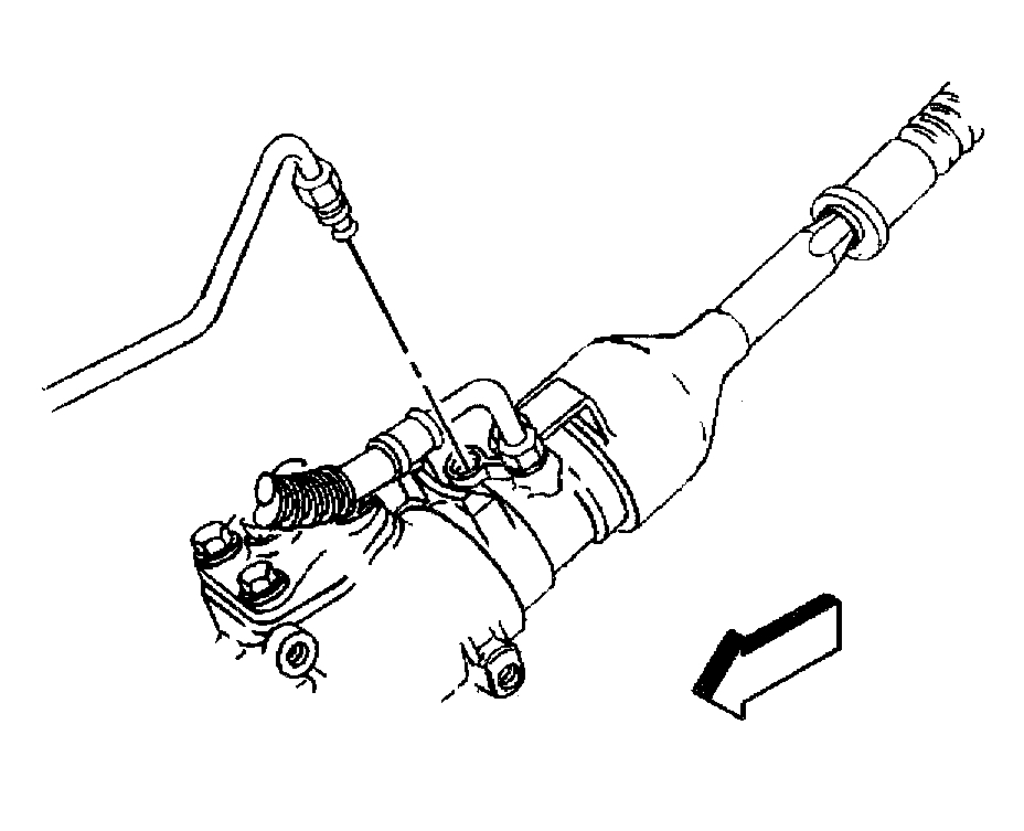

I'm a little in disbelief that it needs a new gearbox. The steering is sloppy, but I can move the steering shaft by hand under the hood, of course i can't move the wheels but the steering shaft moves back and forth under the hood. Would that mean it's the rag joint?
Mar 15, 2020 at 9:05 AM
  • 110,243 POSTS
It could be, but are you seeing movement at the gear and the wheel not moving? Keep in mind, there are many components on this vehicle that can cause a loose feel. Make sure the pitman arm is tight, idler arm and so on.

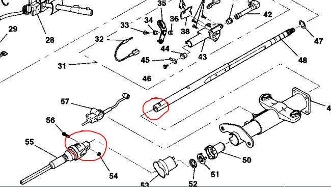

There is a coupler for the steering shaft. You could check that for play. See pic 1.

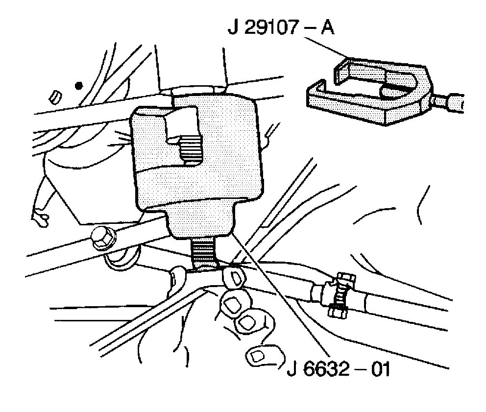

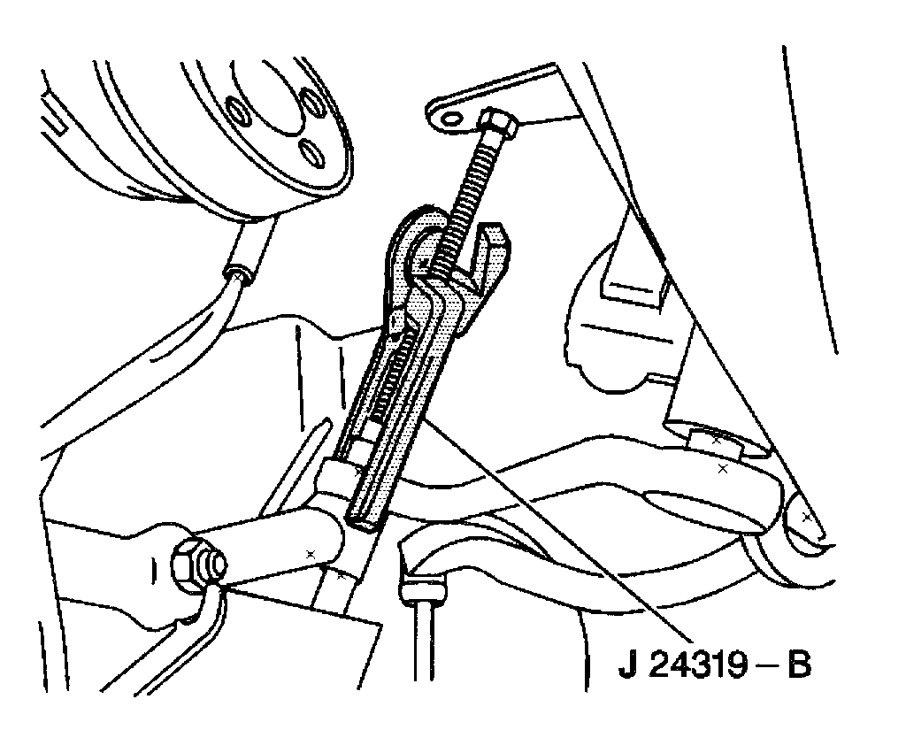

So I got the nut off but that didn't help me any because the arm is frozen to the shaft. I tried using a pit-man arm puller to get it off but it didn't even budge. So i removed the gear from the vehicle with the arm still attached. Any ideas to get it off? I don't have a shop press.
Mar 17, 2020 at 9:54 AM
  • 110,243 POSTS
Heat the pit-man arm so it expands while the puller is on it. Then when it gets hot, (hit the arm only near where it mounts with heat), the puller should work. It isn't a bad idea to tap it with a hammer to help loosen corrosion while you have tension on it.

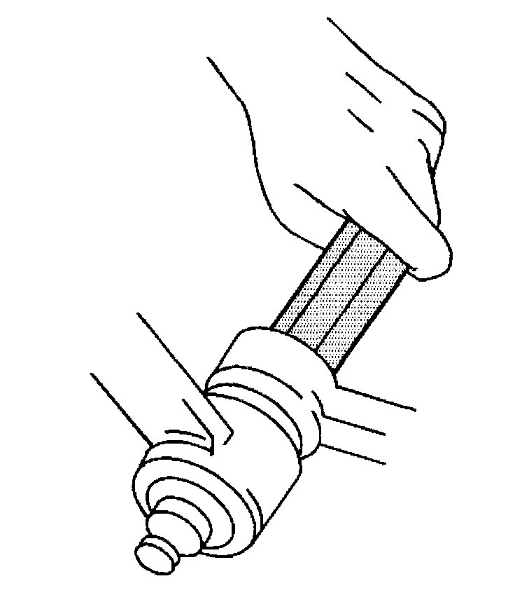

Before taking it off, mark it. Place a mark on the shaft and arm that you can align. Make sure the steering wheel is straight and the front tires are also otherwise, you will have a steering wheel that will be off center when going straight.
You know, it's been awhile since I had one of these apart, but for some reason I remember one of the splines was missing on the shaft only allowing it to go on one way. Please don't quote me on that, but it just popped into my head.

pic 1
1. Raise and suitably support the vehicle. Refer to Vehicle Lifting.
Important: Use the proper tool in order to remove the relay ball stud nut.
2. Remove the relay rod ball stud at the pitman arm.
pic 2
3. Remove the relay rod ball stud from the pitman arm using J 24319-B.
Notice: Do not hammer on the pitman arm, pitman arm shaft or puller. Damage to the pitman arm or steering gear may result.
4. Remove the pitman arm nut and washer from the steering gear.
pic 3
5. Remove the pitman arm from steering gear using J 6632-01 or J 29107-A.
6. Inspect the ball stud threads for damage.
7. Inspect the ball stud seals for excessive wear.
8. Clean the threads on the ball stud and the ball stud nut.

1. Install the pitman arm to the pitman arm shaft.
Notice: Refer to Fastener Notice in Service Precautions.
2. Install the pitman arm washer and nut to the pitman arm shaft.
Tighten
Tighten the pitman arm shaft nut to 250 Nm (185 ft. lbs.).

Well, the shaft going to the steering column has a flat spot so that it goes into the coupler only one way. But the shaft where the pit-man arm goes just has 12 or 16 splines, I don't see any kind of orientation or how to compare the orientation to the new steering gear.
Mar 17, 2020 at 10:06 PM
  • 110,243 POSTS
All you can do is try centering everything. It may require an alignment to straighten the steering wheel when done.

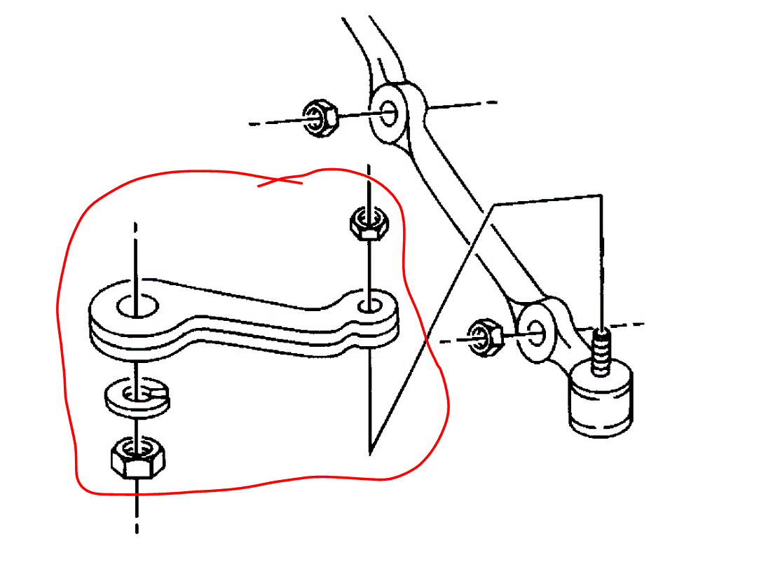

Is there any play in the anything in the front end? The coupling on the steering shaft is tight, correct?
Mar 19, 2020 at 11:07 AM
CANNON1349
  • 861 POSTS
Not to what I can see. The only thing original to the suspension right now is the idler arm. The coupling is bolted as tight as I could get it. But again, I can wiggle the shaft by hand.
Mar 19, 2020 at 11:08 AM
  • 110,243 POSTS
That can cause an up and down issue and you can feel play. How far do you have to turn the steering wheel before you see the wheels start turning?
Mar 19, 2020 at 11:12 AM
CANNON1349
  • 861 POSTS
Maybe an inch or two.
Mar 19, 2020 at 11:13 AM
  • 110,243 POSTS
That's really isn't too excessive on this type of vehicle. Try replacing the idler arm. I have a feeling that will tighten it up for you.
Let me know if that takes care of it. Chances are that is the cause of what you are experiencing. Is it tighter than it was?
