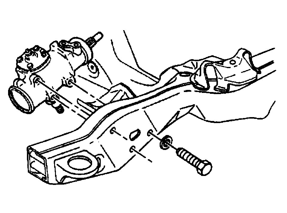

I have a 96 Sonoma 2.2cc two wheel drive. the problem is the steering won't center, I can go round a curve in the road and let go of the steeringwheel and it will keep turning, the steering is a little on the stiff side but it fells like the power steering is working.

could be a number off any suspension parts wore. brakes could be dragging, tire could be low, or it needs an alignment.

it maybe a busing in the power sttering rack.

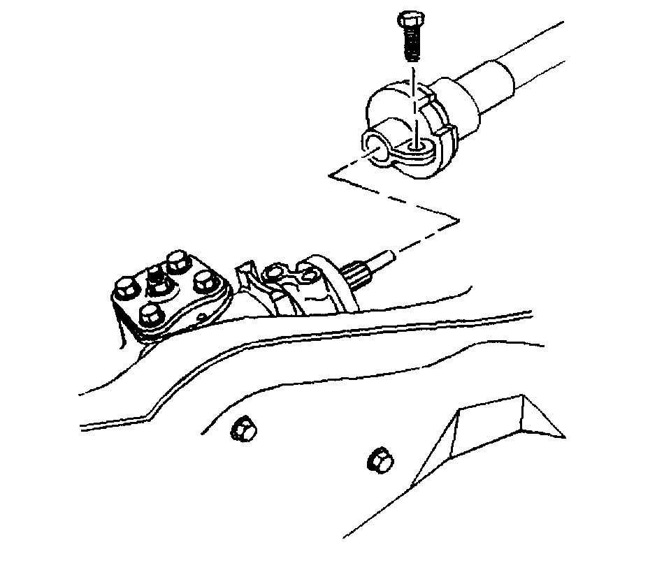

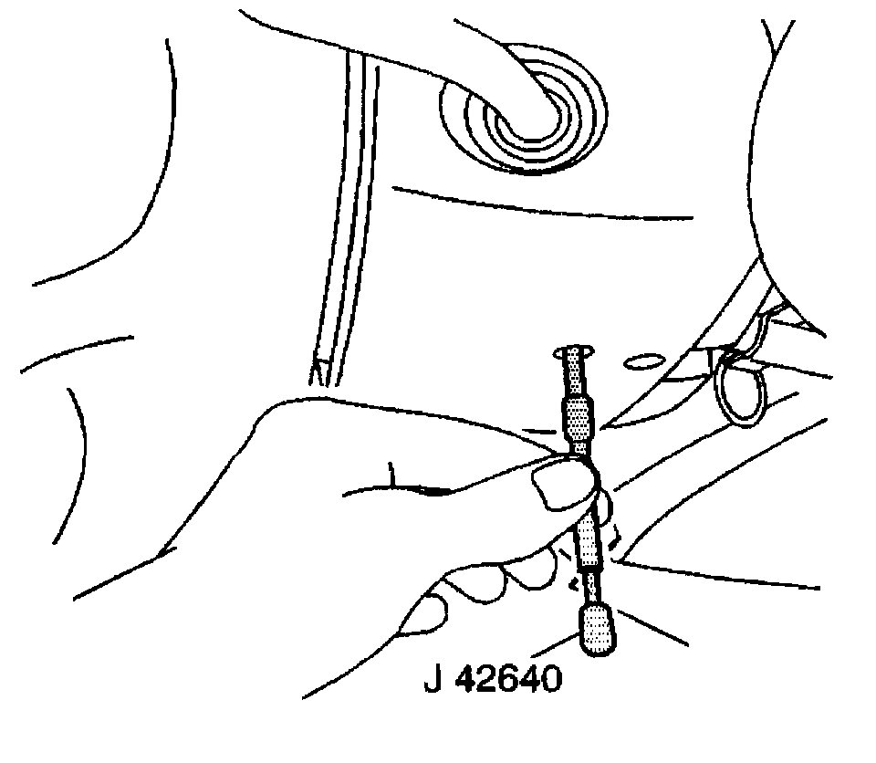

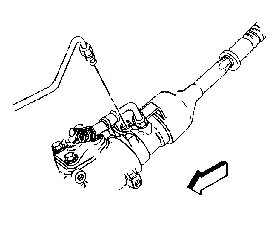

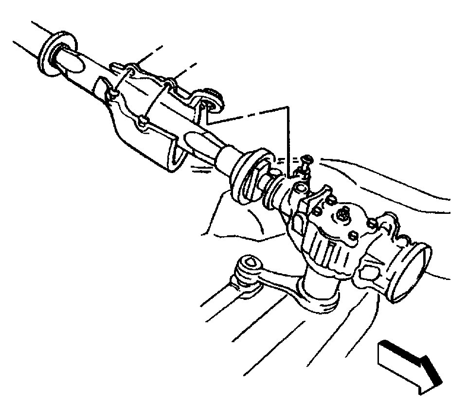

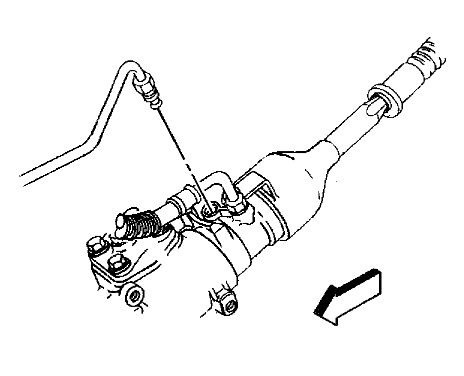

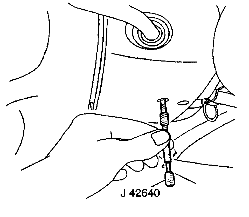

You can try adjusting, but it usually doesn't work. Here are the directions for replacement. The attached pictures correlate with the directions.

- Tools Required
- J 42640 Steering Column Anti-Rotation Pin
Removal Procedure
Notice: Do not rotate steering shaft after steering column has been removed. Damage to SIR components may occur.
pic 1
1. Lock the steering column through the access hole in the steering column lower trim cover using the J 42640.

3. Remove the intermediate shaft shield from the steering gear.
pic 3
4. Place a drain pan below the steering gear.
5. Remove the pressure and the return hoses from the power steering gear.
Cap or tape the ends of the hoses and the gear fittings in order to prevent dirt from entering the system.
pic 4
6. Remove the lower intermediate shaft coupling bolt.
7. Draw alignment marks on the lower intermediate shaft coupling and the steering shaft.
8. Remove the lower intermediate shaft coupling from the steering shaft.
9. Remove the pitman arm. Refer to Pitman Arm Replacement.
pic 5
10. Remove the steering gear mounting bolts and the washers from the frame.
11. Remove the steering gear.

1. Install the steering gear.
Notice: Refer to Fastener Notice in Service Precautions.
2. Install the power steering gear to the frame washers and the mounting bolts.
Tighten
Tighten the power steering gear to frame mounting bolts to 75 Nm (55 ft. lbs.).

6. Install the pressure and the return hoses to the power steering gear.
Tighten
- Tighten the pressure hose to 25 Nm (18 ft. lbs.) for the vehicle equipped with the 2.2L engines.
- Tighten the pressure hose to 30 Nm (22 ft. lbs.) for the vehicle equipped with the 4.3L engines.
- Tighten the return hose to 25 Nm (18 ft. lbs.).

pic 10
9. Unlock the steering column by removing the J 42640 from the steering column lower steering column trim cover access hole.
10. Bleed the power steering system. Refer to Bleeding Power Steering System in Steering / Service and Repair.
