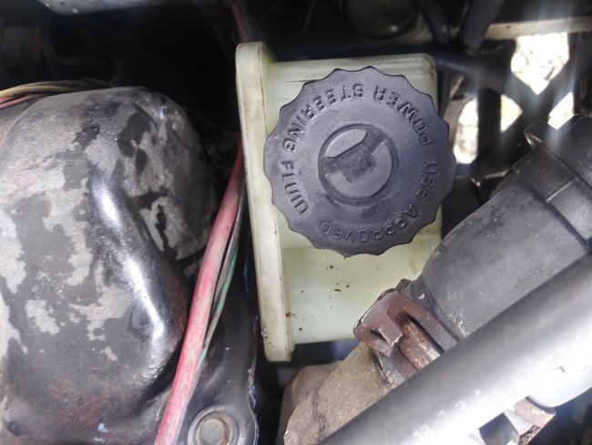

Okay. So, I will be driving and my power steering is smooth and tight with no play in the wheel. Every once in a while it's like I can feel the steering wheel catch for a second or two. I had my bro drive it yesterday So he could feel it because it's hard to explain. He felt it and told me not to worry that maybe there's a stone caught up in there maybe there's build-up of something and then said I have rack and pinion and maybe something is catching or something worn. I don't like maybes. I do know both valve covers had been changed prior to me owning it and the guy did a shoddy job oil had been leaking all over. I have replaced passenger side drivers is next. Also when I first bought it and brought it home I noticed the power steering fluid reservoir was on crooked and power steering fluid had been leaking. I don't know maybe it's nothing to worry about but it's something that just bugs me and I need to fix or find whatever it is. Again the symptoms are wonderful power steering no play in wheel every so often it's like the wheel gets stuck for max 1-2 seconds only while driving.

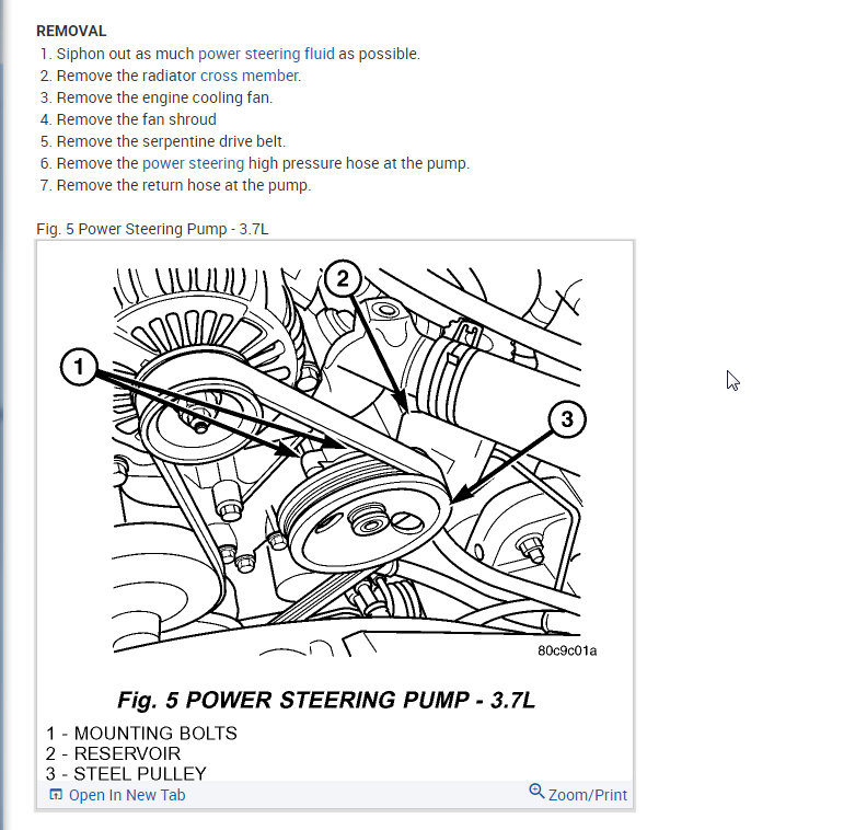

More than likely this sounds like the pump is beginning to fail or the belt is slipping which leaves you will not pressure. Here are some guides that talk about this in a little more detail but if it were me, I would look to replace the pump and retest the operation to see if the issue is gone:
https://www.2carpros.com/articles/power-steering-problems
https://www.2carpros.com/articles/how-to-replace-a-power-steering-pump
The only thing I would consider prior to this is to change the fluid if it is low and dirty. If it is then that can cause different assist issues so that is worth looking at.

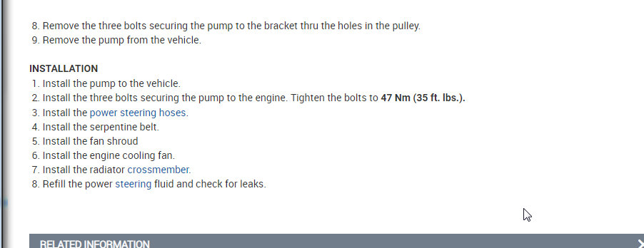

Below is the process from the manual on how to change the pump.
Let me know what questions you have.

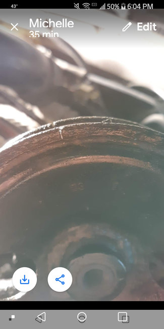

So I am in the process of having pump changed. It's definitely bad also the power steering pump pulley was a mess. I had to order one it will be here in the morning. Might as well change that too before the S belt snaps.

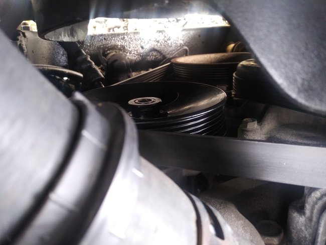

Well, the new pulley was put on and the new pump.Besides being all beat up the pulley was spinning too loose. That belt was bound to come off at some point if it hadn't been changed. The hoses all got blown out/cleaned of dirt and debris. Yeah what a big difference. Those pumps are still kind of noisy on those vehicles though. I can't believe how everything had to come off and out of there to change it. They don't leave much room. Not like when I was younger. You used to be able to sit right up on the engine and work on things, lol. I am just glad the pump and pulley are changed and hopefully if I take it easy won't have to be changed again while I own it. Thanks for all of your support. I'll add some pics when it's light out tomorrow.

There's really no room to get good pictures. I should have taken them before it was put back together. The new pulley picture might need turned around to see it better.
Apr 19, 2021 at 1:36 PM
Yeah. I get that. You are right that one is tight. Thanks for the pictures, they will help others and I am glad you got it taken care of.
