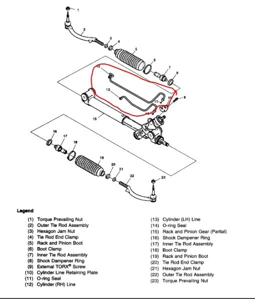

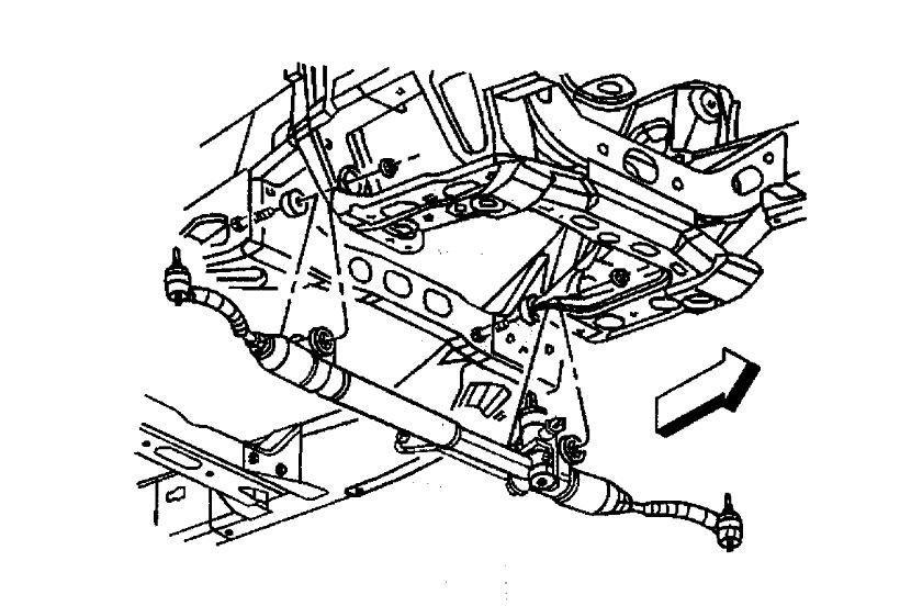

I know the lines are separate for the power steering lines. But the lines on the rack itself seem to be separate from those lines. Can the lines on the rack be replaced?
Jan 22, 2020 at 6:34 PM
Good evening,
The lines on the rack are the steel lines. They are not available from what I see. The rack gets replaced when those lines fail.
My concern is why they failed. They should last the life of the rack. The only way they could fail is if moisture gets into the system and the lines rust out from the inside.

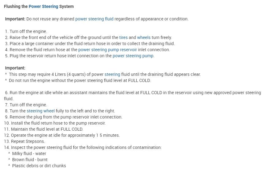

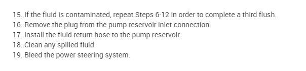

I attached the procedure for flushing the power steering fluid. That should be done every 50,000.
https://www.2carpros.com/articles/power-steering-fluid-flush
Jan 22, 2020 at 7:07 PM

It is a small pinhole on the passenger side and the hose looks very good but it is right in the bend!
Jan 22, 2020 at 7:16 PM
Is it in the hose or the steel line?
Jan 22, 2020 at 7:38 PM
JGATTO22
  • 9 POSTS
Steel line.
Jan 22, 2020 at 7:48 PM
Okay, I would consider replacing the steering rack and flushing the system. There is debris in the system from the rust from the lines.
Power Steering Gear Replacement
Tools Required
J24319-B Steering Linkage and Tie Rod Puller
J44586 Power Steering Gear Oil Seal Remover/Installer
Removal Procedure
1. Raise and support the vehicle.
2. Install a drain pan under the vehicle.
3. Remove the tires and wheels.

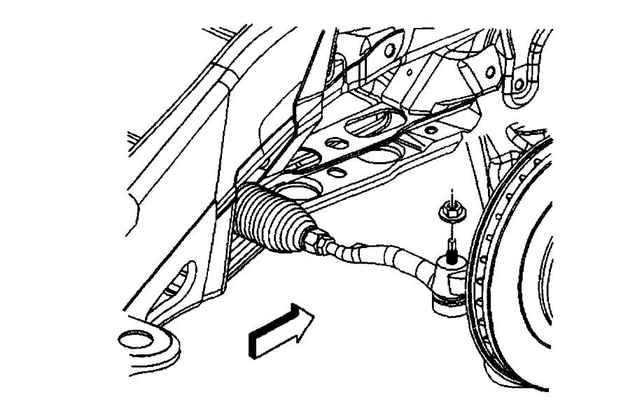

4. Remove outer tie rods retaining nuts.
Notice: Do not attempt to disconnect a steering linkage joint by driving a wedge between the joint and the attached part. Seal damage may result which will cause premature failure of the joint.

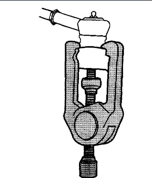

5. Disconnect the outer tie rods from the steering knuckles using J24319-B.

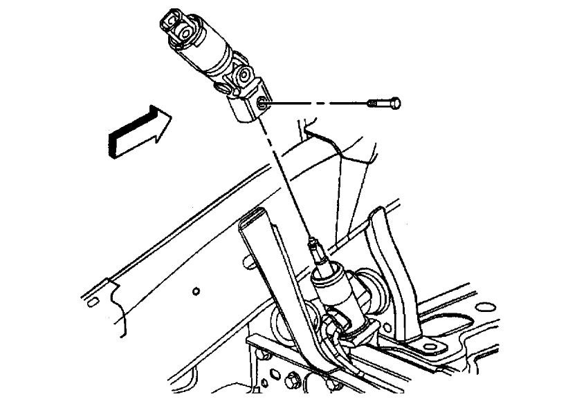

6. Remove the lower intermediate shaft retaining bolt from the power steering gear.
7. Disconnect the lower intermediate shaft from the power steering gear.
8. Remove the steering gear crossmember.

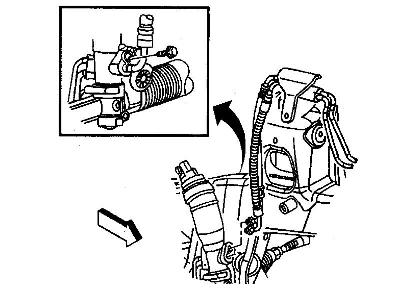

9. Remove the power steering hose assembly to the power steering gear retaining bolt.
10. Remove the power steering hose assembly from the power steering gear.

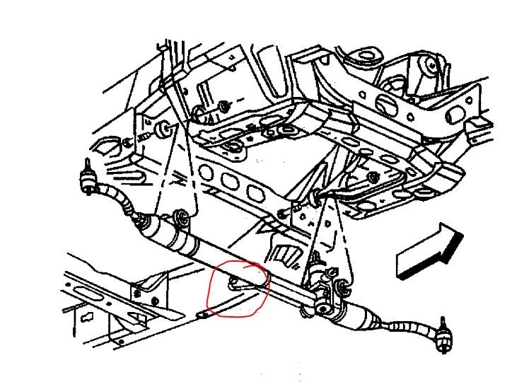

11. Support the power steering gear.
12. Remove the power steering gear mounting bolts.
13. Remove the power steering gear from the vehicle.
14. Remove the outer tie rods (2) from the inner tie rods (3).
Installation Procedure
1. Lubricate the inner tie rod (3) threads with a suitable chassis lubricant before installing the outer tie rod (2).
2. Install the outer tie rods.
3. Install the power steering gear to the vehicle.
Notice: Refer to Fastener Notice in Service Precautions.
4. Install the power steering gear mounting bolts.
Tighten the power steering gear mounting bolts to 110 Nm (81 ft. lbs.).
5. Remove the support from the power steering gear.
6. Install the power steering hose assembly to the power steering gear.
7. Install the power steering hose assembly to power steering gear retaining bolt.
Tighten the power steering hose assembly to power steering gear retaining bolt to 12 Nm (106 inch lbs.).
8. Install the steering gear crossmember.
9. Connect the lower intermediate shaft to the power steering gear.
10. Install the lower intermediate shaft retaining bolt to the power steering gear.
Tighten the lower intermediate shaft pinch bolt to the power steering gear to 40 Nm (30 ft. lbs.).
11. Connect the outer tie rods to the steering knuckles.
12. Install the outer tie rods to steering knuckles retaining nuts.
Tighten the outer tie rods to steering knuckles retaining nuts to 45 Nm (33 ft. lbs.).
13. Install the tires and wheels.
14. Remove the drain pan from under the vehicle.
15. Lower the vehicle.
16. Bleed the power steering system.
17. Adjust the front toe.
