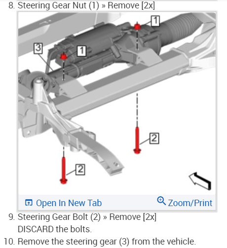

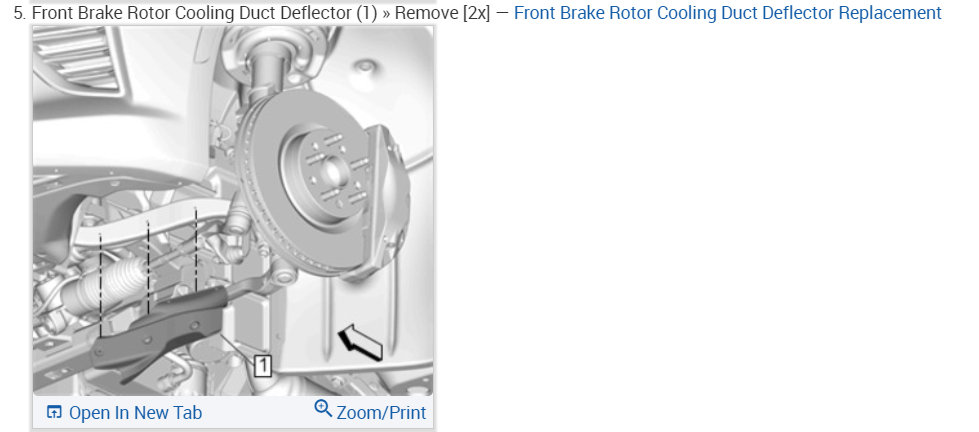

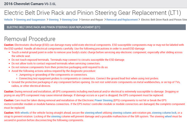

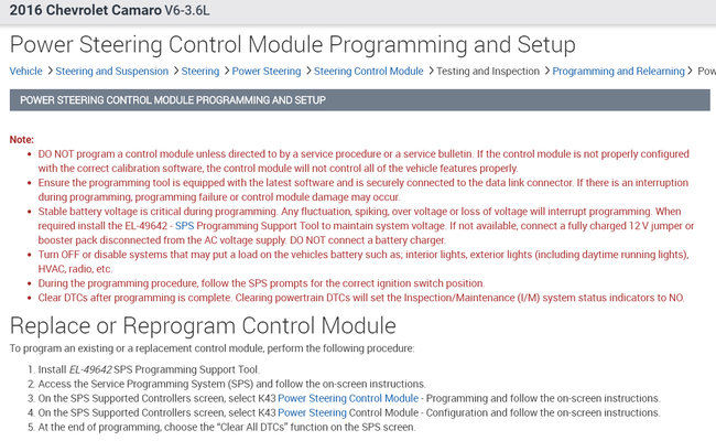

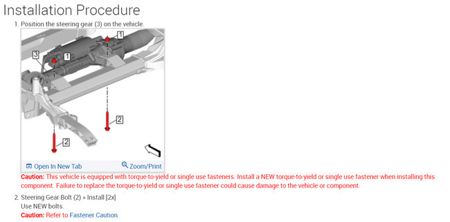

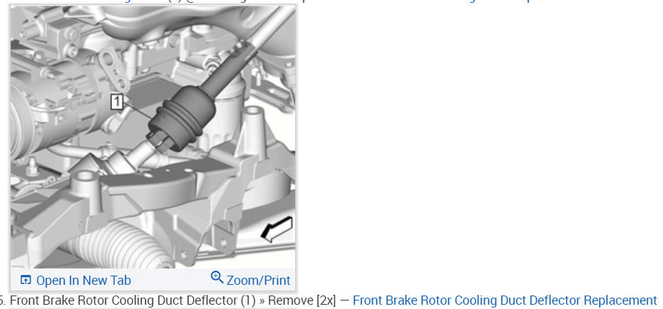

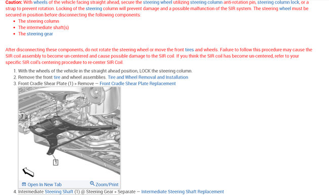

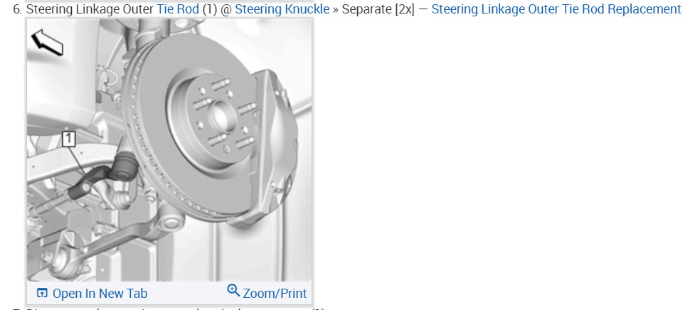

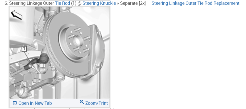

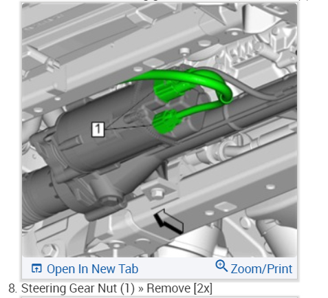

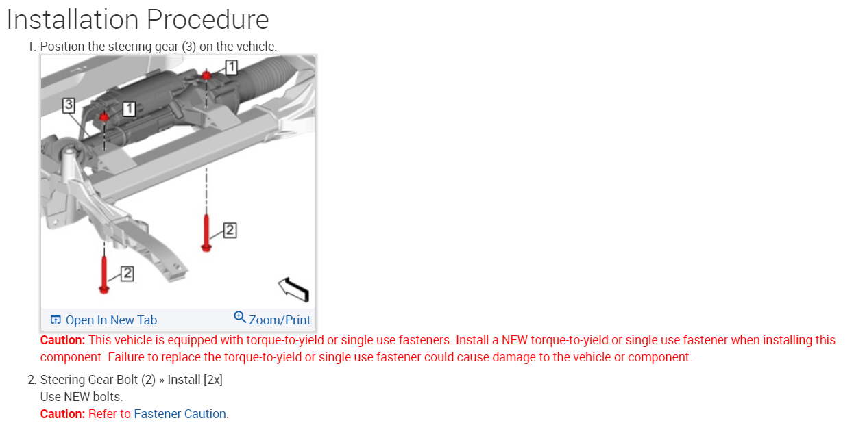

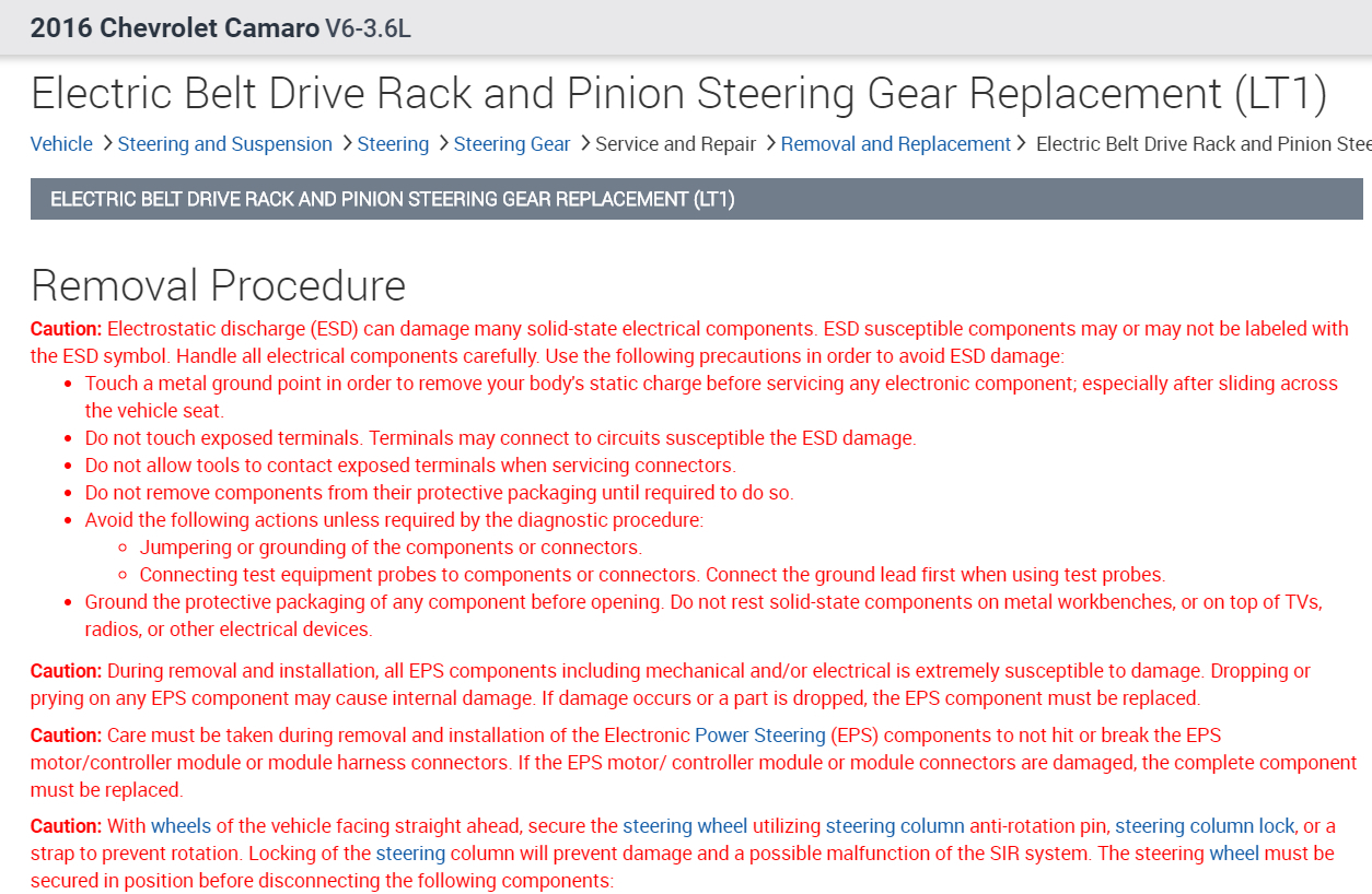

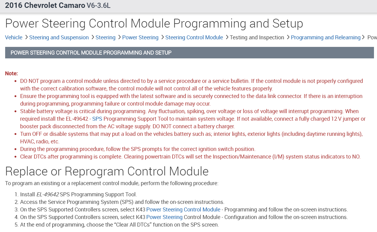

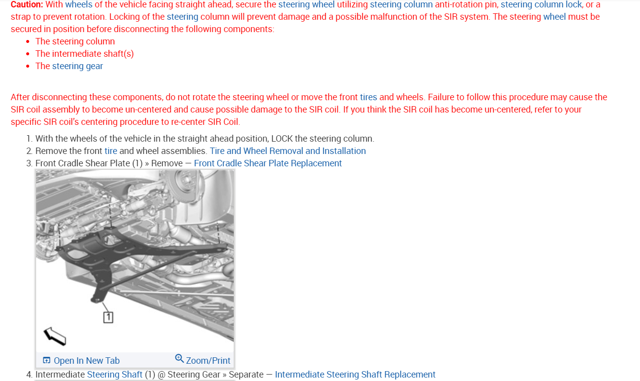

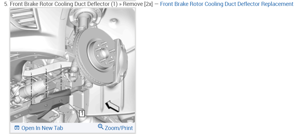

I have heard of the steering racks going out and it might need to be programmed, Here are the programming and replacement instructions in the text and diagrams below.
Note:
DO NOT program a control module unless directed to by a service procedure or a service bulletin. If the control module is not properly configured with the correct calibration software, the control module will not control all of the vehicle features properly.
Ensure the programming tool is equipped with the latest software and is securely connected to the data link connector. If there is an interruption during programming, programming failure or control module damage may occur.
Stable battery voltage is critical during programming. Any fluctuation, spiking, over voltage or loss of voltage will interrupt programming.
Turn OFF or disable systems that may put a load on the vehicles battery such as; interior lights, exterior lights (including daytime running lights), HVAC, radio, etc.
During the programming procedure, follow the SPS prompts for the correct ignition switch position.
Clear DTCs after programming is complete. Clearing powertrain DTCs will set the Inspection-Maintenance (IM) system status indicators to NO.
Replace or Reprogram Control Module
To program an existing or a replacement control module, perform the following procedure:
Install EL-49642 SPS Programming Support Tool.
Access the Service Programming System (SPS) and follow the on-screen instructions.
On the SPS Supported Controllers screen, select K43 Power Steering Control Module - Configuration and follow the on-screen instructions.
At the end of programming, choose the Clear All DTCs function on the SPS screen.
