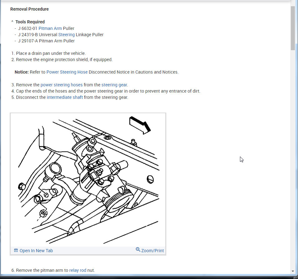

My SUV's steering wheel got hard to turn to the left so they told me it was the pump. so we changed it and no improvement. Then they told us it was the gear box, so we changed it. but now the steering wheel is hard to turn both sides. please help me. Thanks
Jan 18, 2018 at 9:00 AM

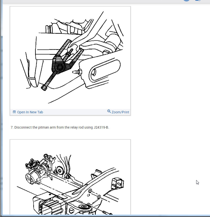

Couple things that we need to start with. First here is a guide that will help with these issues:
https://www.2carpros.com/articles/power-steering-problems

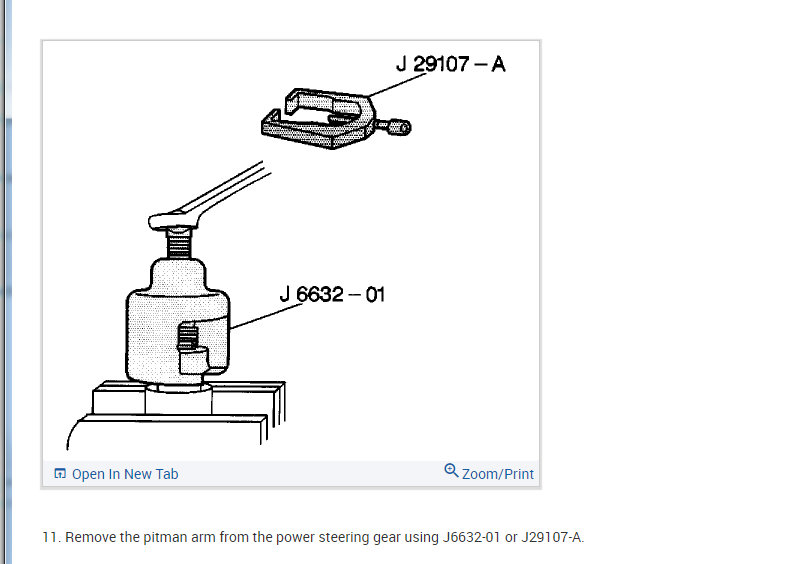

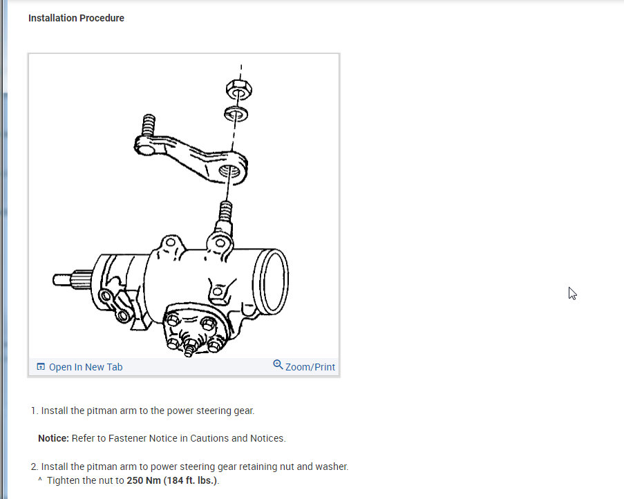

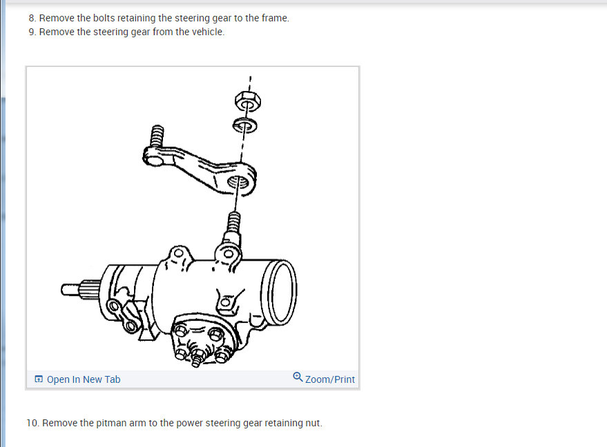

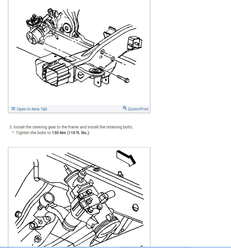

Next we need to find out what parts you replaced the gear and pump with. I suspect the fact that after you did the pump and there was no change and after the hear it was both sides that were hard, that you got a faulty gear. This why I am suspect that you replaced it with a used part. if this is the case then we need to return that gear and replace it again.
Here is the process just in case you need it. Thanks

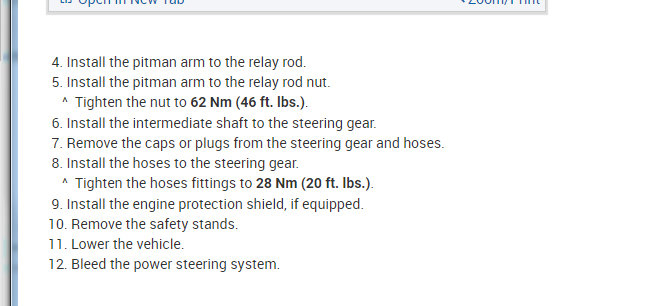

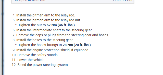

Good evening,

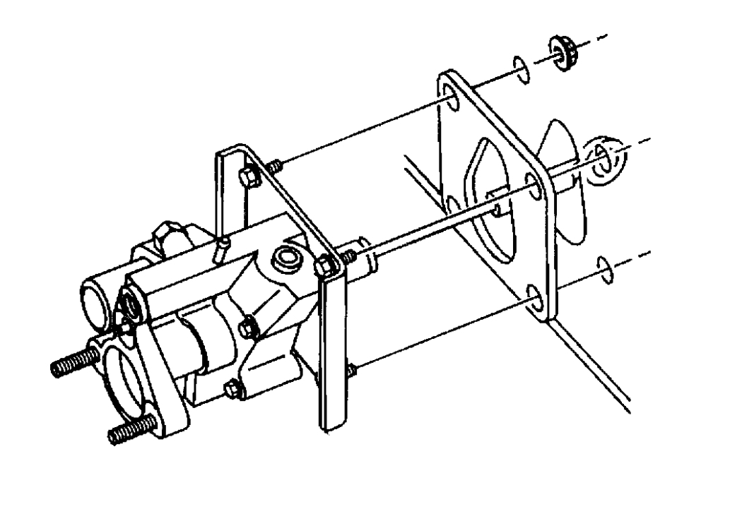

Do you have a hydroboost system on the master cylinder? That would be in place of a vacuum unit for brake assist.
If you do, there was a recall for this exact issue due to that unit having an internal failure not allowing fluid flow to the steering box.
DEFECT: Certain sport utility vehicles, pickup trucks, and passenger vans fail to comply with the requirements of Federal Motor Vehicle Safety Standard No. 135, "Passenger Car Brake Systems." Some of these vehicles were produced with an out-of-specification brake hydro-boost housing relief valve bore. Consequently, the valve O-ring seal may fracture. Steering efforts may be slightly increased while braking or parking. Under certain driving conditions, a fractured seal may also require an increase in the applied brake pedal effort to achieve the same vehicle deceleration.
REMEDY: Dealers are to replace the hydro-boost relief valve. The manufacturer has reported that owner notification is expected to begin during the second quarter of 2004. Owners may contact Cadillac at 1-866-982-2339; Chevrolet at 1-800-630-2438; GMC at 1-866-996-9463; or Hummer at 1-866-486-6376.
Hydraulic Brake Booster Replacement

Removal Procedure
1. Apply the park brake and block the wheels.
2. Disconnect the inlet hose, the steering gear. and the return hoses from the booster assembly
3. Remove the master cylinder. Refer to Master Cylinder Replacement.
4. Remove the stop lamp switch Refer to Stop Lamp Switch Replacement in Lighting Systems.
5. Remove the 4 booster to bulkhead nuts.
6. Remove the booster assembly.
7. Remove the gasket.
