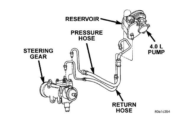

It has a brand new power steering pump put on. All fluids are full as they should be. We are still having power steering issues. If it's not the pump itself causing the problems then its the thingamajig that's connected to it. but i'm not exactly sure what it is called. Can you help please?

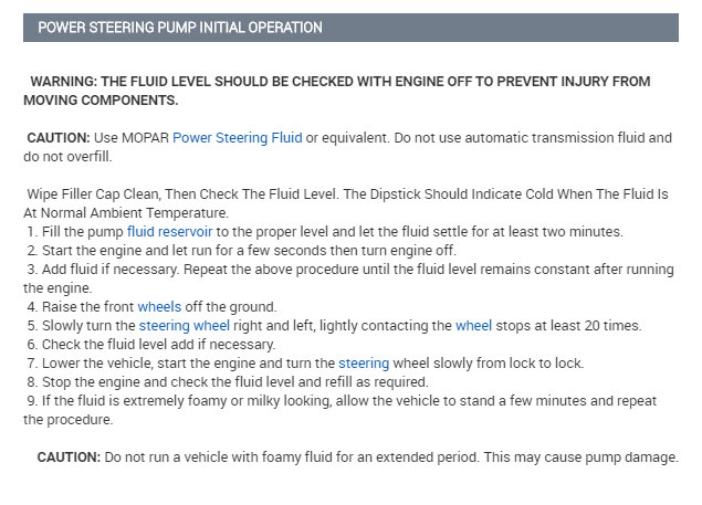

Did you bleed the system after replacing the power steering pump?
You need to fill the reservoir, start the vehicle and whilst you get someone to turn the steering from lock to lock top up the fluid. By lock to lock i mean from the left end stop all the way to the right end stop. You keep turning the wheel back and forth to the end stops to bleed the air out of the system.

The power steering system comprises of a reservoir, pump and power steering rack. Hydraulic lines connect these components.

I'm pretty sure what you are looking for is the steering gear. I'm attaching the power steering system diagram and repair guide below. let us know if this is helpful and if you need more info.
https://www.2carpros.com/articles/power-steering-problems
Thank you
Joe T.

Did you perform the initial operation procedure? Meaning did you get the air out of the system when you put the pump on it? I attached the procedure. Just make sure you lift the wheels off the ground when doing it as it says or you will damage something due to the excess load on the system.
If this is not the issue, what exactly is the system doing? Maybe get a video of the issue and that could help if it is difficult to explain. Thanks

No it was not bled out afterwards.
