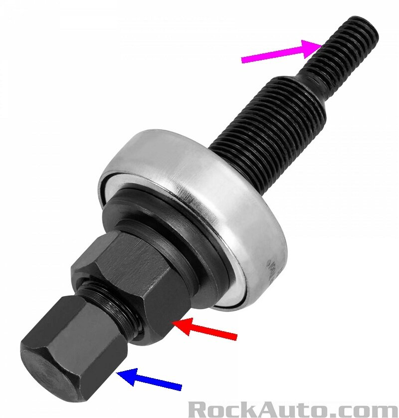

This first photo shows just an installer. The narrow threaded end, (pink arrow) gets threaded into the pump's shaft. You hold the end, (blue arrow) with one wrench, then turn the pressing bearing assembly with another wrench, (red arrow). As shown, this setup will allow you to press the pulley all the way on until the end of the pulley's hub is flush with the end of the pump's shaft. For your application, this is too far.

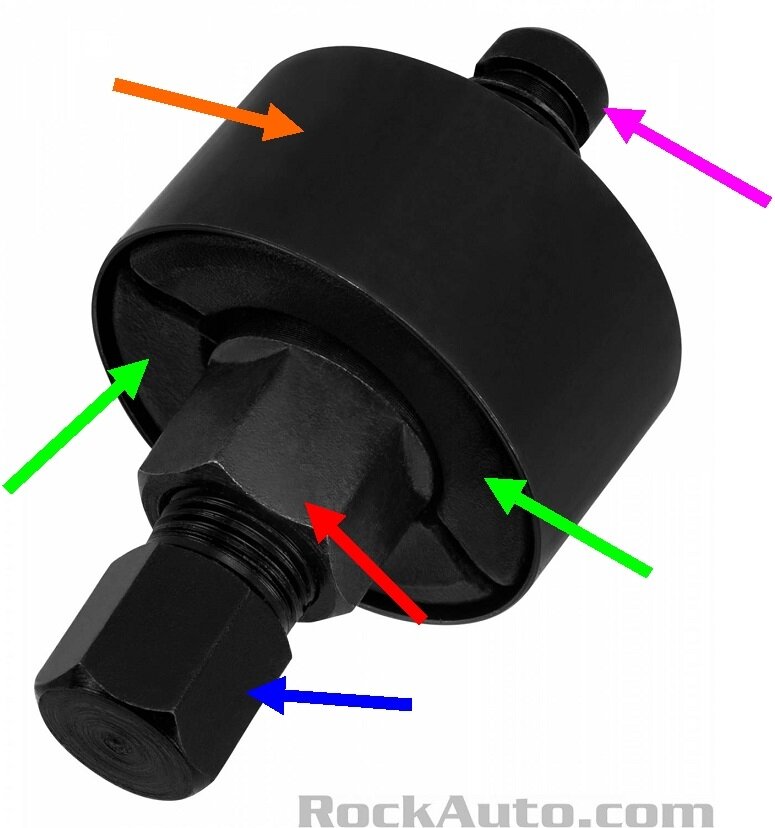

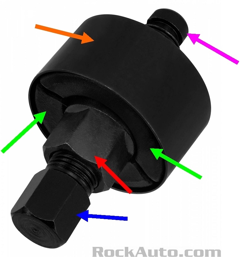

One version of the pulling tool is shown in the second photo. This becomes much easier to understand when you have the pieces in your hand to look at. There's two pieces, (green arrows) that go around the hub of this tool and the lip on the front of the pulley's hub. The collar, (orange arrow), is just a short piece of pipe that holds those two pieces from falling off. They're showing the shaft of this tool already run in most of the way as it would look right after pulling the pulley off. We start with that screw backed off most of the way. The button on the end, (pink arrow), pushes on the pump's shaft. You hold the tool, like with the first tool, with a wrench on the end, (blue arrow), and turn the pulling assembly, (red arrow), with another wrench. The easiest way to visualize this is the two segments, (green arrows), hold the hub of the pulley, then when the threaded screw, (blue arrow) is run in, the button, (pink arrow), pushes the pump's shaft out of the pulley.
This same tool is used to reinstall the pulley. The collar and segments, (green and orange arrows), are set aside and not used. The button, (pink arrow), is pulled out and set aside too. It's held in with a rubber o-ring. A double-ended threaded stud is screwed into the end where the button was removed. There's multiple studs in the kits. Use the one that fits the threaded hole in the pump's shaft. Now it will look like the tool in the first photo. As you turn the bearing assembly, the threaded stud will pull the pump's shaft into the pulley's hub. The spacer needed for your application is slid onto the fatter threaded part of the tool, right under the silver bearing assembly. That spacer will contact the end of the pump's shaft just when the correct depth is reached, and it will prevent you from pressing the pulley on too far.

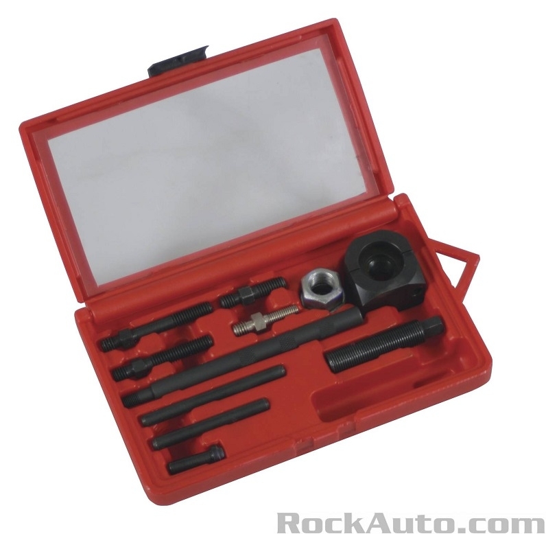

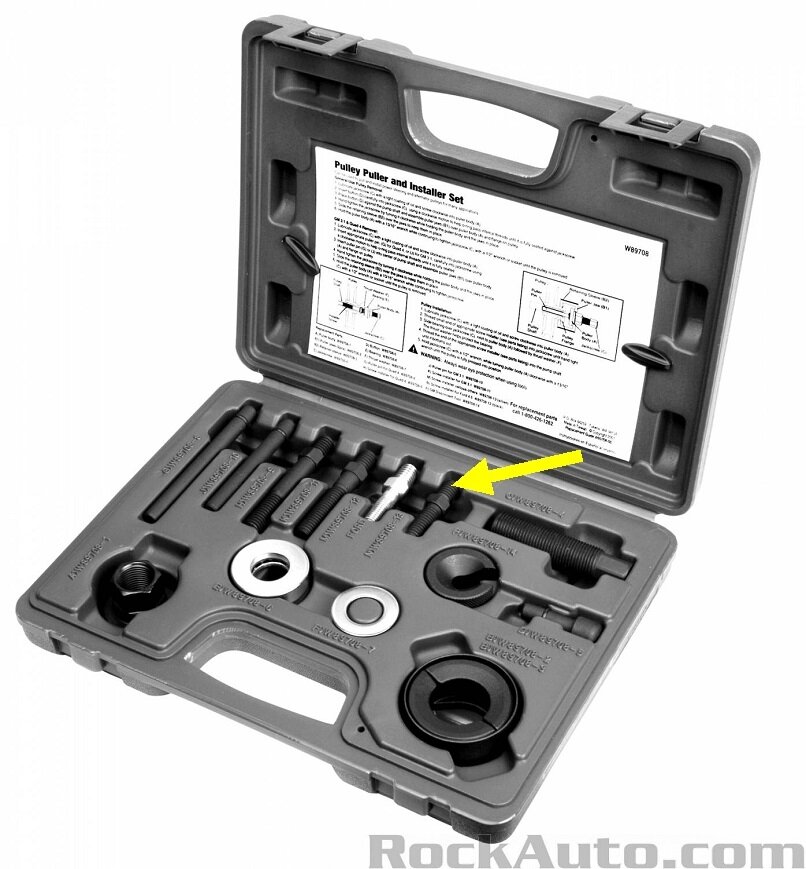

The third photo shows the entire kit. The yellow arrow is pointing to one of those double-ended studs. The silver washers are those spacers needed for your application. The fourth photo just shows another version of this kit. You can usually find this tool kit at an auto parts store that rents or borrows tools. In my city, they make you buy the tool, then you get a full refund when you return it. If you choose to keep a tool, you still return it then they give or order you a brand new one.
