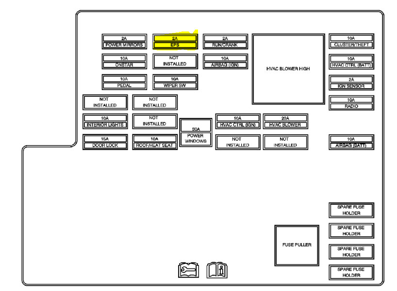

It doesn't work but how do I check the power steering fuse for it under the hood?
Jan 31, 2023 at 3:46 PM
  • 110,194 POSTS

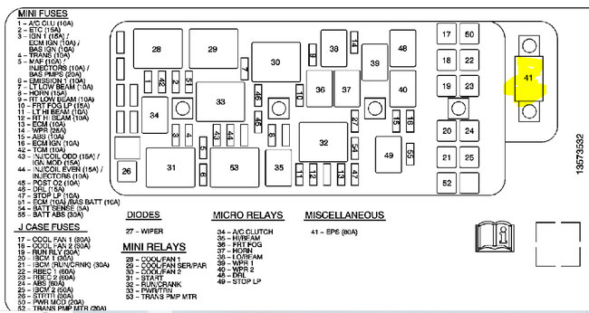

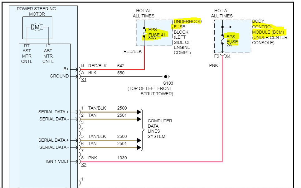

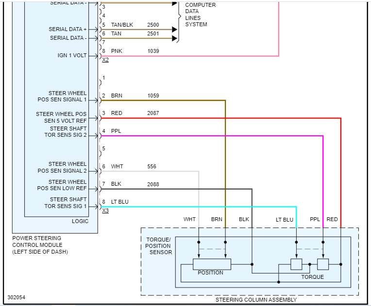

There are two fuses to check. Both supply power to the P/S control module.
I attached the wiring schematic below, so you have a reference. See pics 1 and 2.
Pics 3 and 4 are the fuse boxes. Pic 3 is the under-hood fuse box. Pic 4 is in the vehicle.
When you check the fuse, it is also important that you confirm there is power to it.
Here is a link that explains how to check:
Let me know if this helps.
