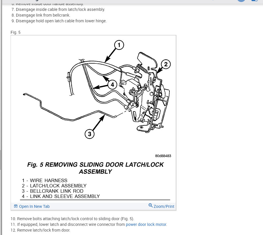

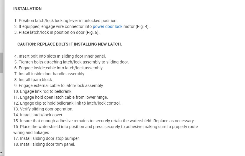

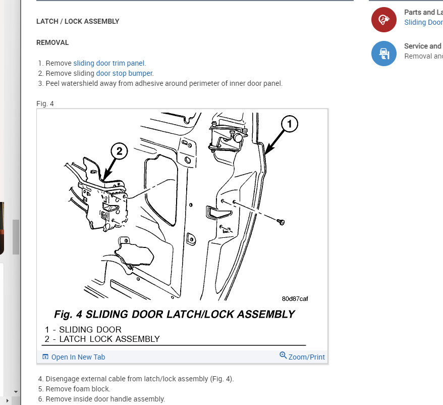

The actuator was bad, but now i have a problem with the linkage rod. Something has come loose or broken i can't find any diagrams or anything to show how it goes back on. Hope you can help me again. Thanks, KIm
Apr 16, 2022 at 8:29 PM
Sure can. I am assuming this is the linkage attached to the latch that is shown in the image.
If not, then can you get a picture of what you are dealing with? Thanks
