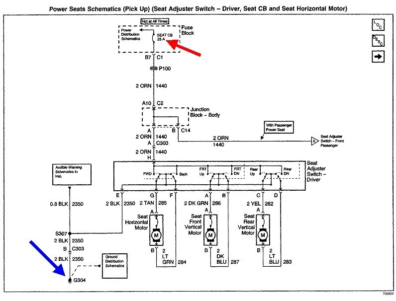

My driver and passenger seat aren't working. I can't recline or move forward or backwards. Please help!
Jan 4, 2021 at 6:13 AM
CARADIODOC
  • 34,369 POSTS

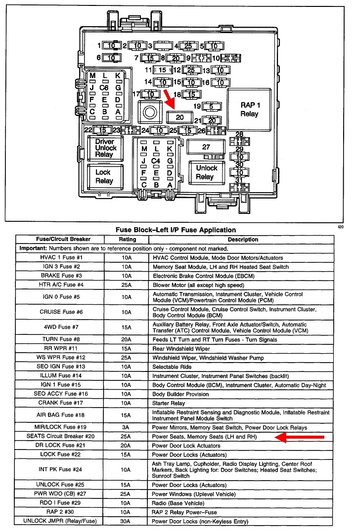

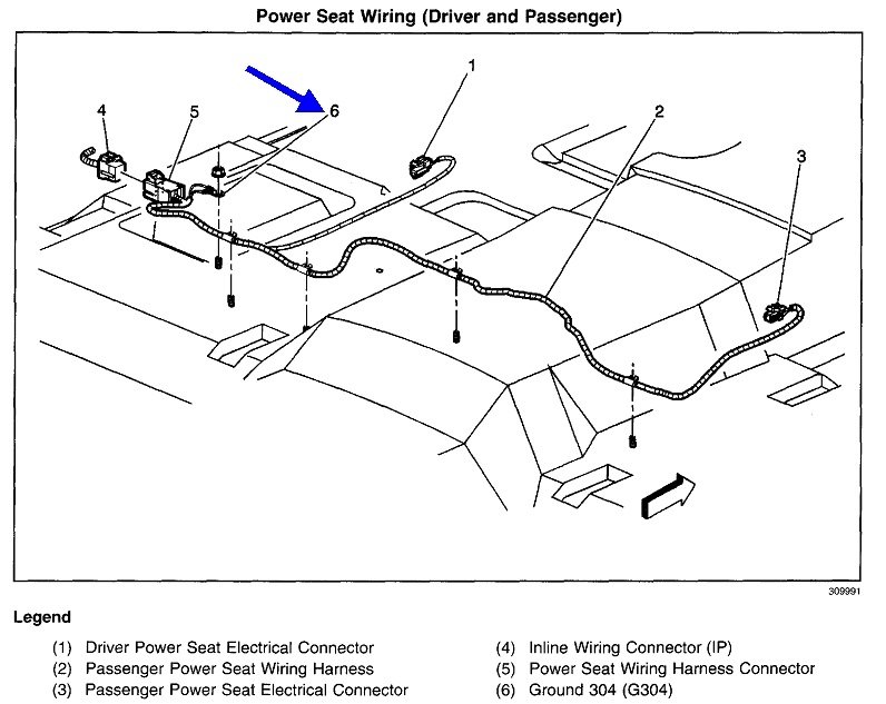

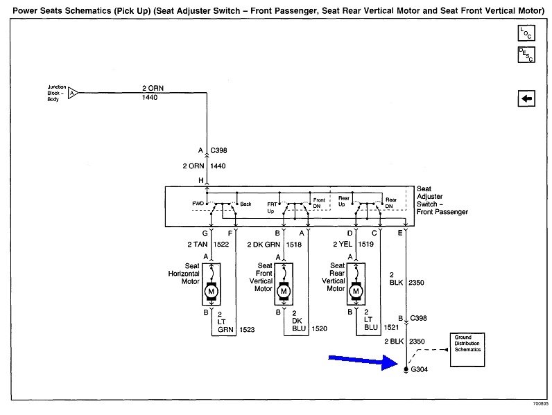

Since both sides aren't working, we have to look at what they both have in common. That includes the 25-amp circuit breaker, and ground G304.
Start by checking for 12 volts on the orange wire at either switch assembly. If it's there, the best suspect is a corroded ground wire or terminal at G304. If the 12volts is missing, swap in a different circuit breaker as a first step. Let me know what you find.
