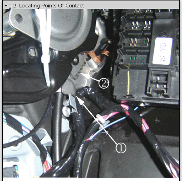

if this vehicle has had the air bag deployed then the seat module must be reprogrammed because there is a code stuck in memory. check around parking brake where harnesses are and see if any are chafed or cut that may be a problem. finally scan for codes as it may show a code. Here is a guide to help us with the CAN scan
https://youtu.be/InIlnsjOVFA
Check out the diagrams (Below). Please let us know what you find. We are interested to see what it is.

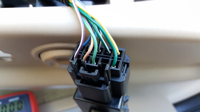

Just checking, did you get the picture I attached of the power seat plug showing the wire colors? Just want to make sure I'm working in the right spot..
Sep 3, 2019 at 11:25 AM (Merged)
TOMMII
The motor does not run. Reading the manaul the dsm fuse operates the seat and remote start. The remote start still works but I will check the fuse
CARADIODOC
  • 34,366 POSTS
I see eight wires in it, which is correct. Check where the wires go to. The wires must go to the three motors under the seat. There is another version that is for heated / climate-controlled seats. I don't know how many wires are in that plug.

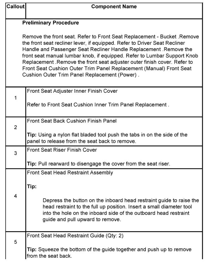

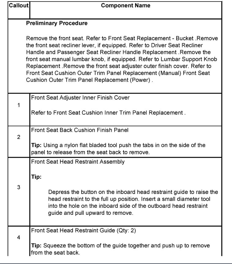

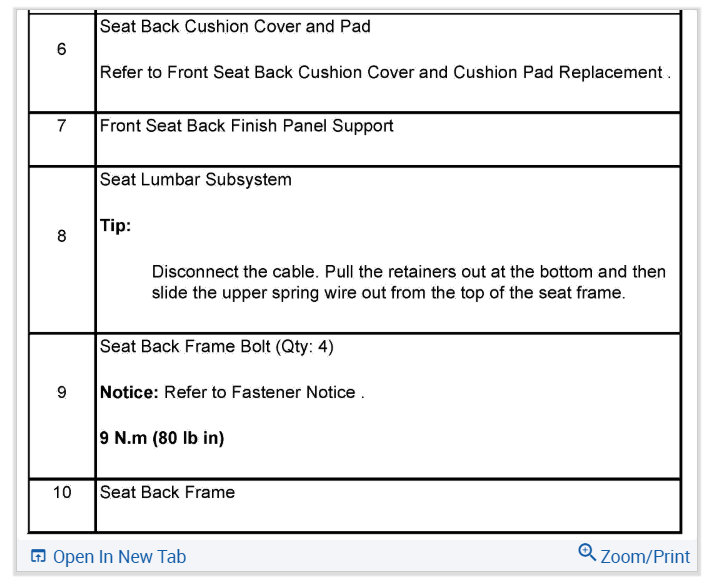

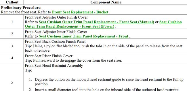

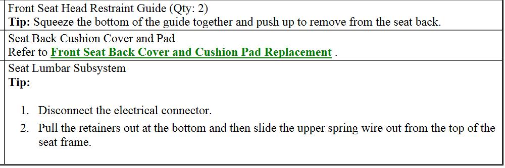

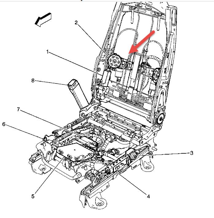

NCYUKONXL
It seems every other function of seat works. When trying to apply more or less lumbar, nothing happens and lumbar just makes a motor working sound. It will move up and down but just not inflate.
Any ideas? How hard of a fix? Are there airbags in the seat which make it tricky to work on? It's a new truck for me.
HMAC300
  • 48,601 POSTS
either get a manual or rent one on site here for a week so you can print the instructions out probably time consuming mostly......

CRHENKEL
I have similar 2007 Yukon Denali driver's seat lumbar failure problem. where can I get this repair manual you mentioned. I would like to rent one for a while to research my seat failure issue.
CARADIODOC
  • 34,366 POSTS
You should be able to pop the switch apart, then expect to find the switches soldered to some type of circuit board. Look at the terminal that corresponds to the black / white wire and see if it is loose where it is soldered or crimped to the board.
Even easier, find a switch at a salvage yard and plug it in to try it.
  • 55,224 POSTS
Here is the repair manual, I found more info in the diagrams below.
https://www.2carpros.com/manuals/manuals.php
