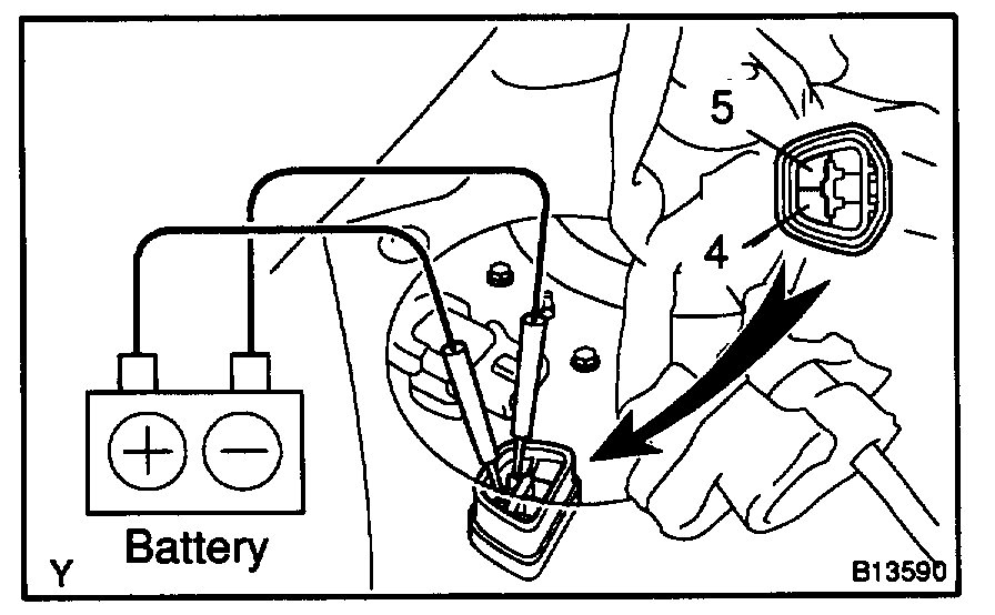

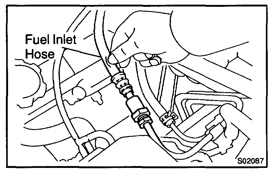

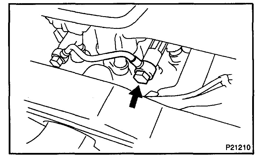

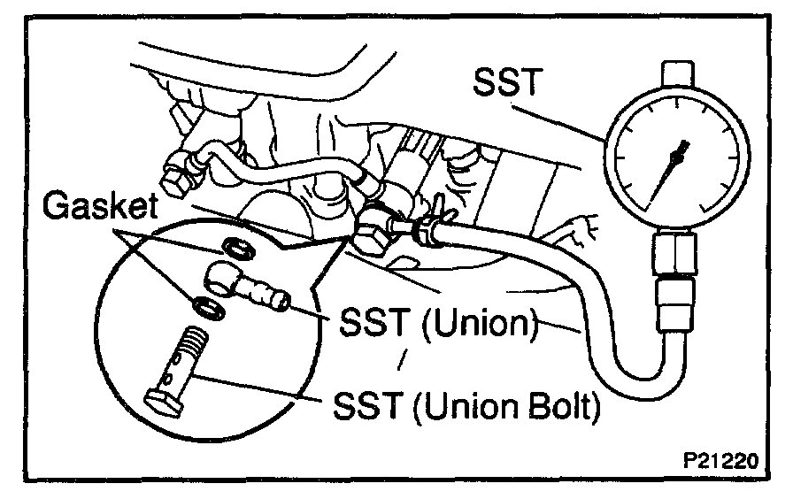

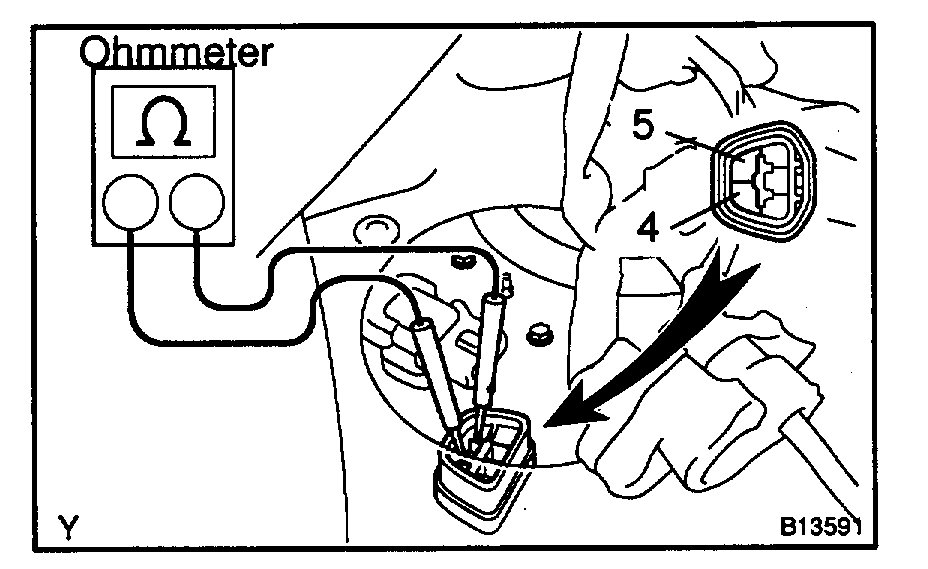

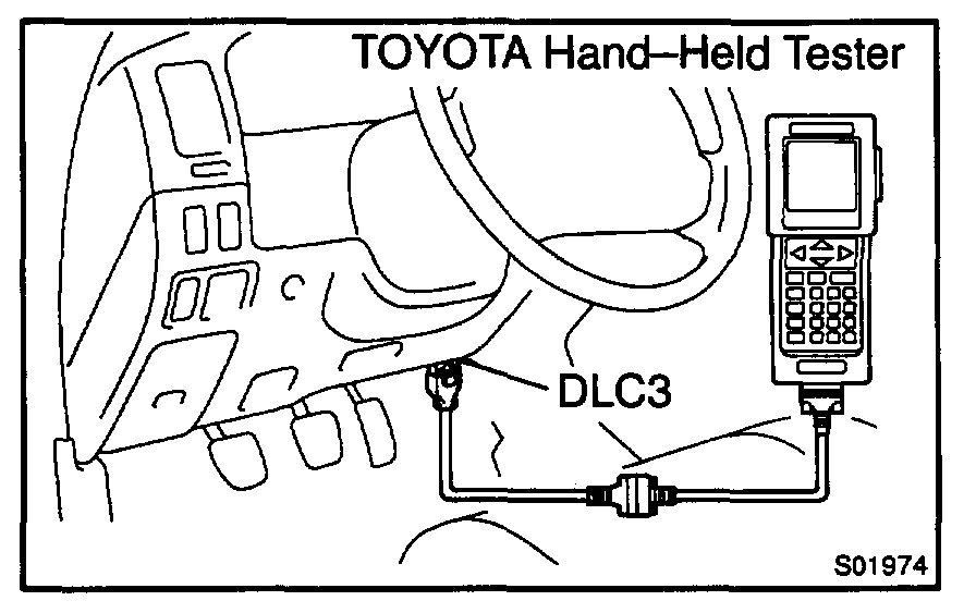

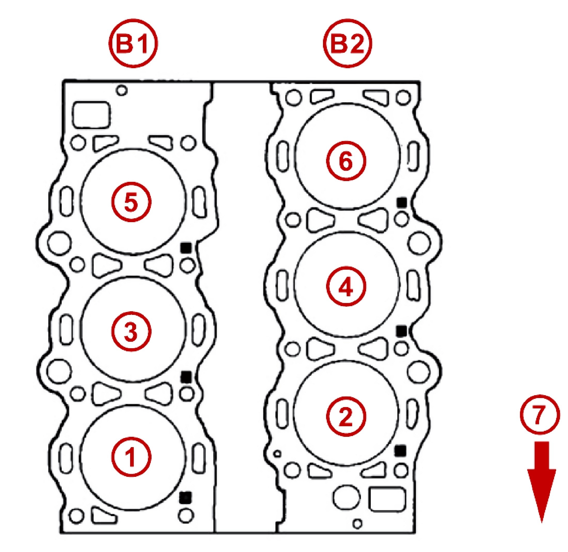

No power, shuts off while idling, backfiring, bogs down while driving. Have replaced mass airflow sensor, all three coil packs, TPS and now all it does is crank with a lot of sputtering but does not start. What else could it be?
Sep 10, 2018 at 9:00 PM
  • 110,248 POSTS
First, are you sure you got the plug wires back on correctly? I attached pictures of the firing order for you to review. (pictures 1 and 2)
If you are sure that is good, then I would suggest checking fuel pump pressure. Here are general directions for that process. Keep in mind, low/high fuel pressure can cause the symptoms you described.
Here are the directions specific to your vehicle for testing fuel pump pressure. The remaining pictures correlate with these directions.

a. Connect a TOYOTA hand-held tester to the DLC3.
b. Turn the ignition switch ON and push TOYOTA hand-held tester main switch ON.
NOTE: Do not start the engine.
c. Select the ACTIVE TEST mode on the TOYOTA hand-held tester.
d. Please refer to the TOYOTA hand-held tester operator's manual for further details.

f. Check that there is pressure in the fuel inlet hose from the fuel filter.
HINT: If there is fuel pressure, you will hear the sound of fuel flowing. If there is no pressure, check the H-fuse, M-fuses, fuses, EFI main relay, circuit opening relay, fuel pump, ECM and wiring connections.

d. Remove the union bolt holding the fuel pipe to the delivery pipe and gasket.

e. Install SST (pressure gauge) to the delivery pipe with the 2 gaskets and SST (union and union bolt).
SST 09268-45014
Torque: 34.3 N.m (350 kgf.cm, 25 ft.lbf)
f. Wipe off any splattered gasoline.
g. Connect a TOYOTA hand-held tester to the DLC3 (See step 1).
h. Reconnect the negative (-) terminal cable to the battery.
i. Turn the ignition switch ON.
j. Measure the fuel pressure.
Fuel pressure: 265 - 304 kPa (2.7 - 3.1 kgf/sq.cm, 38 - 44 psi)
If pressure is high, replace the fuel pressure regulator. If pressure is low, check the fuel hoses, fuel hose connections, fuel pump, fuel filter, fuel pressure regulator and VSV for the fuel pressure control.

3. INSPECT FUEL PUMP RESISTANCE
a. Pull up the LH rear seat cushion.
b. Remove the floor service hole cover with the 3 screws.
c. Disconnect the fuel pump connector.
d. Using an ohmmeter, measure the resistance between terminals 4 and 5.
Resistance: 0.2 - 0.3 ohms at 20 °C (68 °F)
If the resistance is not specified, replace the fuel pump and/or set plate.
4. INSPECT FUEL PUMP OPERATION
a. Connect the positive (+) lead from the battery to terminal 4 of the connector, and the negative (-) lead to terminal
5. Check that the fuel pump operations.
NOTE:
- These tests must be done quickly (within 10 seconds) to prevent the coil from burning out.
- Keep the fuel pump as far away from the battery as possible.
- Always do switching at the battery side.
If operation is as not specified, replace the fuel pump and/or set plate.
